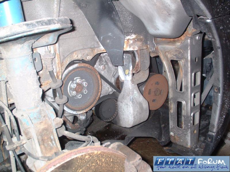

Lets start off with the obvious ones. Apply the handbrake tightly, chock a rear wheel, jack up the car and remove the driver’s side roadwheel. Support the car securely on axle stands. Under the wheel arch, remove the two parts of splash shield under the wing – one with the grille on behind the fog lamp and another covering the drive belts. You should be faced with a view a little like this:
Those 6 little bolts surrounding the big one on the crank pulley are Torx ones, you’ll need a TX45 bit to loosen them. Undo them one at a time, don’t remove yet, and put them back in finger tight. Then, turn the crank using a 19mm spanner or socket on the big bolt in the middle until the nick in the pulley and the notch on the timing belt cover line up – you can’t miss it, it’s just off the vertical position. Now you may remove them along with the pulley – it won’t turn the crank this way if they’re already loose.

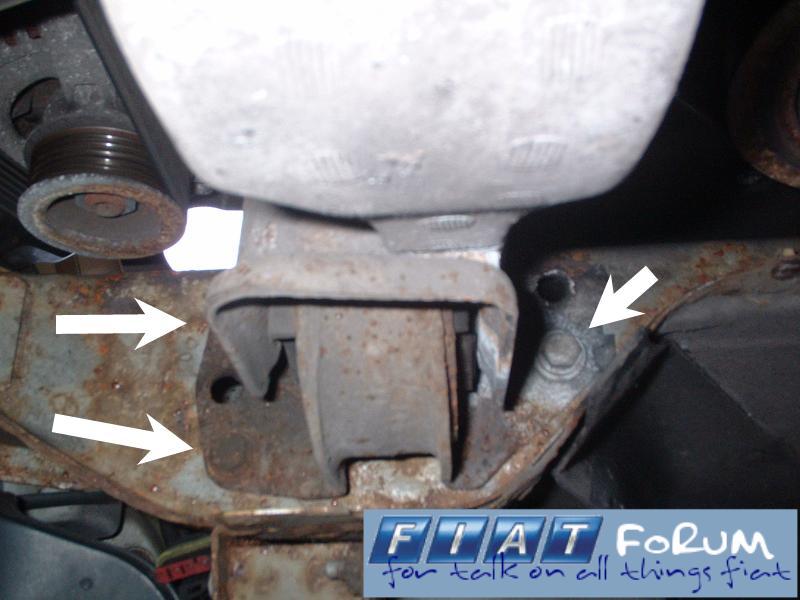

Now, put the jack under the sump and support the weight of the engine. You may need to lift it ½” or so, as you need to remove the bolts from the engine mount in the middle of that picture. Three go up into the wing, and one goes through from front to rear.
View of mount from below. Remove the three bolts arrowed, making sure the engine isn’t going to drop on your head, ideally. Remove the through bolt too as this will allow for more engine movement later. Manipulate the mount, if you can remove it completely then all the better – if not then just jiggle it as you go depending on whether you’re raising or lowering.

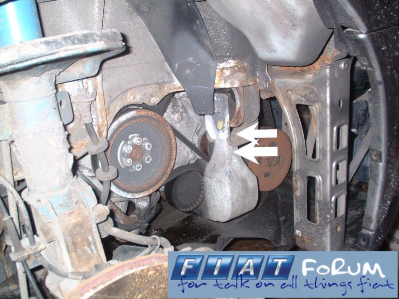

PAS belt next – the tensioner for this is held on by 2x 13mm bolts which are hidden behind the engine mount. Easy enough to get at though, they are roughly where the arrows point (but behind the mount, obviously………)
The PAS belt is tensioned by turning it with a 17mm spanner, it has a bolt in the centre to allow you to do this. Fit the new belt and tension appropriately.
