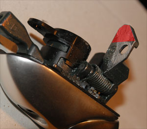

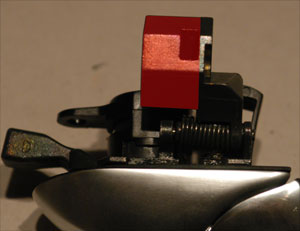

- There's a big chunky bit on the alfa handle's mechanism that isn't there on the fiat's:
Take a hacksaw to it to make it slimmer like this:
I also cut off the section shaded here, as it was knocking against the window runner inside the door, and not closing fully when you released the handle
Be really careful with the plastic lever on the back of the lock. If it breaks you'll have a working handle, but no working lock on that side of your car.
