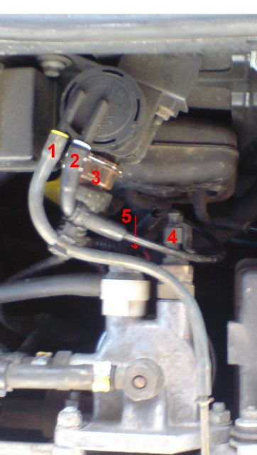

Pipes and Wires
You now need to remove the pipes and wires blocking access to the fuel filter. Make sure you record which wire and pipe goes where.
The 2 wires connecting to the fuel heater housing are simple cliped connectors. The orange connector requires the metal clip to be removed. A pair of long nose pliers is ideal. The two pipes marked simply slide off.
