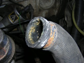

Undo hose clip to release housing (now easier to get at). Check for deposits inside end of hose (photo1) and around lip of housing which causes pitting - also check for cracks and/or brittleness in hose.
