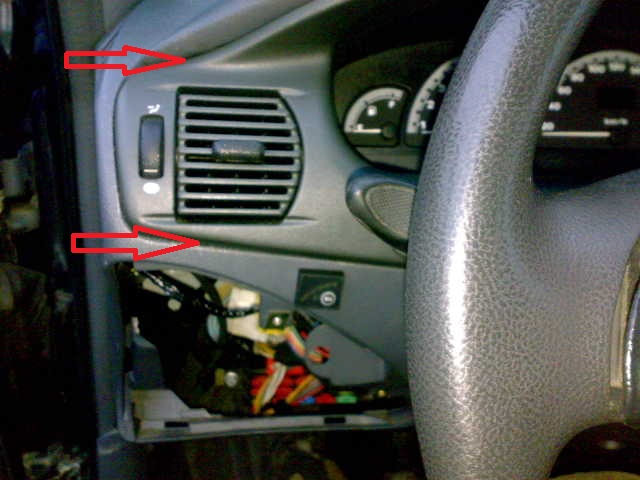

The first step is to lower the wheel drive to it's lowest point, then open up the fuse box cover (this being a left drive it's on the left of the steering wheel):

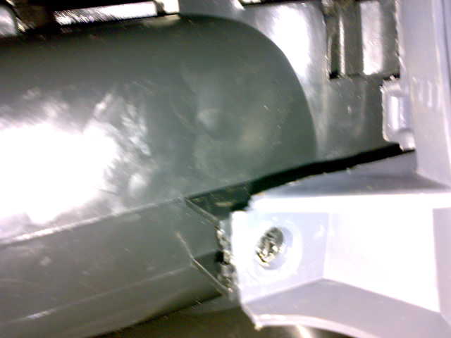

Second step is to unscrew with the cross screwdriver the screw located inside the fuse box compartment:

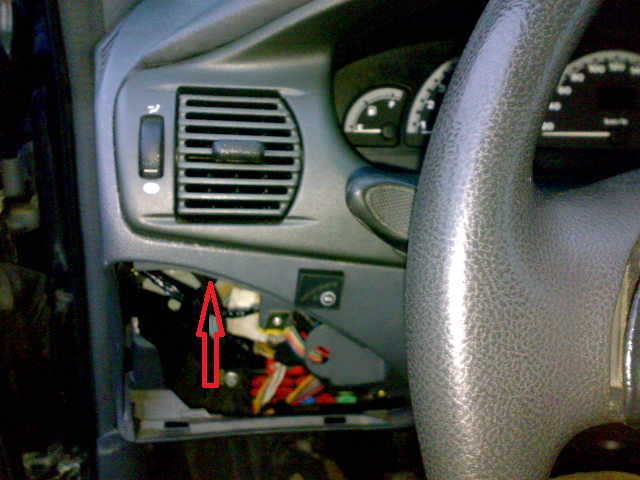

Third step is to unscrew with the allen key the 5 screws shiwn in the picture (it's not my dash sorry i forgot to make a picture):

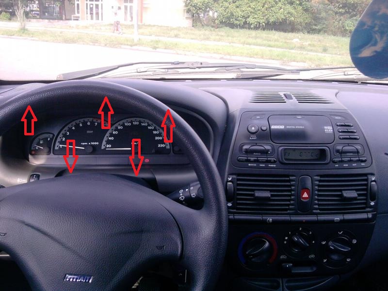

Fourth step is to take out the dash trim out, using a inline screwdriver gently push between the upper dash and the trim, pulling at the same time the trim towards you, until it pops out:

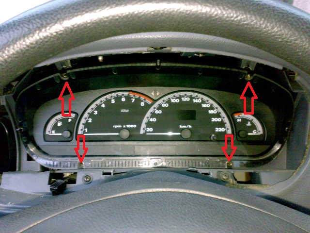

Fifth step is to remove the four allen screws holding the gauges in place:
then pull sideways the gauges and disconnect the two connectors:
