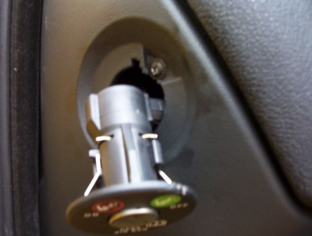

Removing air bag switch
You then need to take out the panel where the passager air bag switch is located - Pop the switch out,disconect it then remove the screw behind it.
Removing the panel
