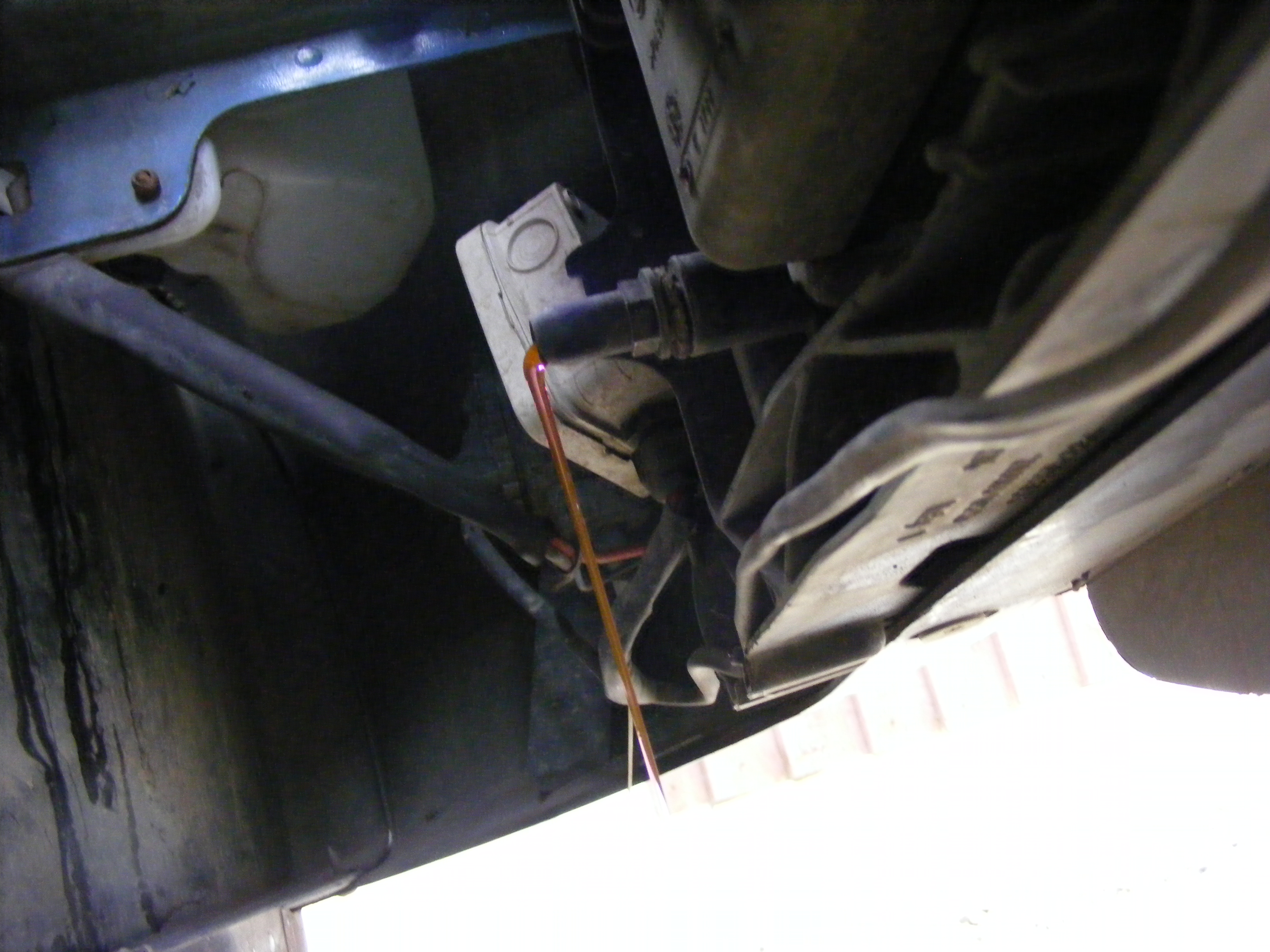

now on the radiator itself look on the back passenger side and locate the drain point and using a 13 mm ring ended spanner (its plastic) loosen it so the coolant drains into your drip pan
whilst this slowly drains

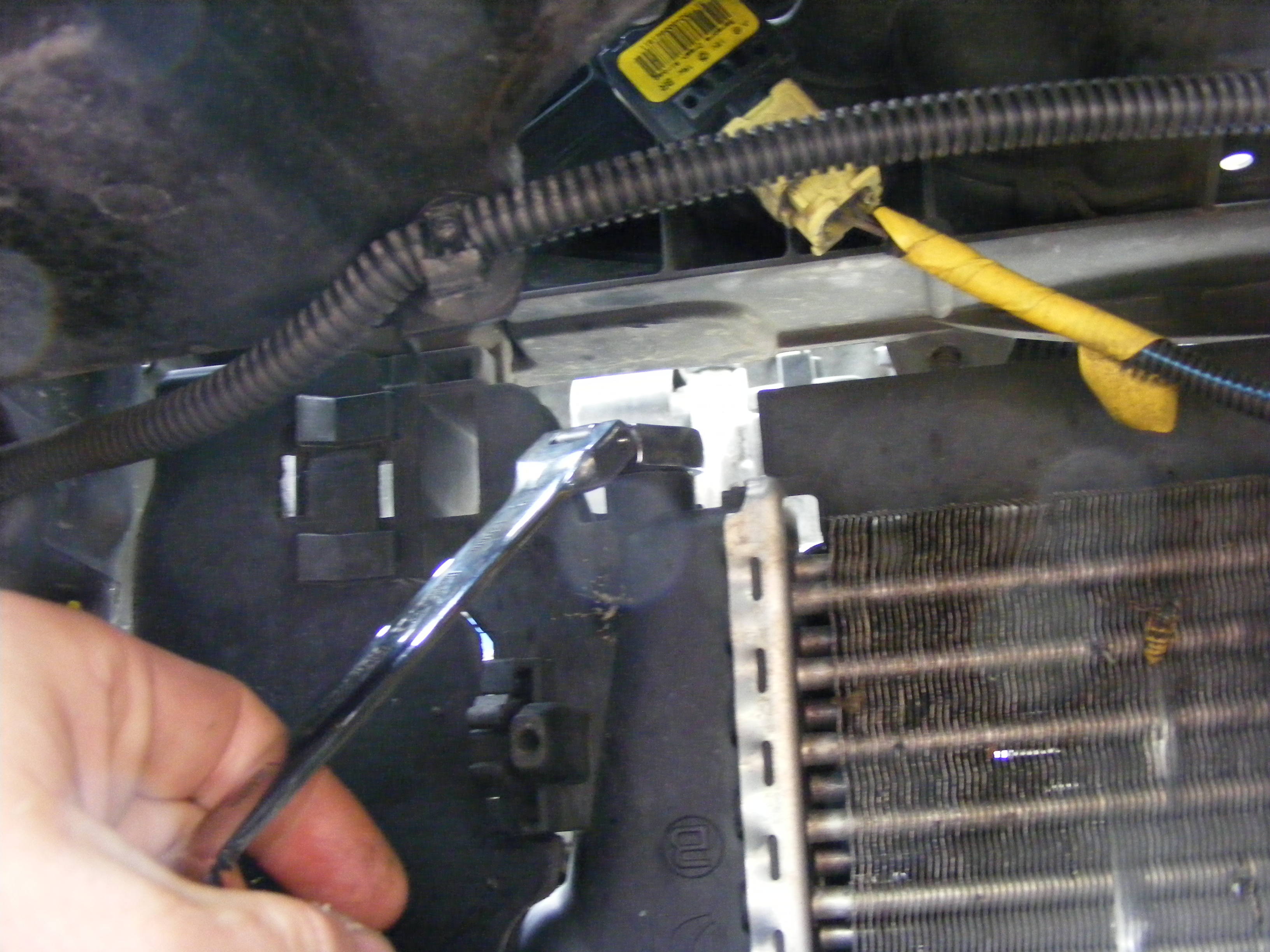

you can now locate the bleed screw on the top right of the radiator you can get to it from the engine compartment but life is much easier to remove the top grill and you can get at it much easier....
Take care not to damage or disturb the yellow coated air bag crash sensor cable
undo it 5-10 turns you dont need to fully remove it
this again is plastic and i had trouble removing mine using a 13mm ring spanner and there is not enough space to get a 6 sided socket on, it is however removable with a screw driver (great or it would be if you could get a screw driver onto it but the front slam panel covers it..... well done Fiat :worship so this is where your bit of hacksaw blade comes in with the grill out put it across the + on the top and use downward pressure and turn at the same time to loosen it once its loose i was able to go back to my 13mm spanner but i did not want to round it off or damage it.......
