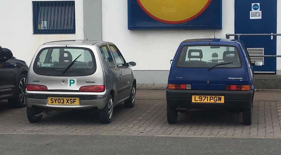

There are two 126s in Orkney, my watercooled and an aircooled on one of the smaller isles. Now there are two 'centos, the other is a Seicento which always parks in the same spot at Tesco. One day I decided to roll up next to it for comparison...

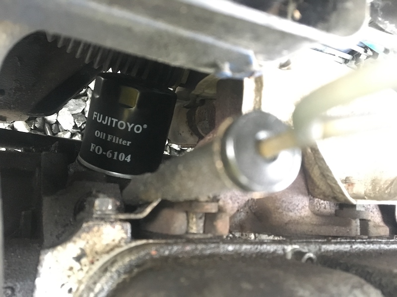

an oil change (I'm glad I checked the oil shortly after buying the car before the long trip... it was too low, and presumably the wrong grade as the previous owner had left an empty 1L bottle in the boot)

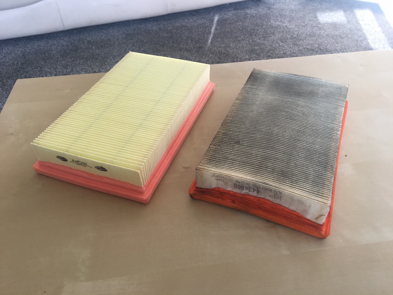

air filter change, before and after

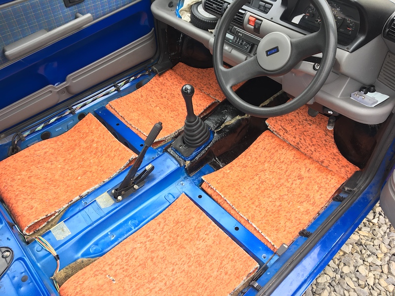

The most concerning problem was a slushing liquid noise when I engaged first gear and drove off. I removed the seats and carpet to find the driver's side underlays completely soaked with water.

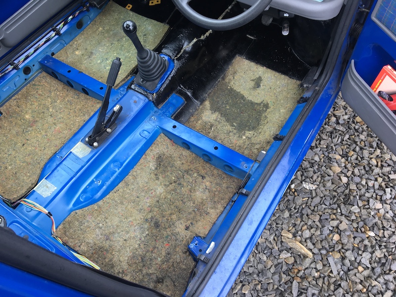

Dried it out and tried finding the source, to no avail. So for a couple of days I drove about with no carpet to see. Nothing. With the underlay dry, I put it back in, put the carpet back on and drove about for another few days. The theory being that once it rained I'd check the underlay again and see where it was coming from. The plan kinda worked, this is what I saw:
it looked like it came from the centre. But the centre underlay (thick black bits) were dry and looking under them I could see no way of it coming from there. I figured it was a red herring and that it only looked like that because perhaps my foot pressed the underlay into the puddle when I stepped into the car?
After researching leaks on this forum I removed everything again and decided to investigate the sunroof gutters. I'm quite surprised by the design, why don't the pipes coming from the sunroof go out of the car, rather than drain water into the sills? Is that asking for the sills to rust!
I couldn't remove the sunroof pane, so carefully poured water whilst the car was parked on a slope. All the pipes were fine, however the drain hole on the driver's side front was sealed... presumably by the car being hoisted there by a jack or a garage's lifting equipment.
Had to take a small screwdriver and mallet to it, hammering the screwdriver upwards into the drain hole to recreate the hole. Eventually I got the water to flow sufficiently at a rate not quite as fast as the other side, but fast enough that subsequent tests (and driving since) have proved it fine.

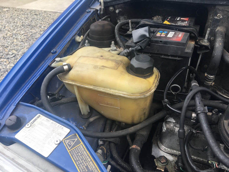

Finally I flushed the coolant which was very dirty. The expansion tank was filthy and yellowed, you couldn't see the level. After a good flush I refilled it and then when I flushed the system again the next lot of coolant came out 95% clean.
A few weeks later Tesco had Prestone coolant on clearance so I flushed it again, 97% clean.
Today I flushed it a final time, since I was replacing the expansion tank with a new one. When I flushed it this time it was pretty much clean despite the tank still being filthy.
The new tank isn't that see-through, but you can now just-about see the coolant level which is better than nothing. Plus it's clean. Here's a before and after:
