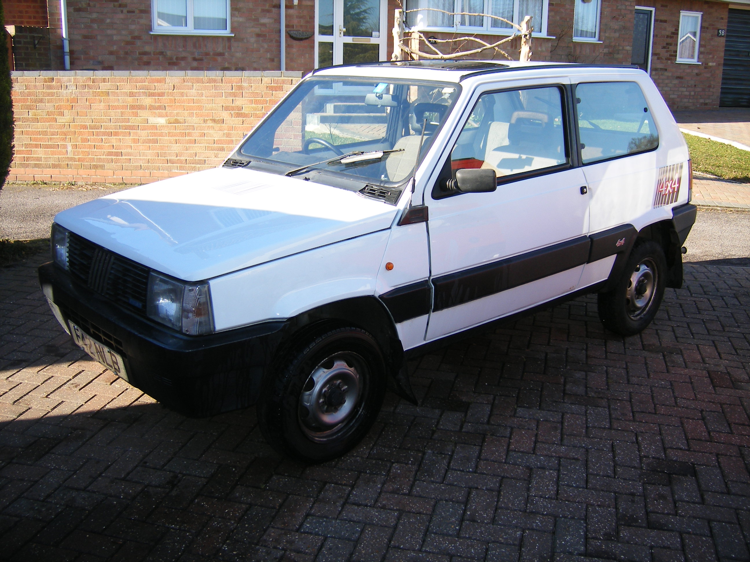

This was it when I first took ownership about 18 months ago. It had just come out of a five year period of storage and had no tax or mot, 54,000miles on the clock, but did look to be in pretty good condition.

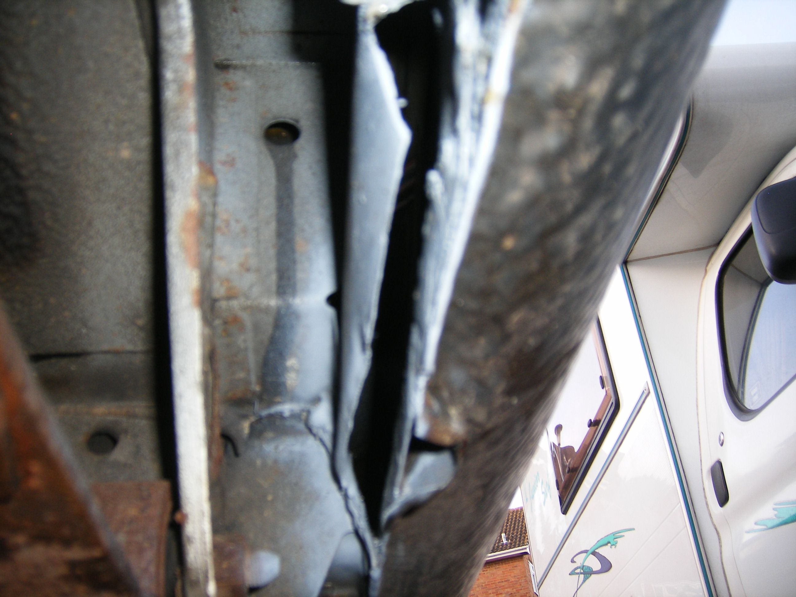

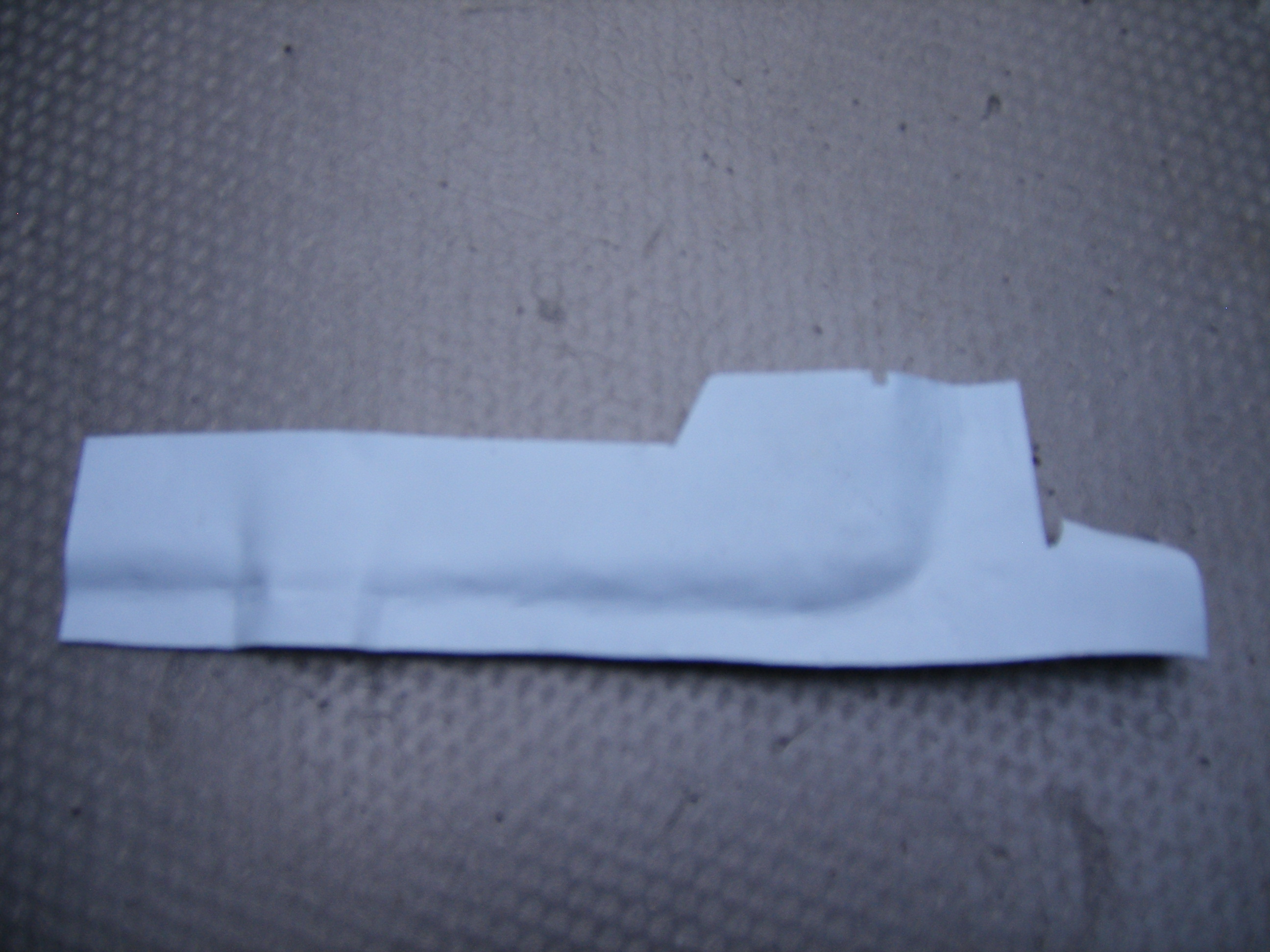

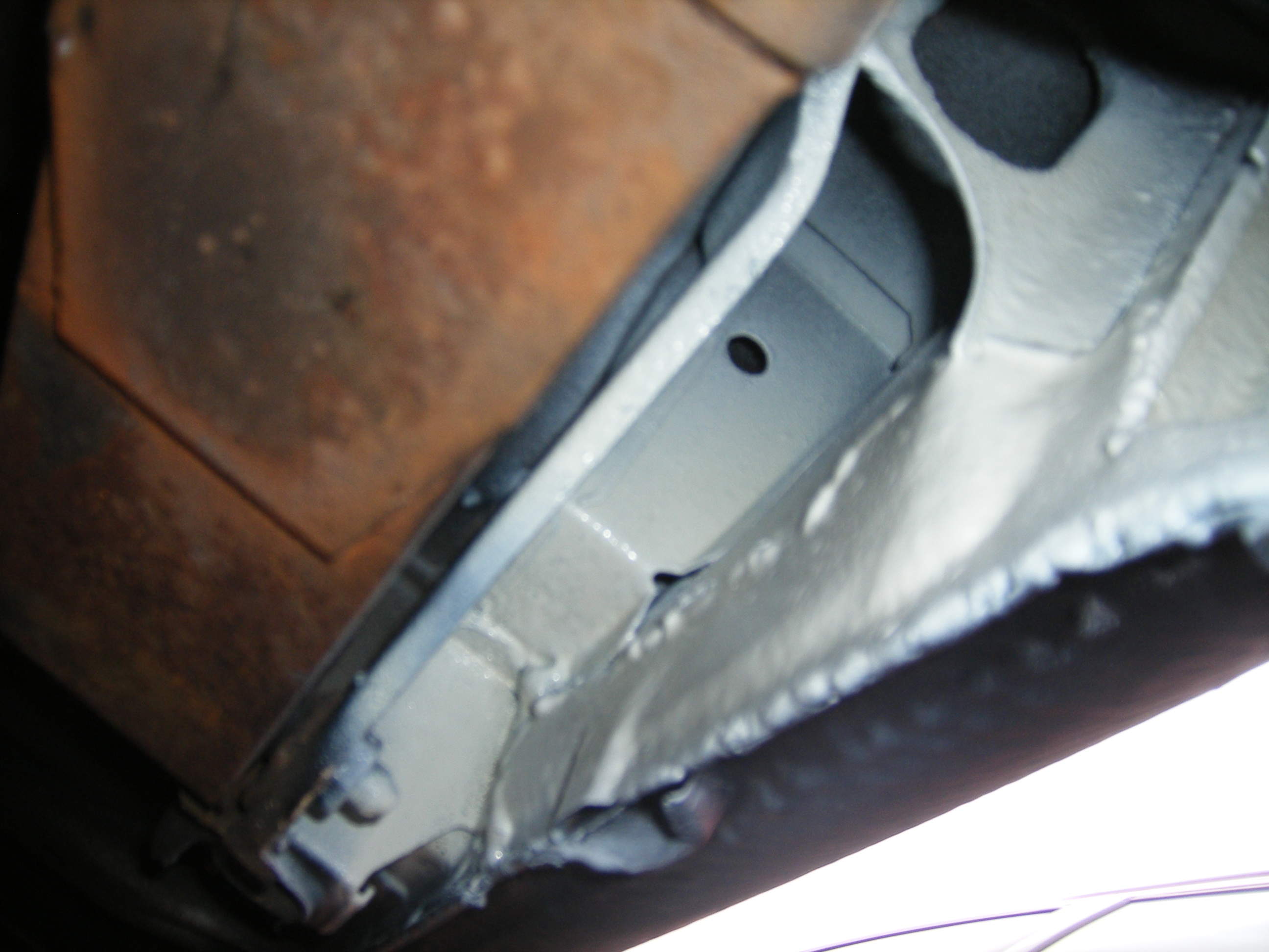

After closer inspection at home I found it to be really really good :). only one area of rust thanks to it being thoroughly waxed from new. This was the usual area at the back of the sill, only the o/s though, the n/s was fine. This had to be repaired for the mot but I can't remember much being needed.........
I soon had it all polished up and fitted some alloys........

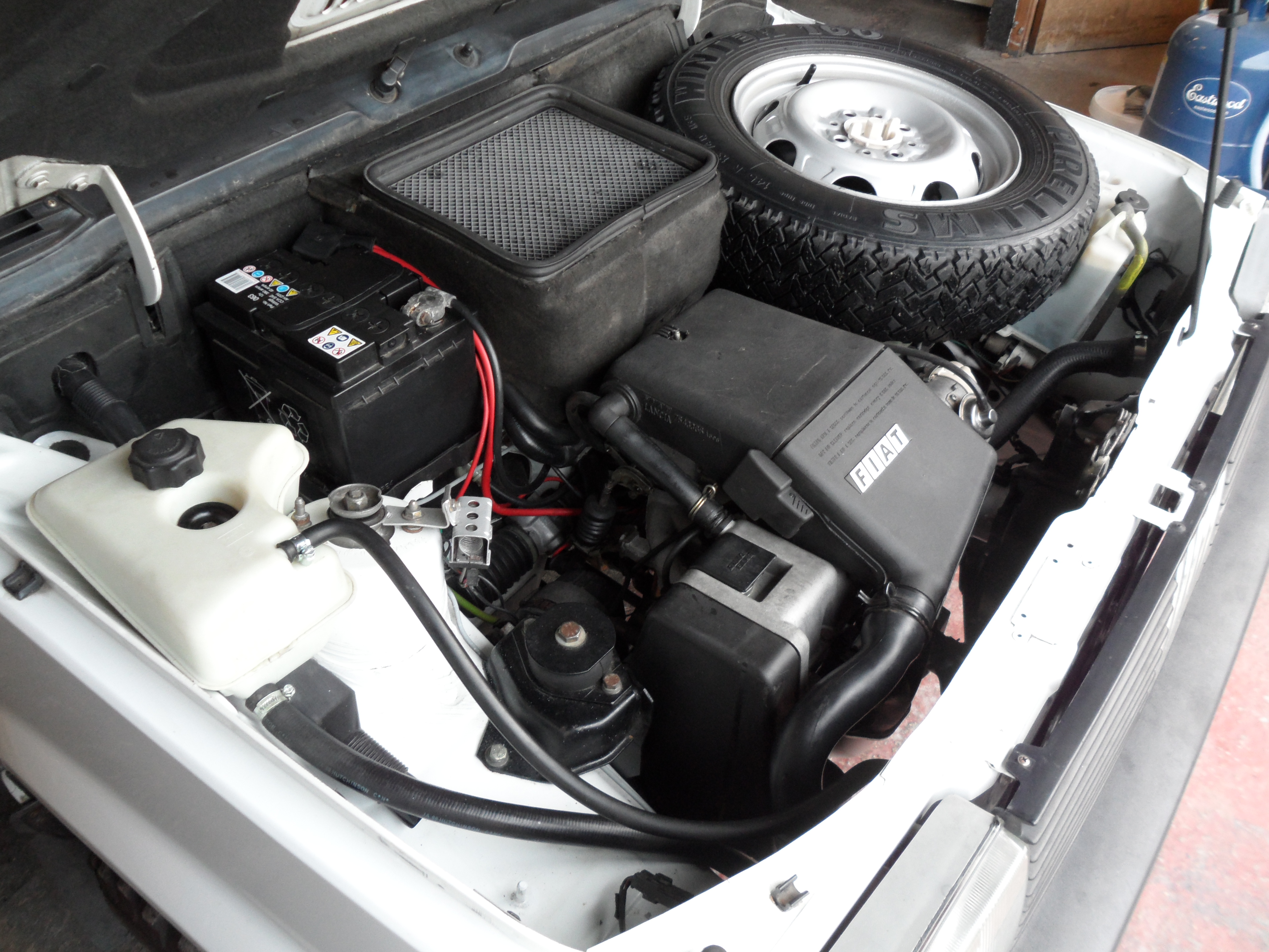

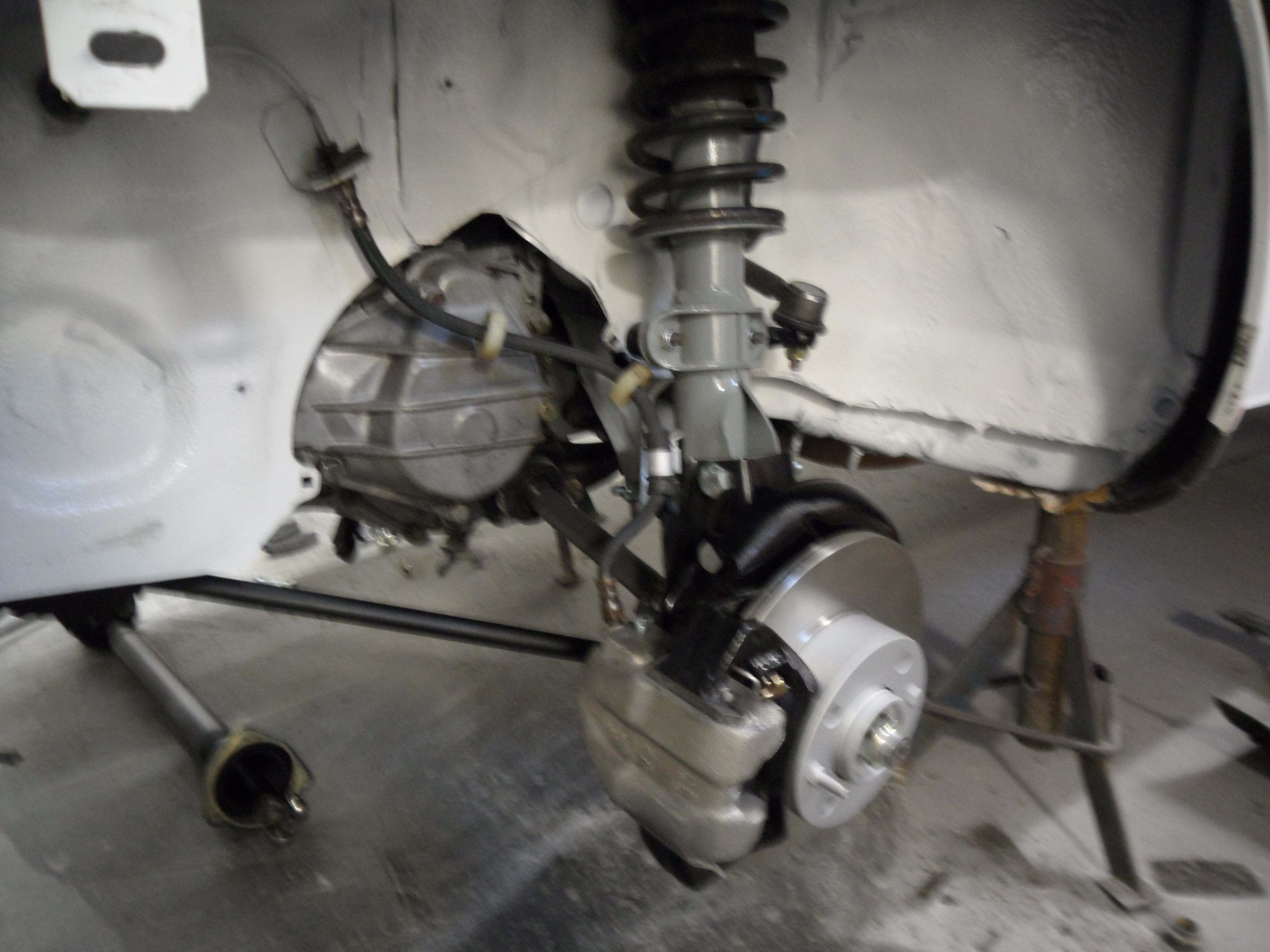

Unfortunately the big end bearing in that cyl. had suffered. I drove it like this till last November and then decided i would change the engine for a 40,000 miler I had spare. This engine change was an excuse to completely refurb the engine bay. I moved workshops while doing this so a month became three, then the front suspension was done too, so three months became six etc. etc.
Anyway, it was all done by April this year.............
