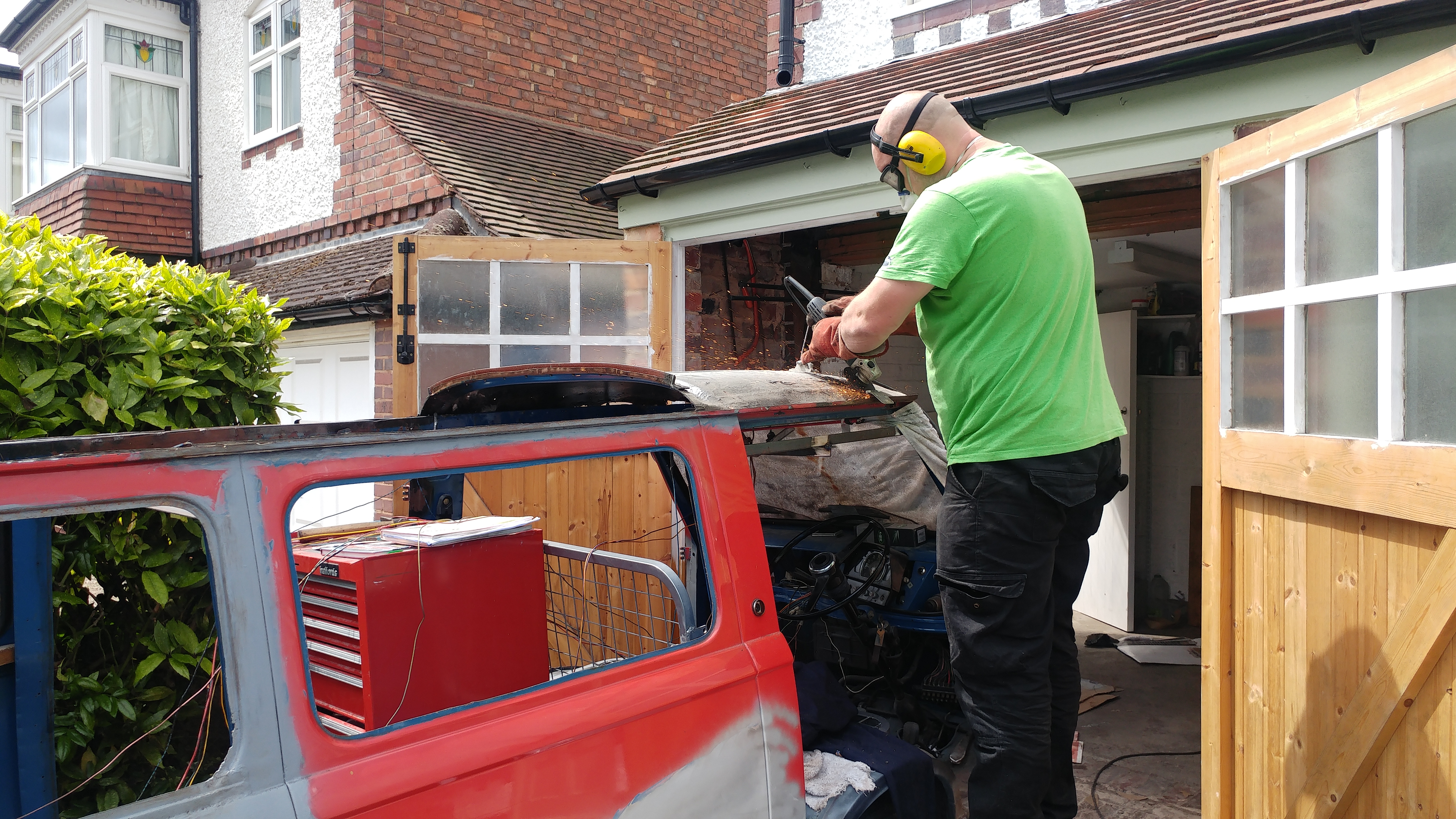

Having bought our 850T off ebay around 4 years back we're finally starting to see some light at the end of the tunnel.
Had some work done on the interior (optimistic starting point) - R+R bed in the rear, new cab seat made - the back rest can flip to face forwards/backwards.
Gearbox, steering box and radiator have all been reconditioned. Fuel tank stripped and cleaned.
The body work is starting to take shape. All bottom sections has been welded, new sills, wheel arches etc. Now starting on the roof. Time will tell if this was wise but we took the decision to replace the whole roof and fabricate a new one from scratch! Working on the plans now and aiming to start next week.
Will post some pics early next week.
Actually starting to think we might get the little bus back on the road.
