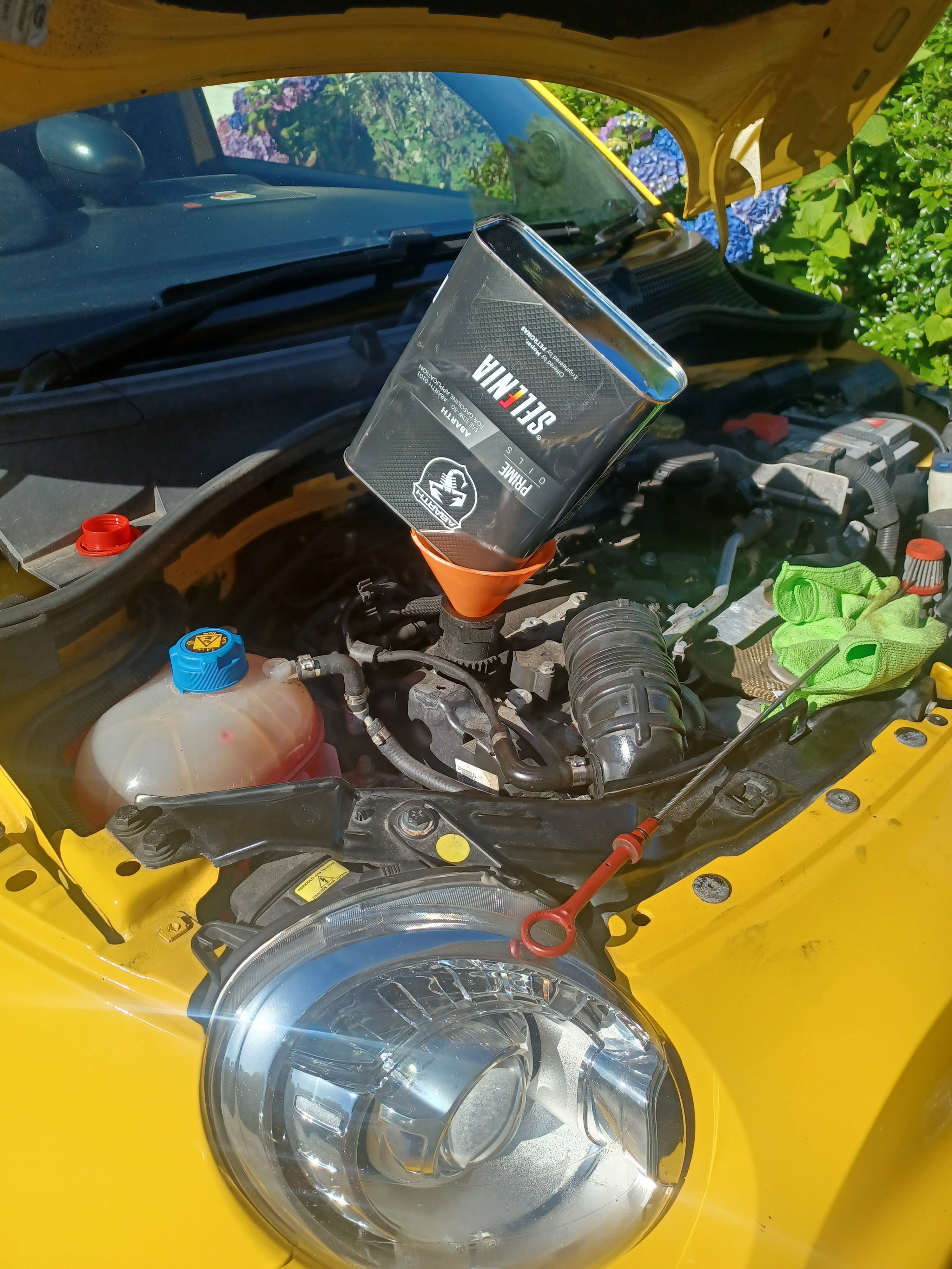

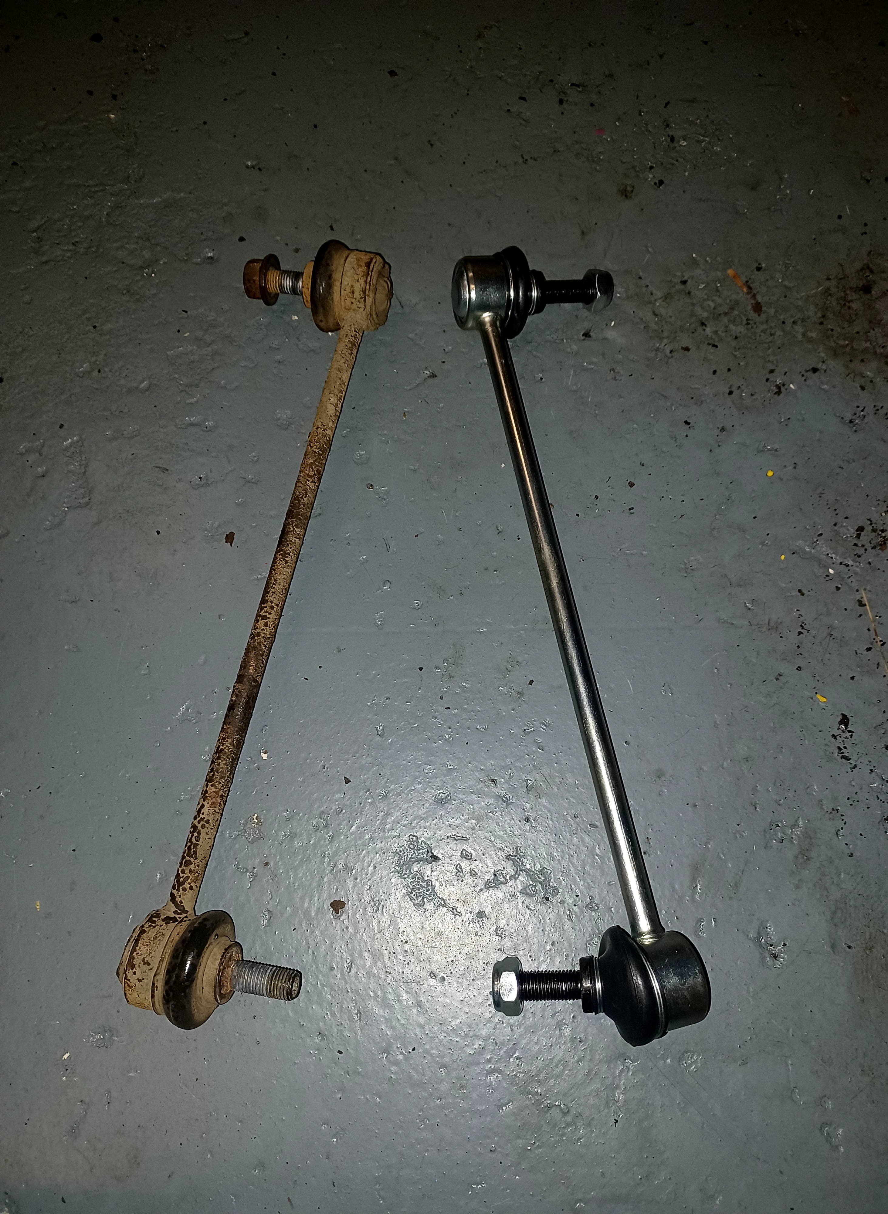

Spent a bit of time doing a bit of TLC to the Abarth, trying out BRT Motorsport C hook brake 305mm discs and EBC Ultimax pads.
Got new Droplinks as the old ones looked rubbish.
Drained old gearbox oil and filled back up with some good stuff.
Went with Bilstein B14 coilovers, car looks better and ride is just as firm but doesn't bounce as much, actually absorbs bumps on the road now!

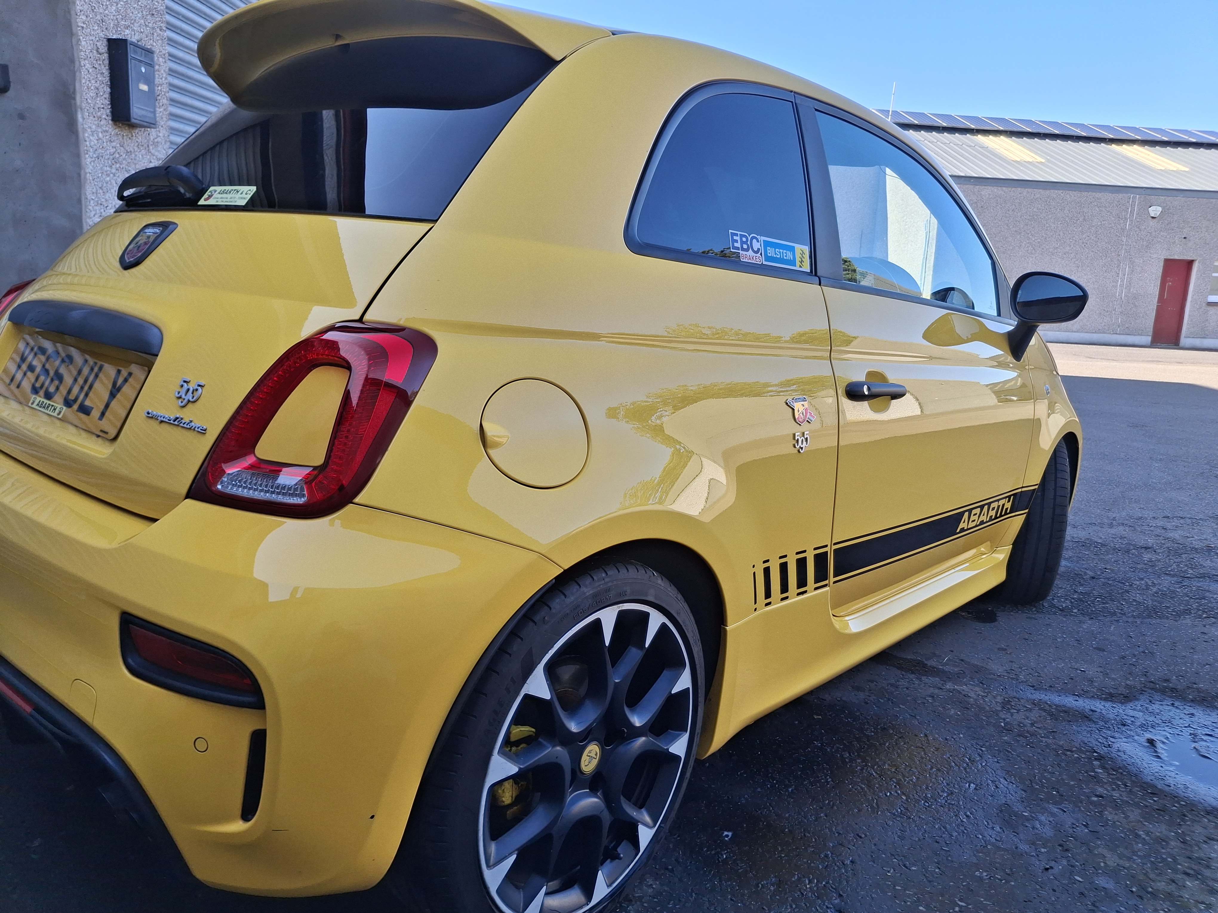

I fitted the Bilstein B14 coilover kit to my 595 Competizione in December and gave it a few months to bed in or 'sag' as most new suspension does.
But, I'm not perfect and got a few things wrong, I got new strut mounts and had incorrectly positioned them, the arrow (which I positioned forward) should have been facing backwards but sorted now. Before this the car had a bit of front caster and had more noticeable bump steer. Having rotated the strut tops the correct way now, this has been eliminated!
I actually raised the front suspension by 20mm and as you can see, has a more OEM finish to the wheel arch gap. I'm not a fan of the slammed look.
Fitted new bolts and attached the splash guard.
Found out one of my front tyres had split or delaminated?
New front tyres fitted with my personal favourite, Goodyear Eagle F1, Asymmetric 6.
Took her a run through the Galloway Forest, she looks so good when clean.
Love this little car.
