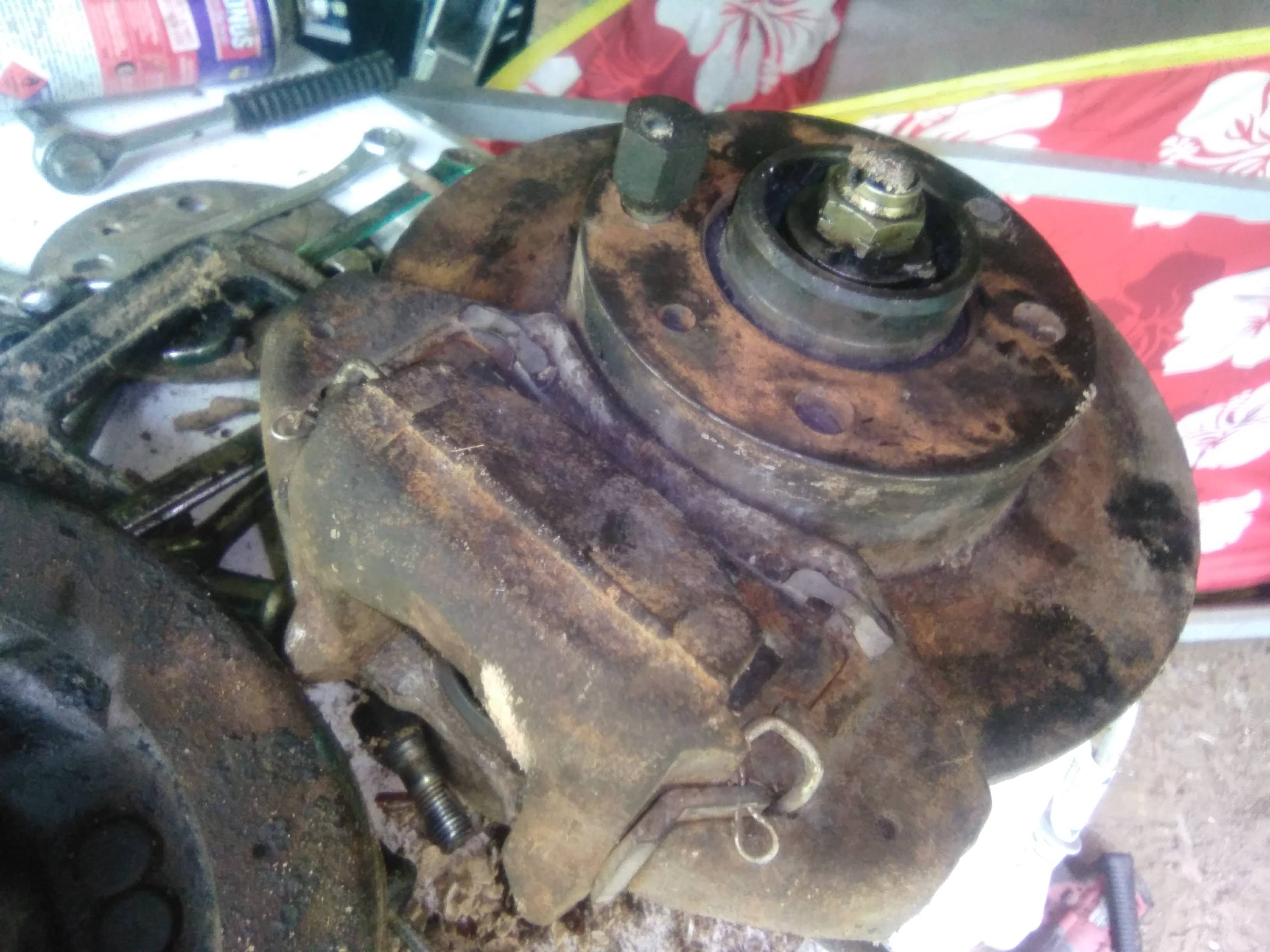

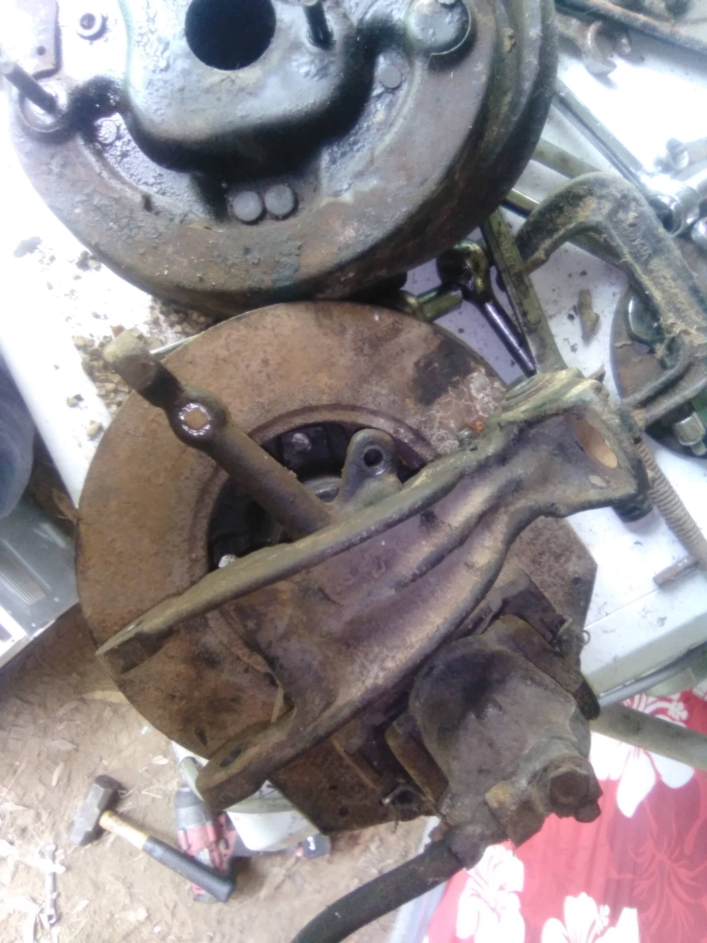

I started today with some old steering knuckle assemblies. Started working out the front then I will do the rear, as I said any advice

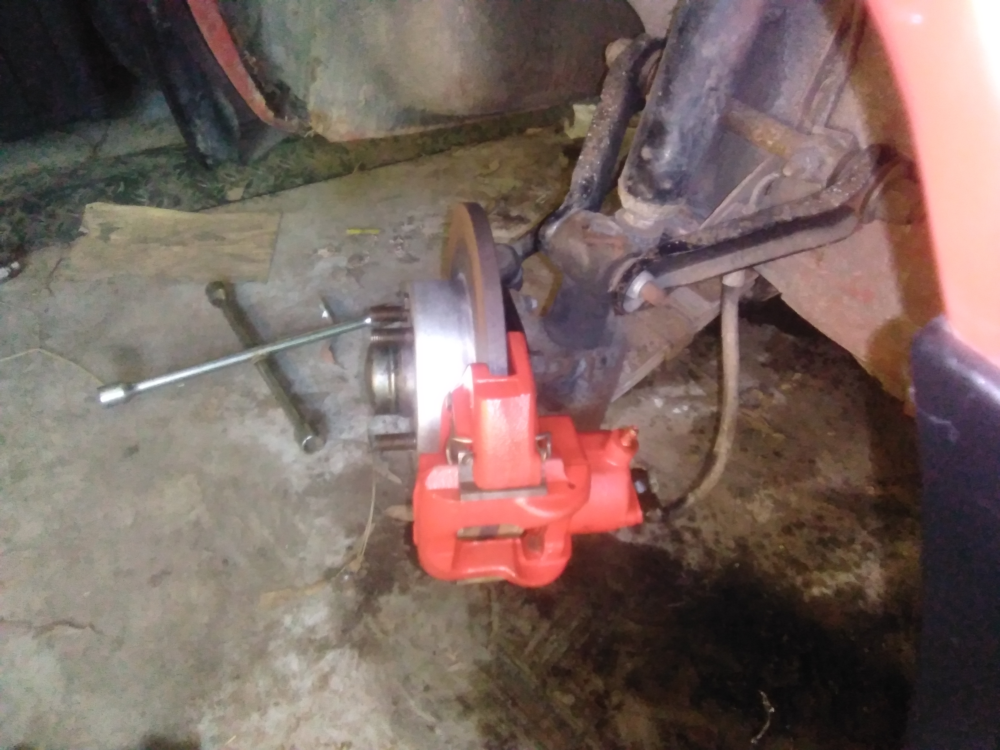

Disc brakes are on, but the front the brake lines are holding pressure at the discs after the peddle is released so getting 2 new ones made tomorrow. Can't afford braided so rubber will have to do the job. I cleaned up the parts in a electrolysis tub powered by a battery charger.
