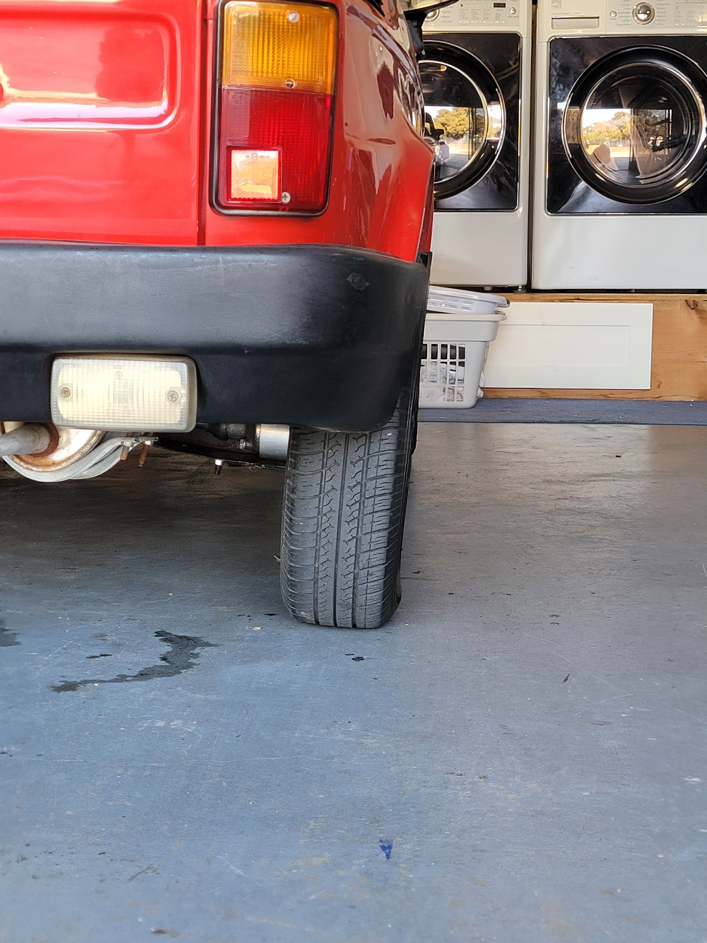

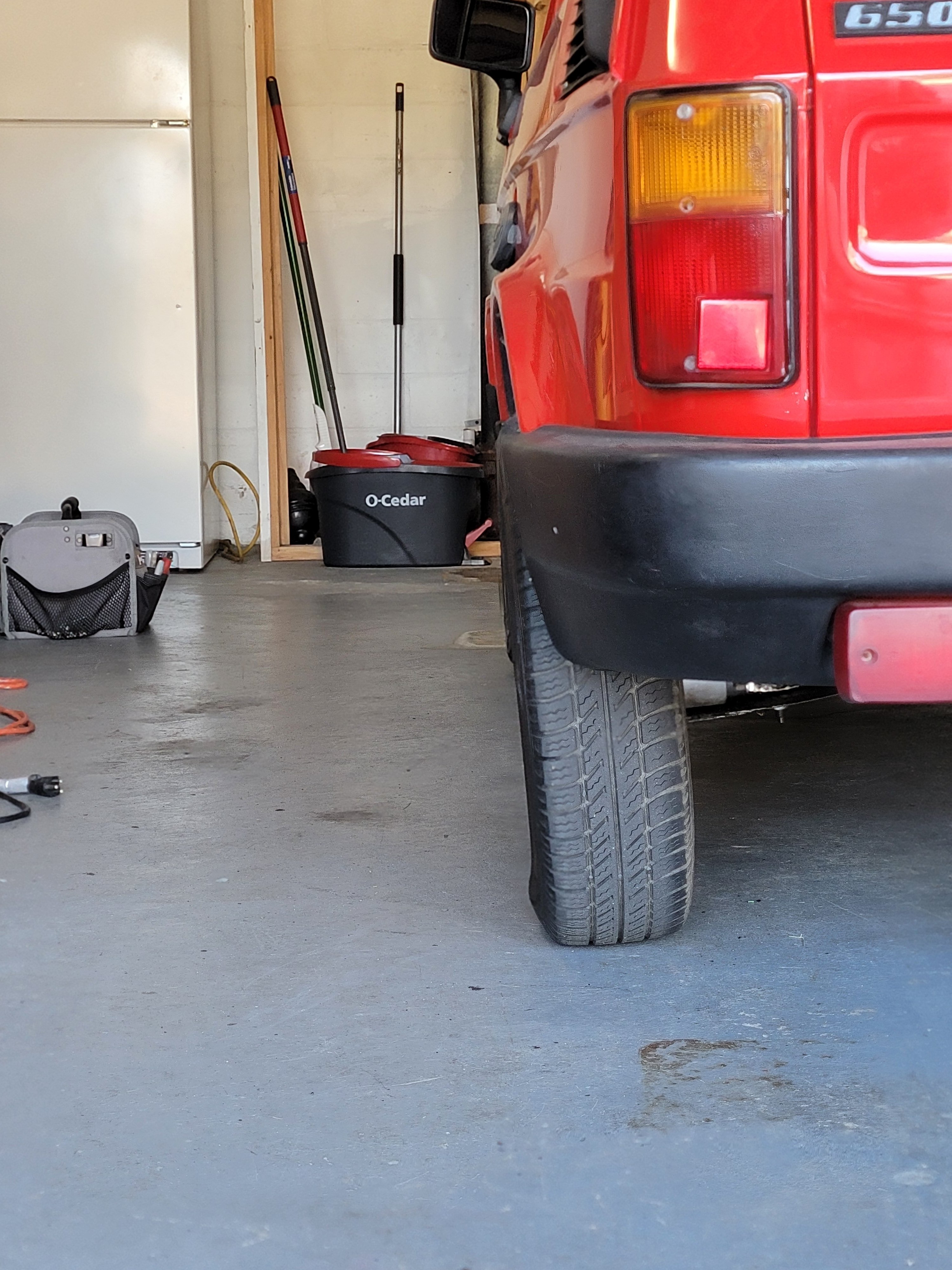

The amount of slant these rear wheel have, is that normal? It seems to be more then other fiat 126's that I have seen in pictures etc. What could be done so there is not so much slant in the rear wheel stance.

Not specific to your model , but two points, one has the vehicle just been let down from jacks as often after a road test they will settle to a normal position.
The other point is due to suspension design if the wrong or too tall springs have been fitted that can be a cause of excessive positive camber on suspension.
You often find conversely, that if a vehicle has had lots of weight in it or been used for towing, the rear springs sag, car sits lower and actually ends up with negative camber. :)
