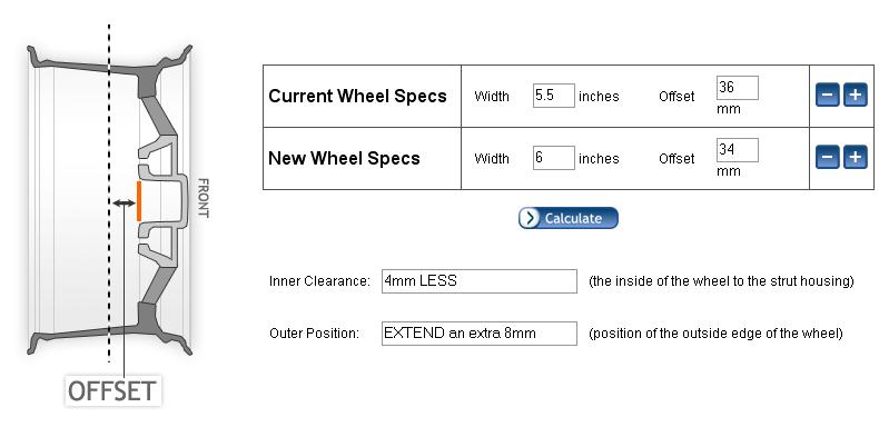

Hopefully I have this right (but I await someone to correct me).
if we know that a wheel is 6j (152.4mm) wide, and divide that in half (76.2mm), that tells us the centre of the wheel.
If we then measure from the hub face, to the rib of the rim (which in my case measures 110mm), and deduct half the width from the new measurement that should give us the offset yes?
Here's my working:
152mm (rounded down)
divided by 2 = 76 (rounded down)
hub face to rib measurement = 110mm
minus 76mm
= 34mm
based on the assumption that they are indeed et34, and using the calculator (as found in the faq - cheers Custard (y)) here: http://www.1010tires.com/WheelOffsetCalculator.asp
...it would indicate that I need 4mm spacers - so here's the thing:
Assuming that all my working out is accurate, would I be best to go with 3mm or 5mm spacers? - not going to bother on the fronts for now, as clearance seems to be good enough to avoid any scrubbing on my gearbox, but obviously the clearance on the rear of a sei isn't so great, with currently only approx 3mm to play with on 175/50's (and I may wish to upgrade to a set of 195's next summer).

Assuming 34 et, 4mm at the back will do it. It'd be crazy not to use spacers at the front -- 10mm should do it. If you don't, I'm pretty sure you'll foul the TRAs and gearbox cover.
But, given that your calculations/measurements may well be out, and that 2mm is a lot, I'd actually trial fit with the rear spring out.

on a 6j wheel the target offset to stick to OE measurements would be et30 - so based on the fact that you have only 4mm spacers and still have clearance should mean that if mine are actually et34 then 4mm ones should be plenty for me.

they were off ebay...but looking into the offset thing a bit, you should be fine with 3mm :) I'd not go for 5 as they will sit too far out, and you won't have much of the cetering ring left.
