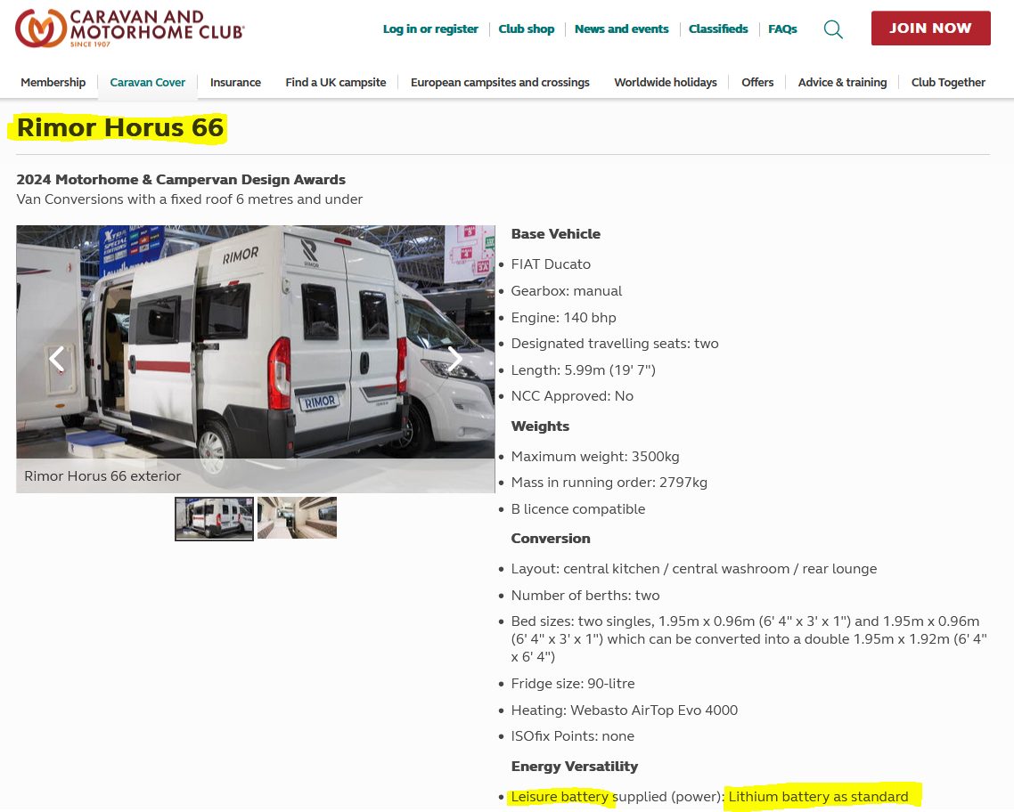

Hope the Rimor dealer knows better than FIAT ones usually do ;)
It doesn't say which lithium technology is used, but this would be enough for me not to want it to be charged all winter long.
Check for the battery warranty, it could be much shorter than the warranty for the whole van.
Thanks. I’ll ask when it’s done.

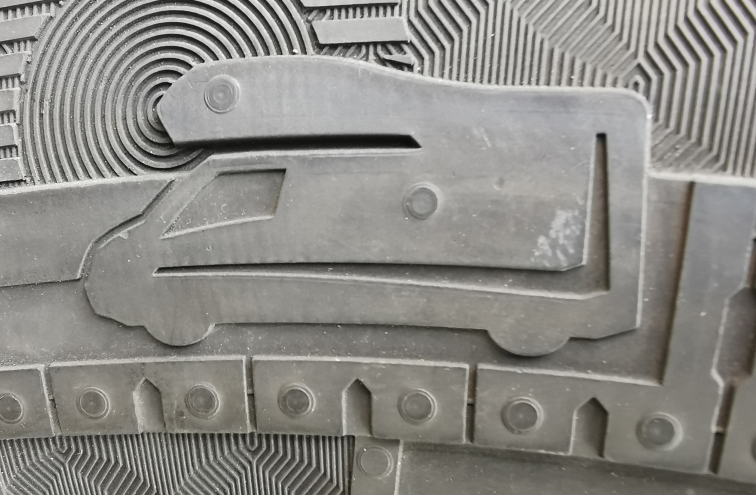

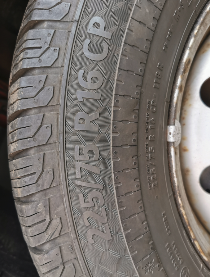

As for the tires, I've got the Continental VanContact Camper tires (marked CP at the end on the size and with a motorhome symbol) and although usual driving pressure is 4,5 bars as far as I remember, there is a information in the documentation and on the tire wall that it is permitted to increase the pressure to 5,5 bars for 'storage' periods. Perhaps the same rule applies on other camper / motorhomes dedicated tires.
View attachment 456195View attachment 456196
Thanks.
