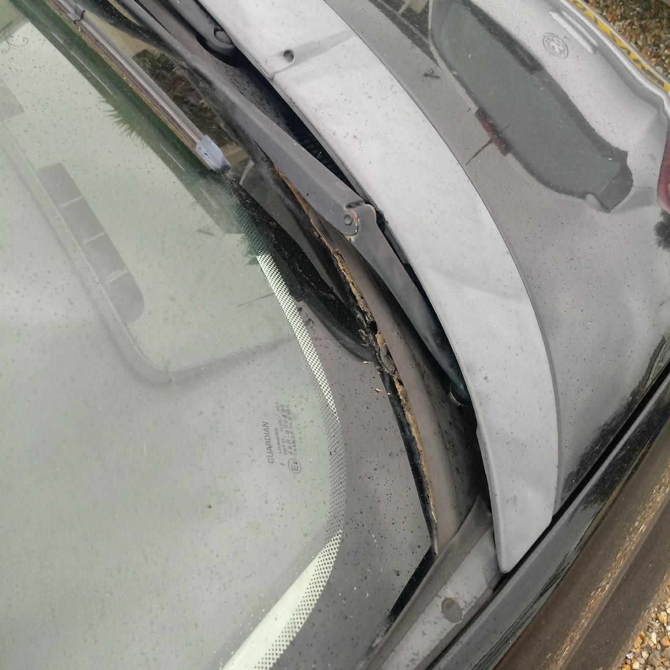

Ok, I've now taken a pic of the scuttle panel where it's come away from the windscreen. Just wondering the best way to stick it back on?

Windscreen is bonded in, so if done correctly shouldn't be a cause of water ingress.
Is it possible where that scuttle trim is dodgy, it is because there is rust behind it meaning there is nothing for the trim to fix too and possibly a rust hole there letting the water in?:(
I am guessing it isn't the windscreen it left the factory with.

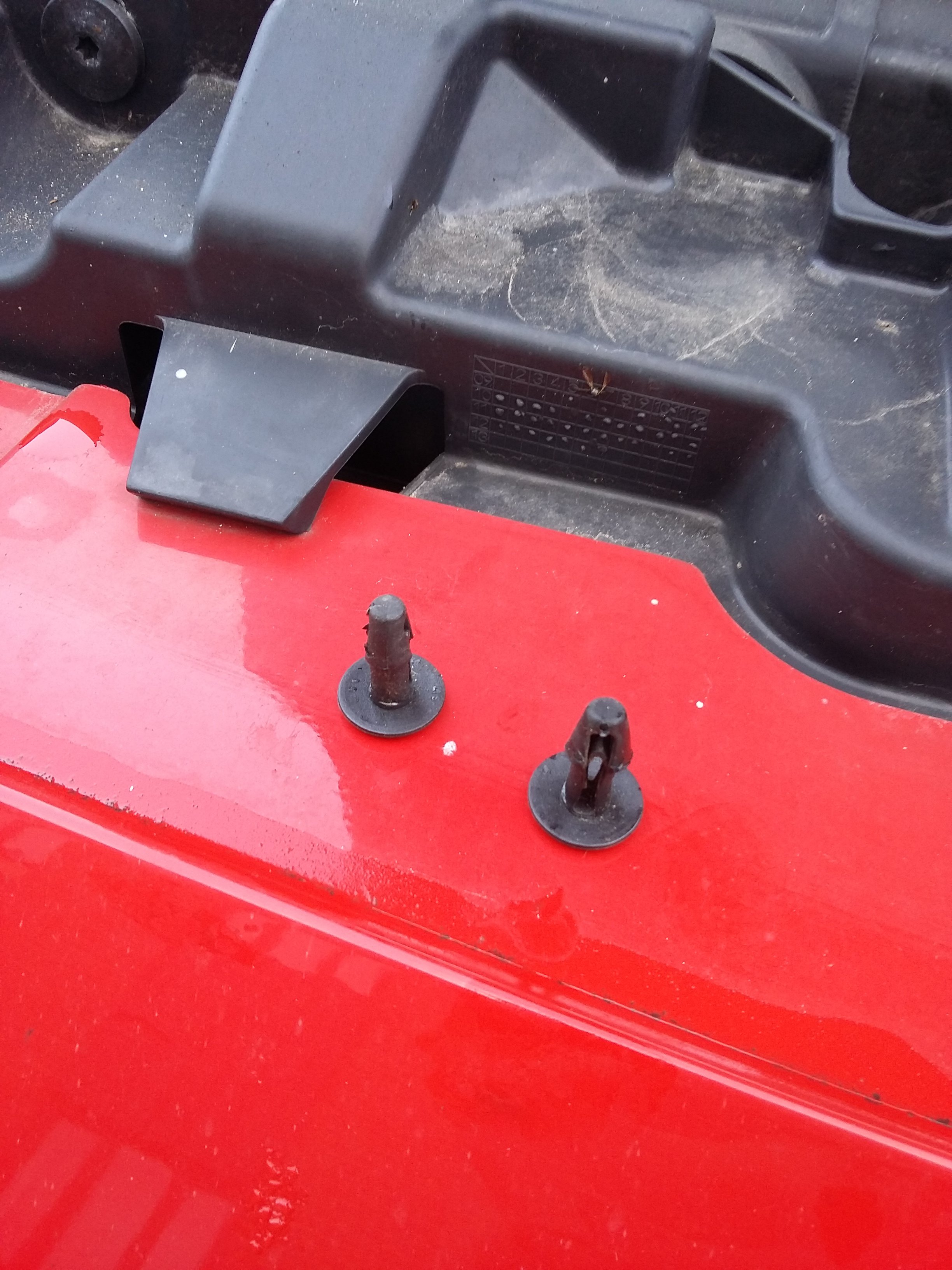

So Ive removed mine before
Lift the bonnet.. remove a few sekf.tapper fixing screws and it should be loose
YOU NEED to remove the wiper arms to fully remove the trim though

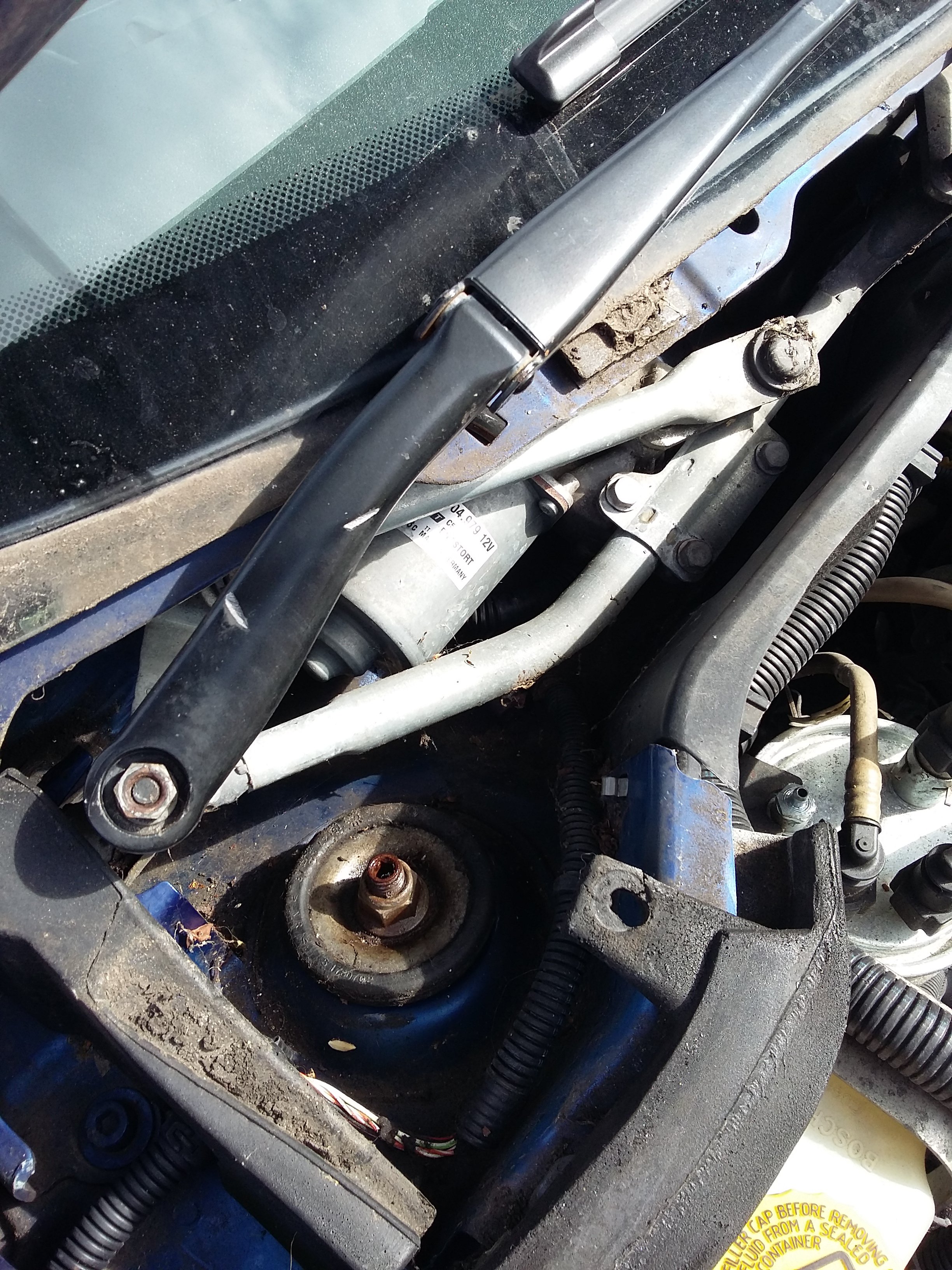

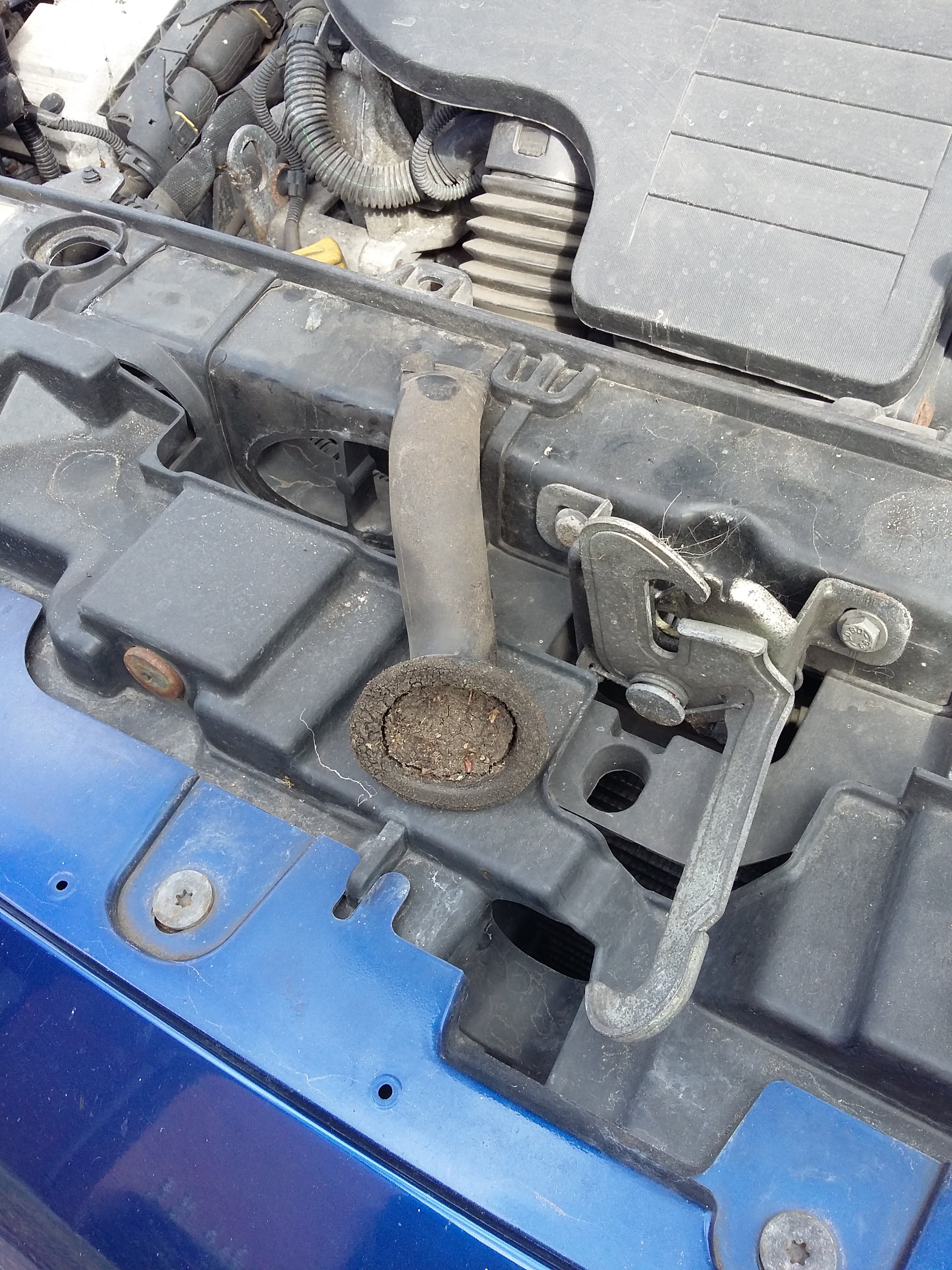

Some info here.. I will try and add my pics from 12 months ago
Looking at the photos and advice varesecrazy has given it looks very similar to my 2010 Doblo van that I did the top strut mounts on recently. The two fiddly bits I had were getting the wiper arms free of their taper on spindle, a little oil and gentle rocking eventually released them, there is a tool to pull wiper arms off, but "love and kindness " usually works. I did watch a windscreen professional break the arm on my daughters Golf by not locating it on the spline correctly, tightening the nut and the first operation snapped the arm, which with me watching he was forced to replace instead of blaming a weak wiper arm!
The other thing on removing the plastic scuttle trim is on my Doblo it was one piece right across and I had to gently bend it clear of the bonnet support arms. Luckily it was a warm day, a cold winter morning and the plastic would have been too brittle.;)

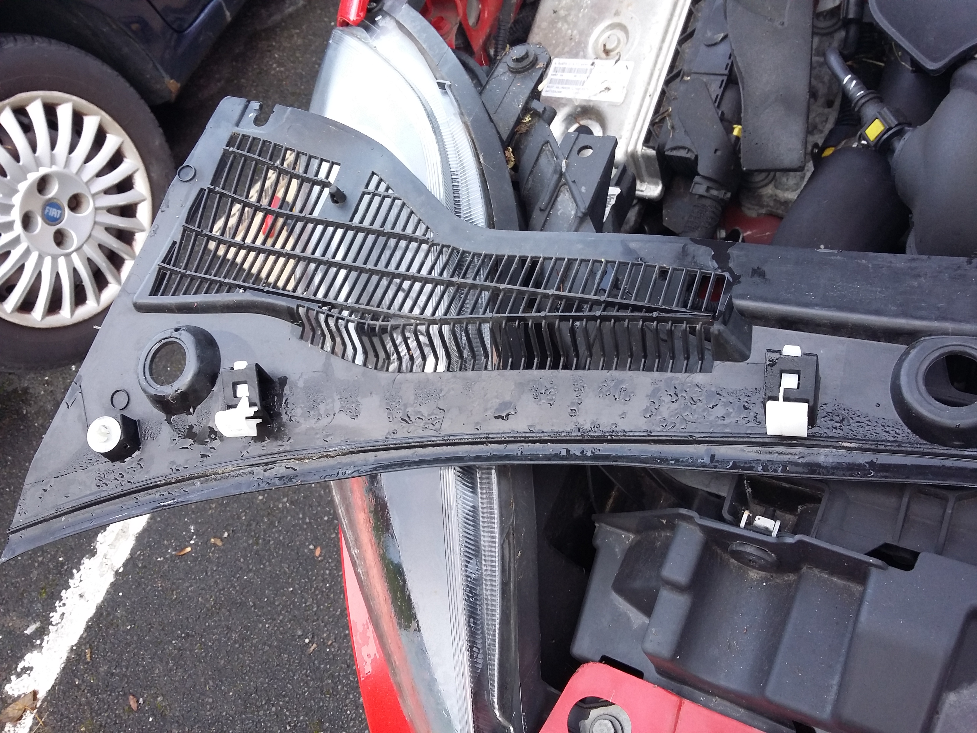

You can see here that the rubber scuttle bung is fixed to the plastic panel with the plastic button clip
The white slot is a plastic serrated 'nut' that the selftapper screw winds into
The white blocks on the underside of the plastic panel are clips that tetain the edge near the bottom of the windscreen
This is probably not in place for @BooBooDevere
