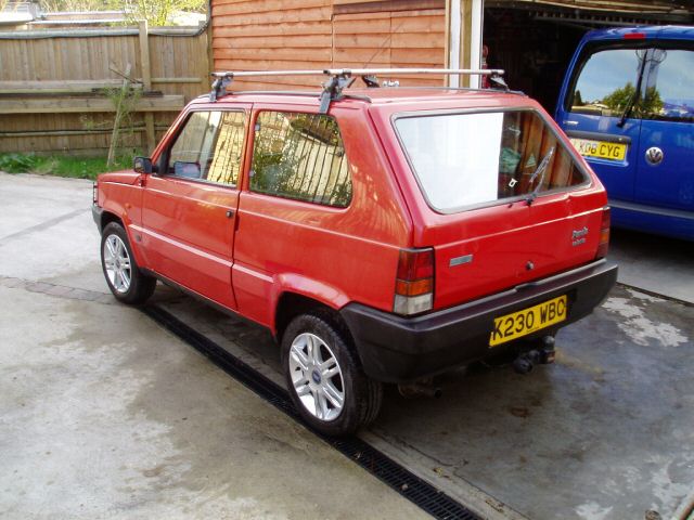

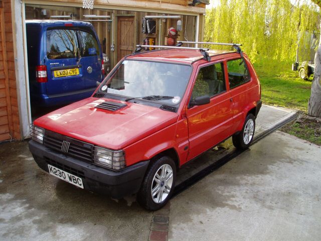

I saved this pic from eBay of a Panda recently for sale I love the alloys so much I'm gonna save up for a pair during the Summer for my Selecta. I think they're fab even if they have been designed for the mk3 Panda:D.
View attachment 41745 View attachment 41746 View attachment 41747

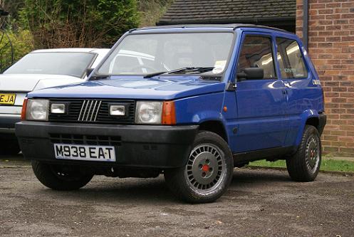

Standard steelies (165/65/13):
I reckon with a lick of paint they could look very good, trouble is they're pretty narrow.

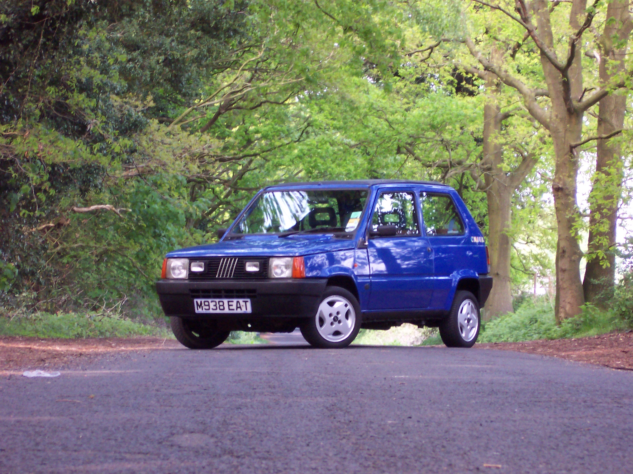

Cinq alloys (5.5x13 (165/55/13))

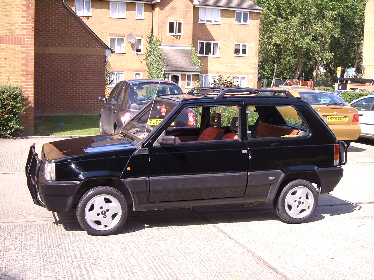

With Abarth centres:
