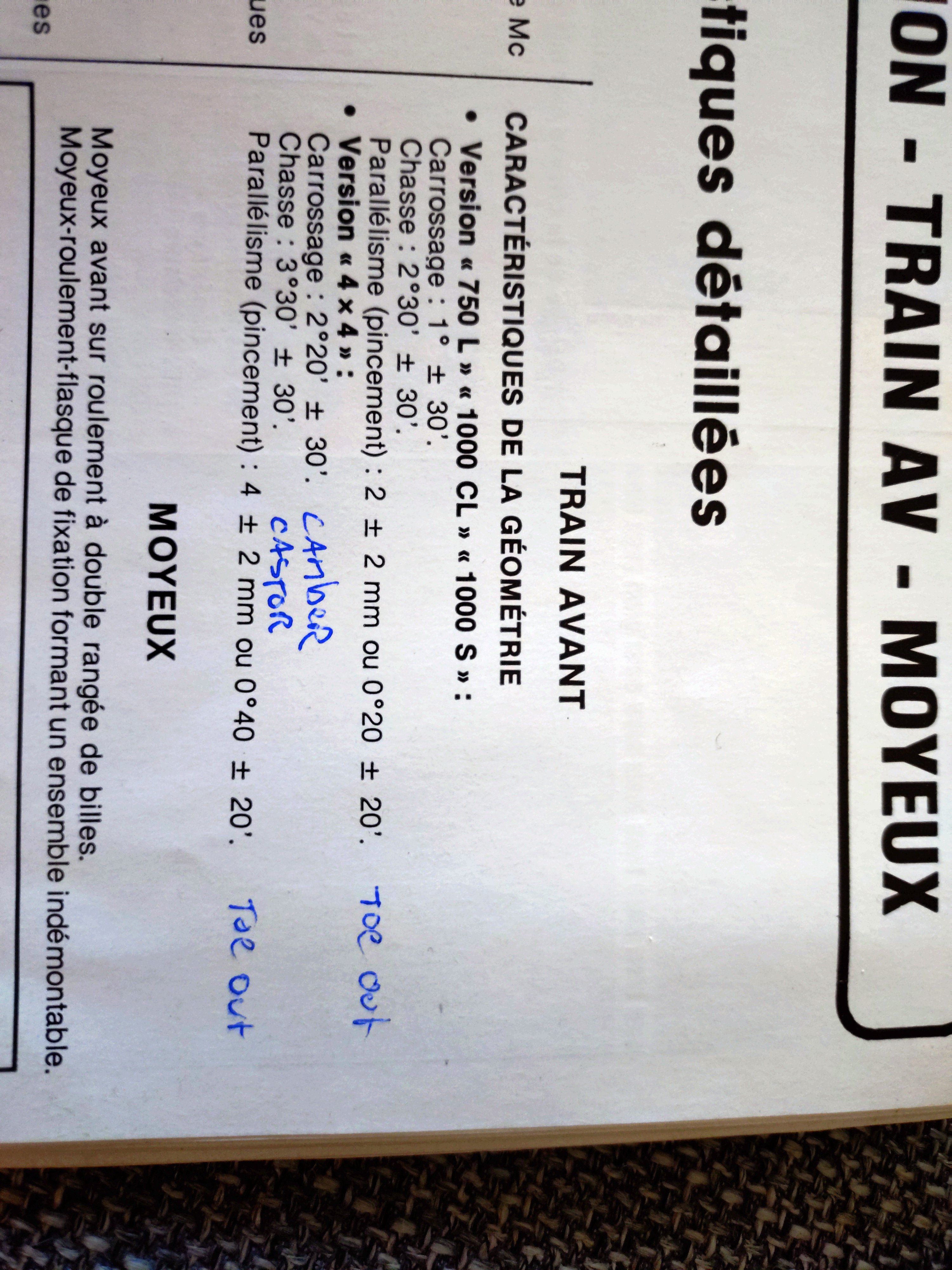

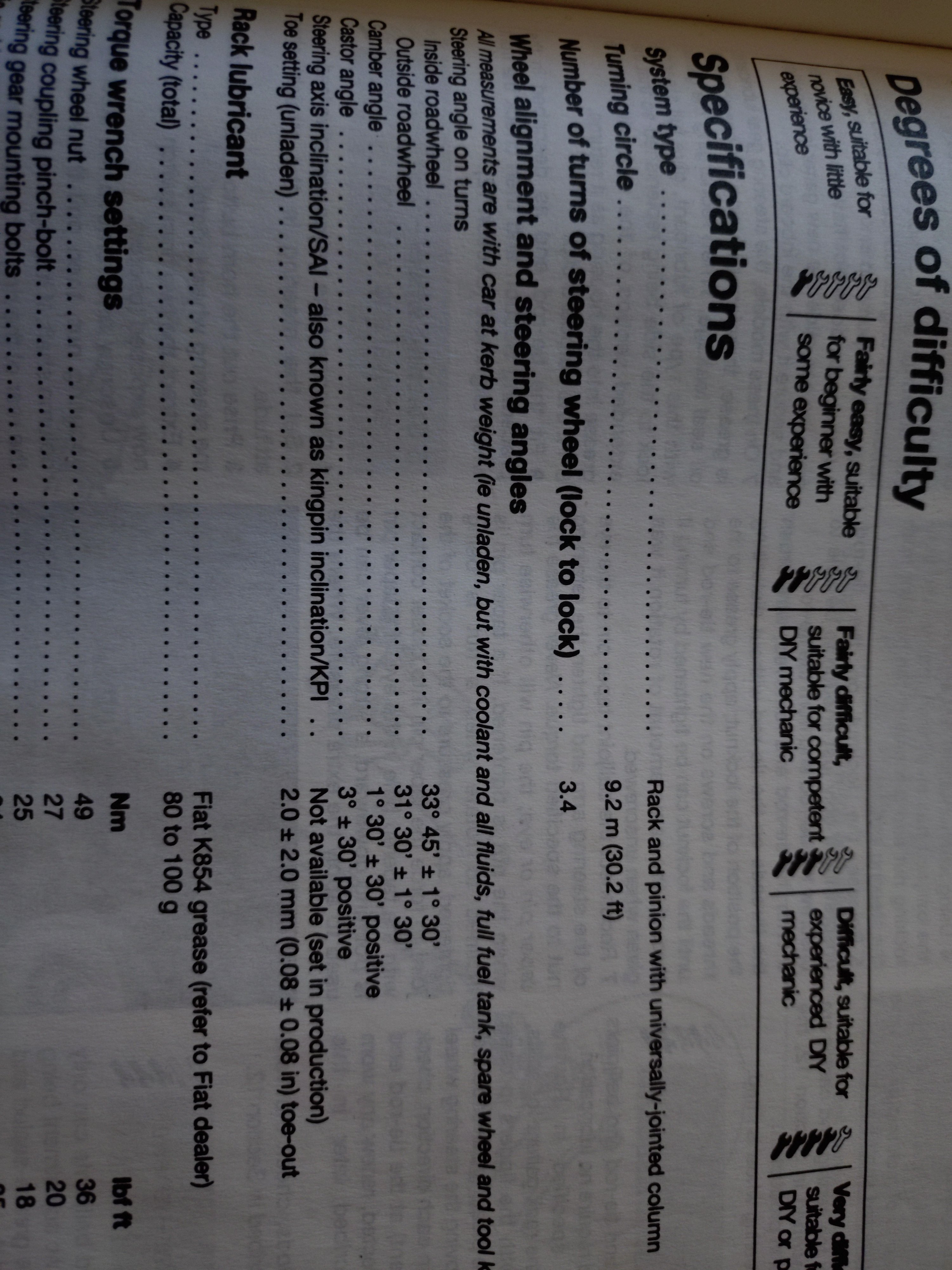

I was looking for correct wheel geometry for my 1987 4x4
I have 3 workshop manuals, Dutch, French and English.
They all have more or less the same geometry for 2wd so it seems to me these information is correct
Only the French mentions specific 4x4 geometry.
Do these numbers seem to be ok?
If yes maybe make them sticky thread
