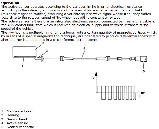

If you can't see tooth in the sensor's hole than you most probably have the magnetic track built on the bearing AND the Hall-effect sensors, which seems to be confirmed by the 3 wires...
The "extra" loose wire is the pad wear one and should only lite a light if connected to ground, which happens when the pas is worn and the cable goes in contact with the disk.
Unfortunately, schematics in FIAT's e-Learn are not always up-to-date, but here's one I found with a (generic) Hall-effect ABS sensor.
