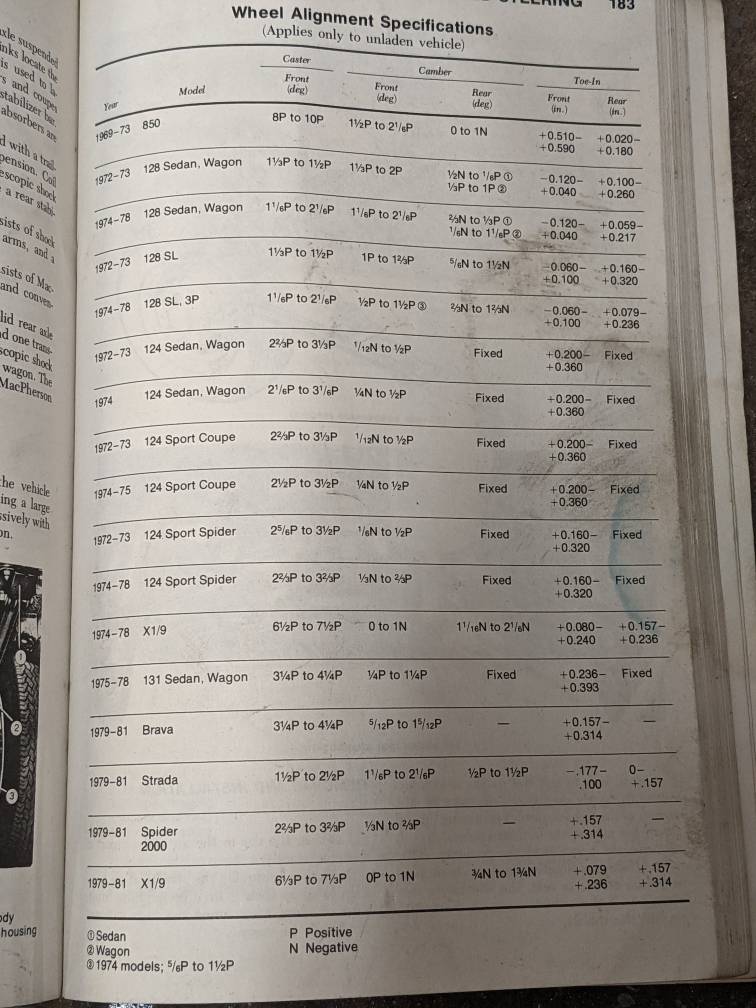

I noticed the attachment mentioned "unladen". Does this mean the suspension is totally extended with the wheels "hanging" or compressed with no fuel or passengers? I've included the Chilton page.PXL_20211028_170214288.jpeg
I would say that "unladen" would merely be without load in the front and rear boot and without passengers and with minimal fuel.
I have the specs on other cars which require a certain specified weight to be placed on rear seats before undertaking the alignment. From this I conclude that "unladen" should have its ordinary and usual meaning. If the suspension were to be dangling, then the manual would have said so.
