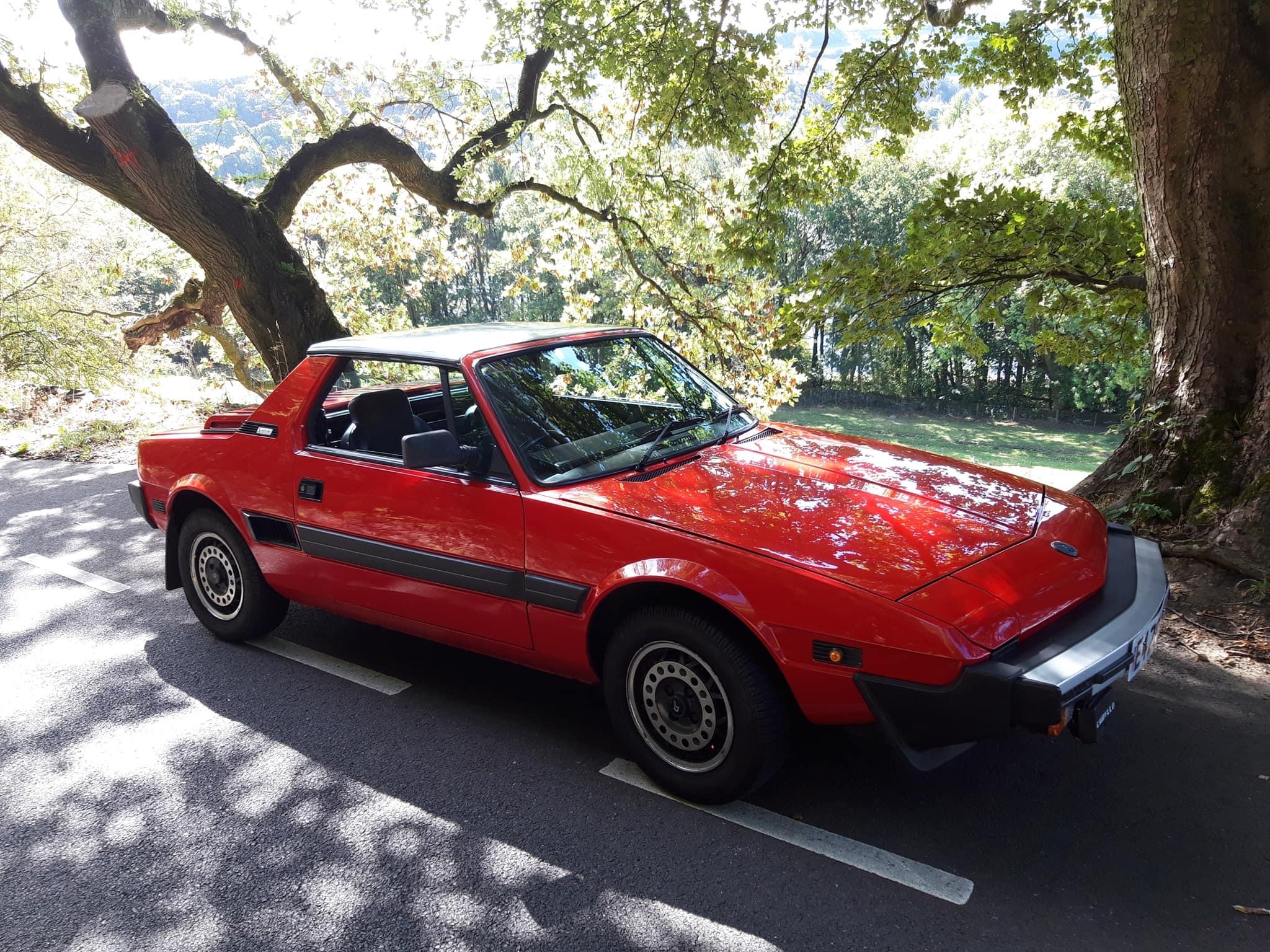

Hello there, hoping for a couple of pointers. After years of crap Chrimbo presents, this year I’ve asked the in-laws to get me a car battery for my beloved ‘87 1500. We’re probably taking EuroCarParts fare, but could anybody suggest a good strong battery for my needs. Mine won’t hold it’s charge well after all the years of store/charge, and I like the idea of getting a capacity one that’ll give the car a lift, without blowing up components around it! And while I’m on, are there such thing as headlight bulbs (H4?) now that don’t require wiring upgrades etc, but do a much better job than the candles I’ve had in all these years.
