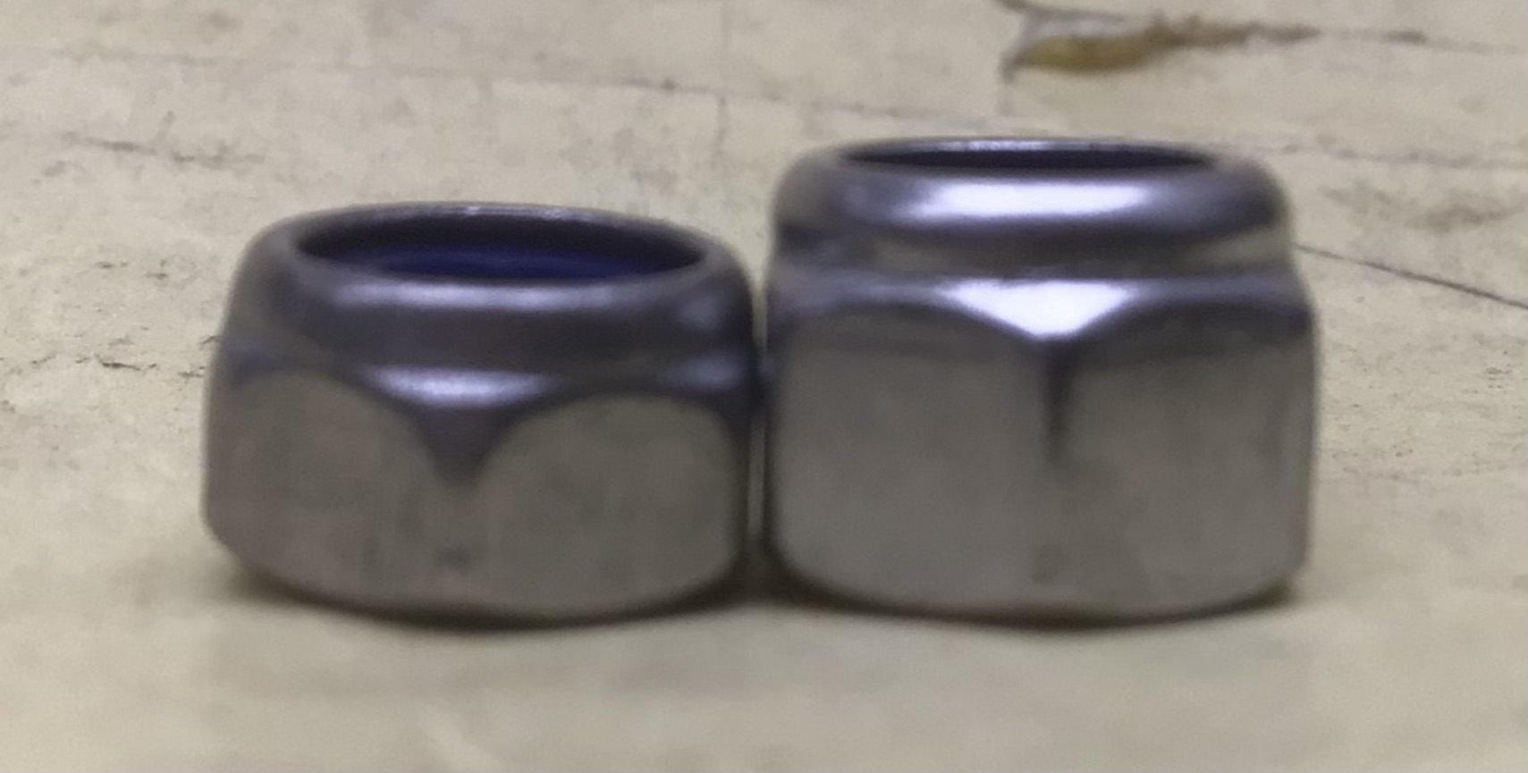

The original nylock nuts on the carb are deep nuts so a bit taller than standard. IMG_6223.jpeg
Picture shows standard against deep M6 nylock stainless nuts
