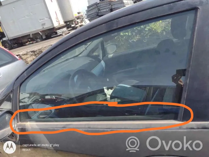

Hi! No I am talking about the rubber part on the outside of the side windows, that normally would "wipe them clean" when winding them down and up again, while nothing happens if I do it with mine
Basically the part circled in orange in the attached image here:

I don’t actually think they’re there to specifically clear the windows, more there as a seal to stop vast amounts of water running down in front of the glass and rotting out the bottom of the doors. Have they started cracking? If not rather than going to the hassle of changing them just get yourself a squeegee and keep it in your door pocket, only takes a minute. I personally don’t like clearing the windows by putting them down as it puts unnecessary moisture in the gap on the way back up, also if you do it in the winter and don’t realise it’s frozen, certain cars can break the window clips or dislodge the window. Been there and trust me it’s not worth the hassle! 🤣

Fair point! I always used them to clear the windows since childhood since normally they did a pretty good job at it, so I thought that was part of their purpose 😅 They are otherwise fine, just prettyuseless and as I said in my first post, kinda green on the inside, but I can live with that!
Ah, OK :)
It's also rubber, so same principle applies.
As far as I've seen, their shape is very model specific, so I'm affraid sourcing an non-OEM part would not be easy. While replacing a broken plastic window slider on my girlfriend's non-FIAT car I've cleaned them with a brush and APC, then rinsed with water. Perhaps also lubricating with a silicone based lubrifiant would help to keep the elasticity, but I'd avoid applying it directly to the surface which is touching the glass.
I'm also using a squeegee to remove the condensation and water (+dirt) off the windows before I drive away.
