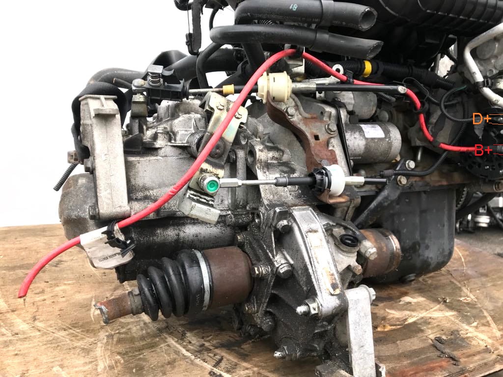

Mr. "Who" should be familiar with the charging basics and check the positive wire (if there are any "things" attached or it's just a straight wire from the alternator -> starter -> battery, like most Fiats were wired in the past). Battery to the main fusebox is a different circuit.
If you can't tell if there's a fuse on the main wiring (related to charging), there's no hope for you (too complicated).
"Who" should also know, there's no negative wires to the alternator and starter. Car body, gearbox and engine block acts as a "ground/earth/minus".
Alternator needs an "excitation" to start charging, D+ wire. In theory it should also work by self-excitation above certain speed, RPM, but it's not 100% guaranteed. Line D+ is managed by ECU electronically (and by software tricks). It's a gray/black connector on the side of the ECU (between ECU and battery).

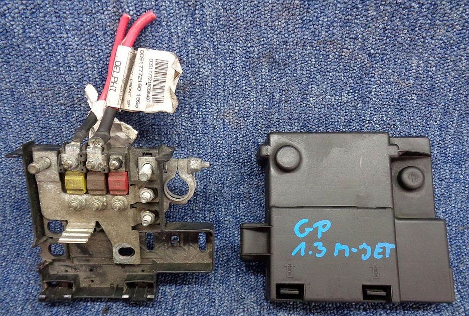

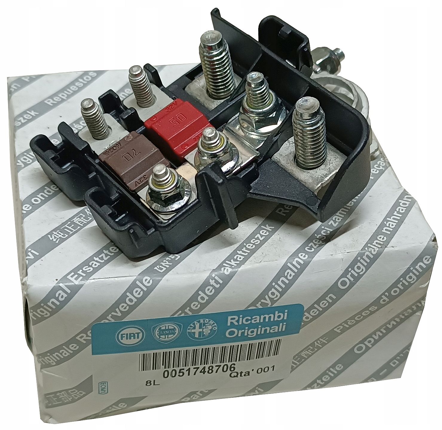

What type of battery terminal clamp (positive) do you have? Simple one (just a clamp) or a mini "fuse box"?
But still, alternator should be unfused (direct connection to the battery).

There is probably a wiring/connection problem somewhere. But it's a simple circuit. TWO wires, big (B+) and small one (D+). That's it.
Even if there is a slightly bad ground at alternator body (dirt), it can't be that bad (resulting in no charging at all) in most cases.
So line D+ is to be inspected (from the alternator, previously mentioned gray connector near ECU, and ECU itself). Ohm-meter, continuity.
Alternator can be excited using small current on D+, for example with small 12V LED indicator/control lamp (you put it between battery Plus and D+ on the alternator = it should "wake up" and start charging, when the engine is spinning of course).
That's all for basic home checks (besides main ground/earth). If D+ line is OK and/or LED trick doesn't work, it's a bad alternator probably (it's dangerous while engine is in operation, but check the voltage at alternator, not only at battery terminals). Or a very dirty job (alternator body is not contacting the engine block, there is so much dirt, grime, oil, rust). If the connections are bad, there is a danger of "frying" the alternator (regulator), but normally it happens when it is charging OK, and you suddenly cut the load completely. Regulator can be shorted and overcharging. But your unit is not even trying to charge...
