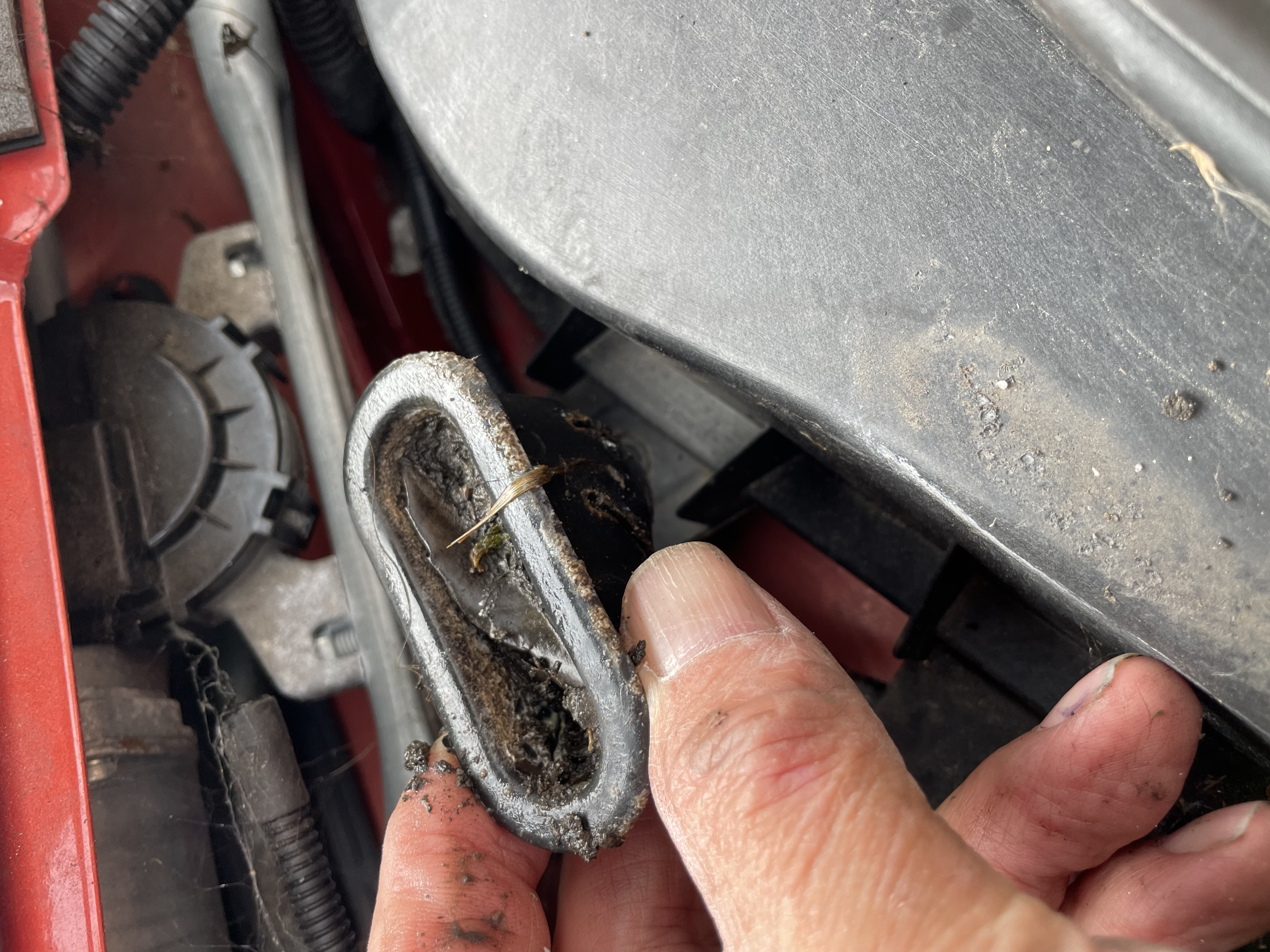

Thanks very much for the suggestions. Duckbills seem clear. There is no obvious site for the ingress. Weirdly the boot floor can be wet after a lot of rain. The sloshing water can be seen dripping out from under the car behind the engine compartment - slowly.
Clear duckbills.... You will be the first. I find they need cleaning twice a year. As to the smell thing its nonsense. All the 319 duckbills seem to be made of hard plastic, They are a poor fit and inflexible. If you touch them they come loose and one side is tight to get back, The only purpose is to contain the leaves and debris and prevent it falling onto engine and steering etc. May be.. just about worth keeping, but only just. I suppose better than drain pipes of old that also always blocked up.

Well I sat in the boot (somehow) with side panels off. Hose ++. Nothing. Then trained hose on windscreen for a while. Drove round the block - water splashing around like before - a lot. So you’re right. Coming in via those vents (forget the name). Is there any guidance anywhere how to take them to bits and see if any break in the drainage? (Presumably).
Colleagues linked it earlier in the thread in the expectation that would be what it was - it's almost invariably the duckbills.

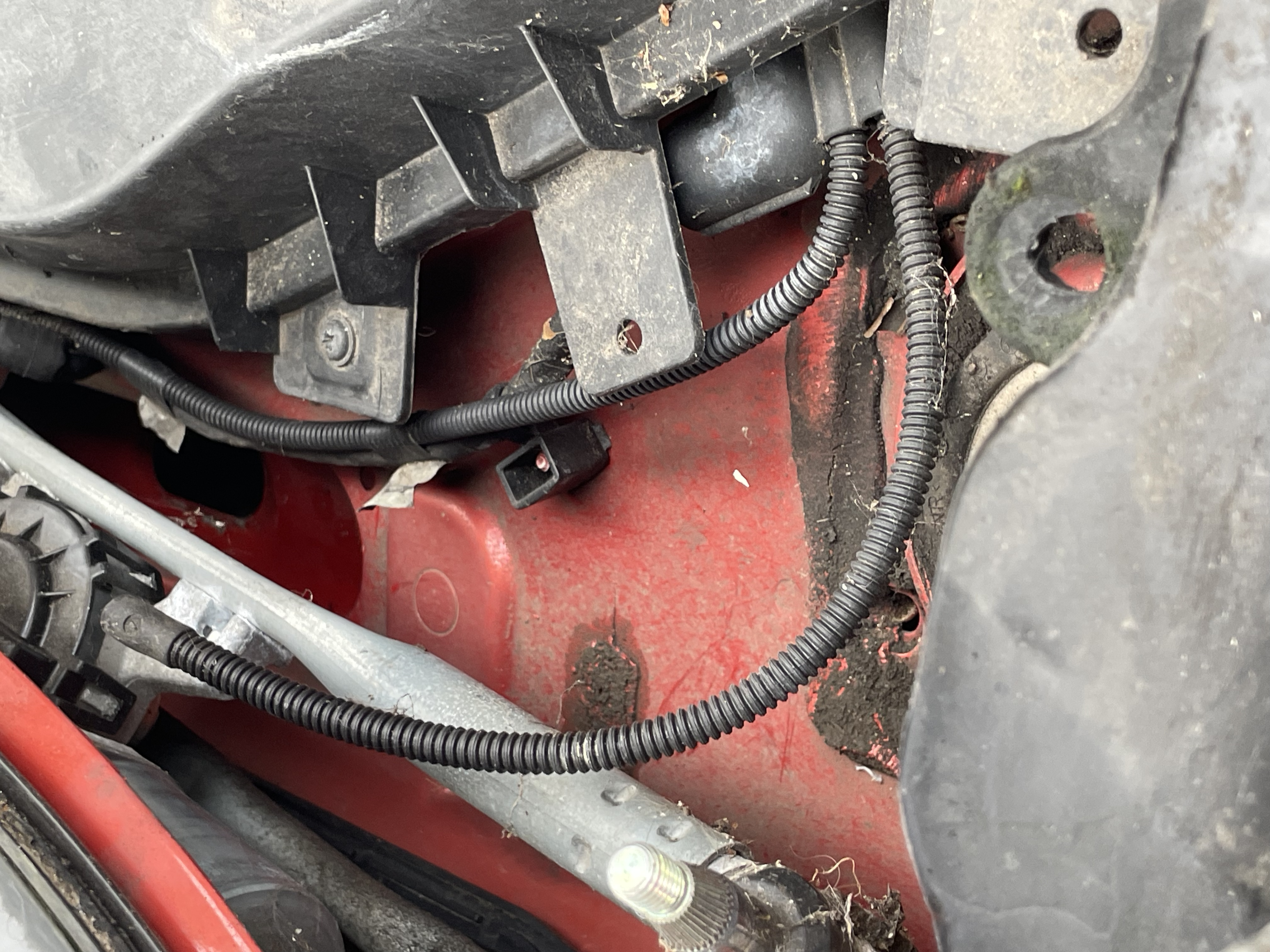

Thanks very much all. I think I managed it. The duckbills were brim full of - what was basically - muck. All cleared now.
