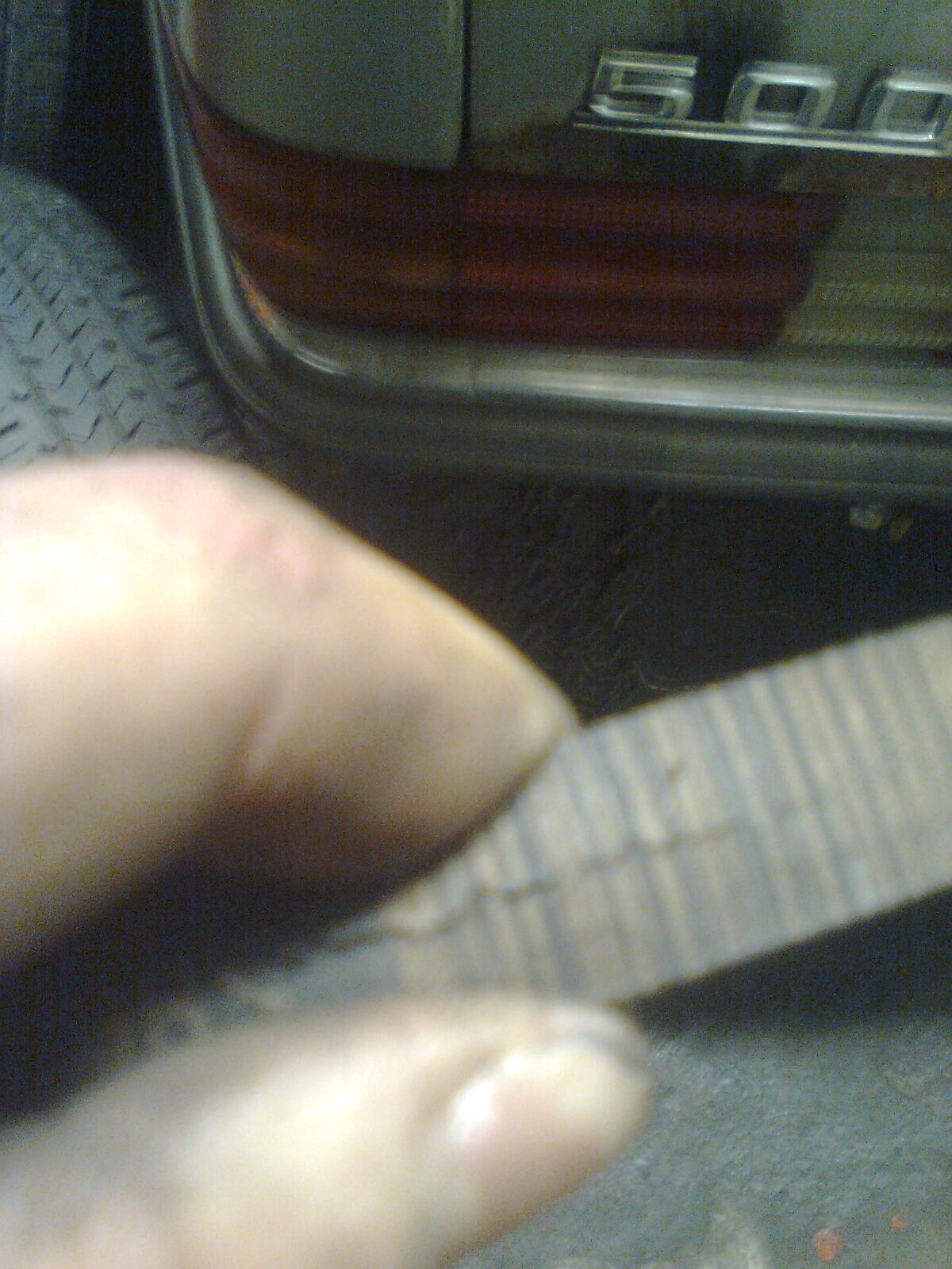

First, cam guard off. Out of tension :eek:
That means a belt change (y)
And a quick clean of the engine too :D
Needed changing... :eek:
Perfect :)

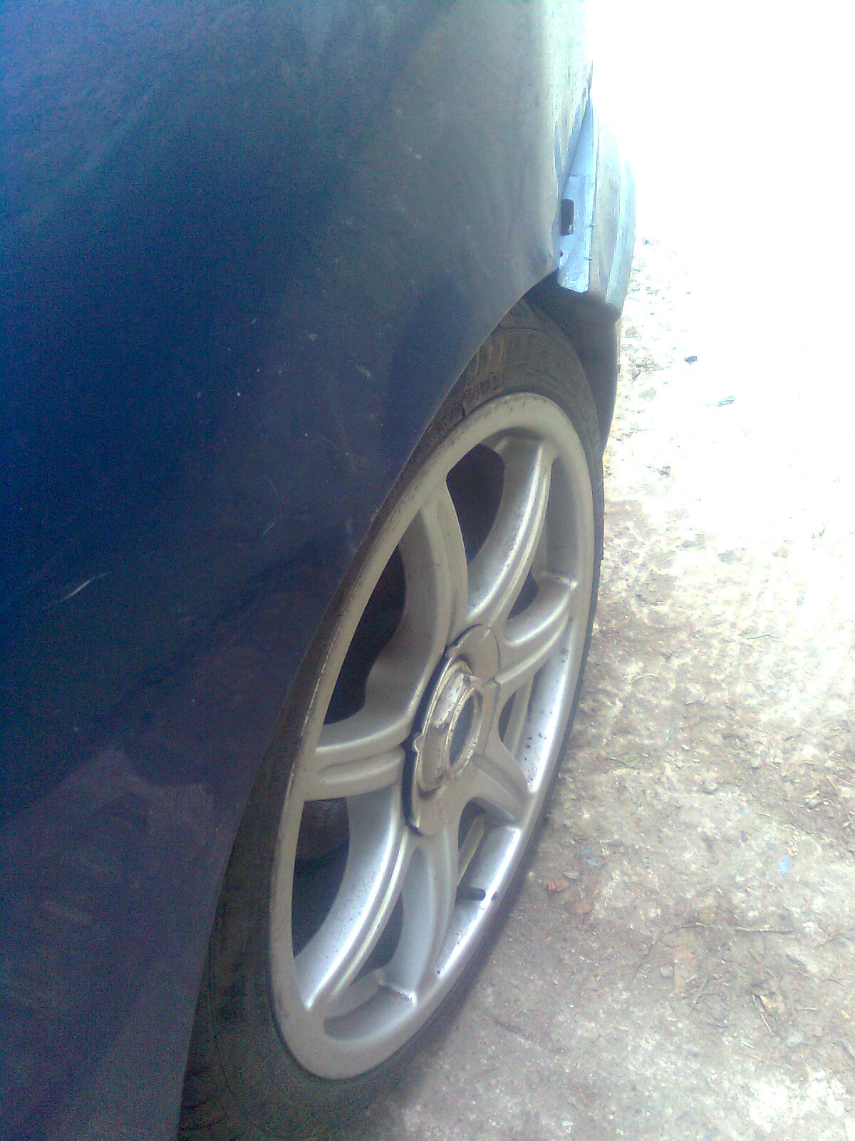

Remember my annoying arch problem? Take this!!!

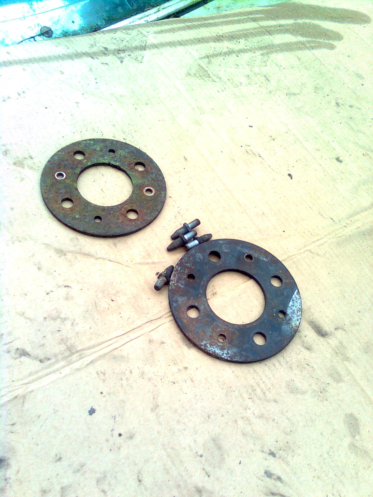

Experiment time: A few of these are lying about. Time to fit a pair...
Like so :)
Using...

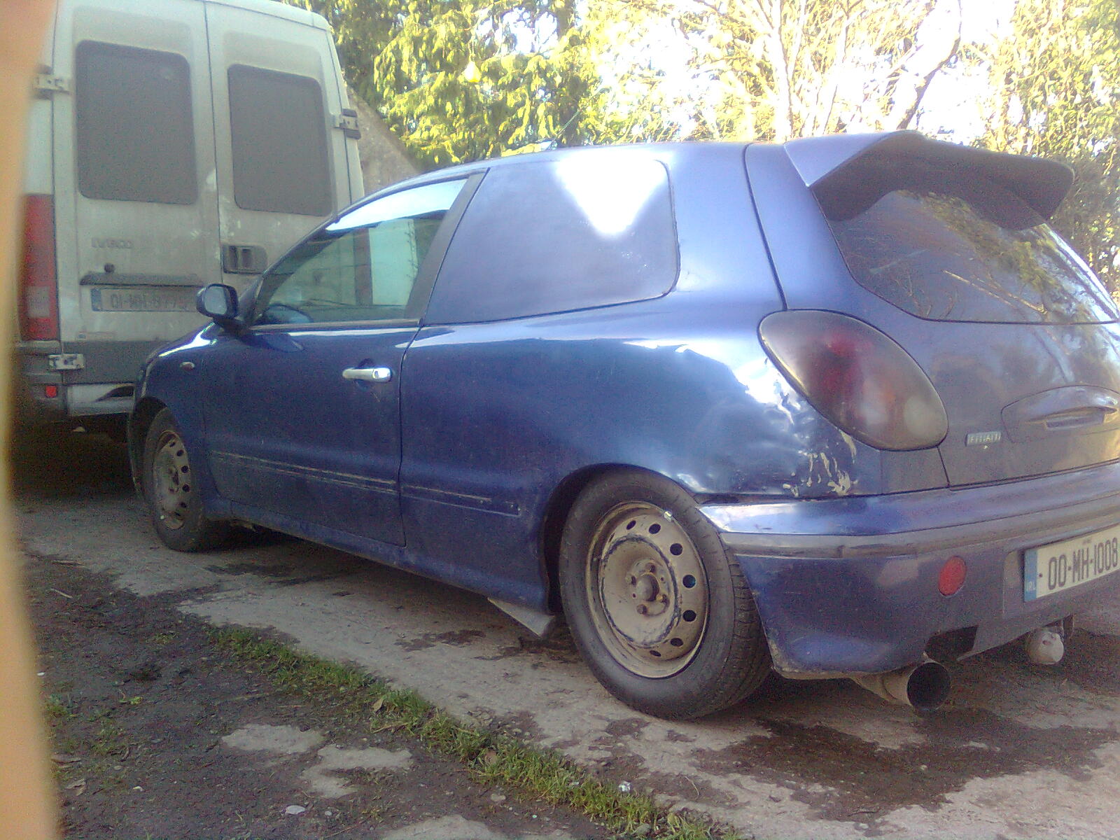

What happend to the rqp? Sorry to say the pics make it look very rough :(
It was repaired by an ape before I got the car :(
You are spot on, that's its bad side. Since fixing the arch the bumper won't sit right making it look even worse! :bang:
In due time, it's difficult to push that side out, but I'll get to it when I have the time ;)

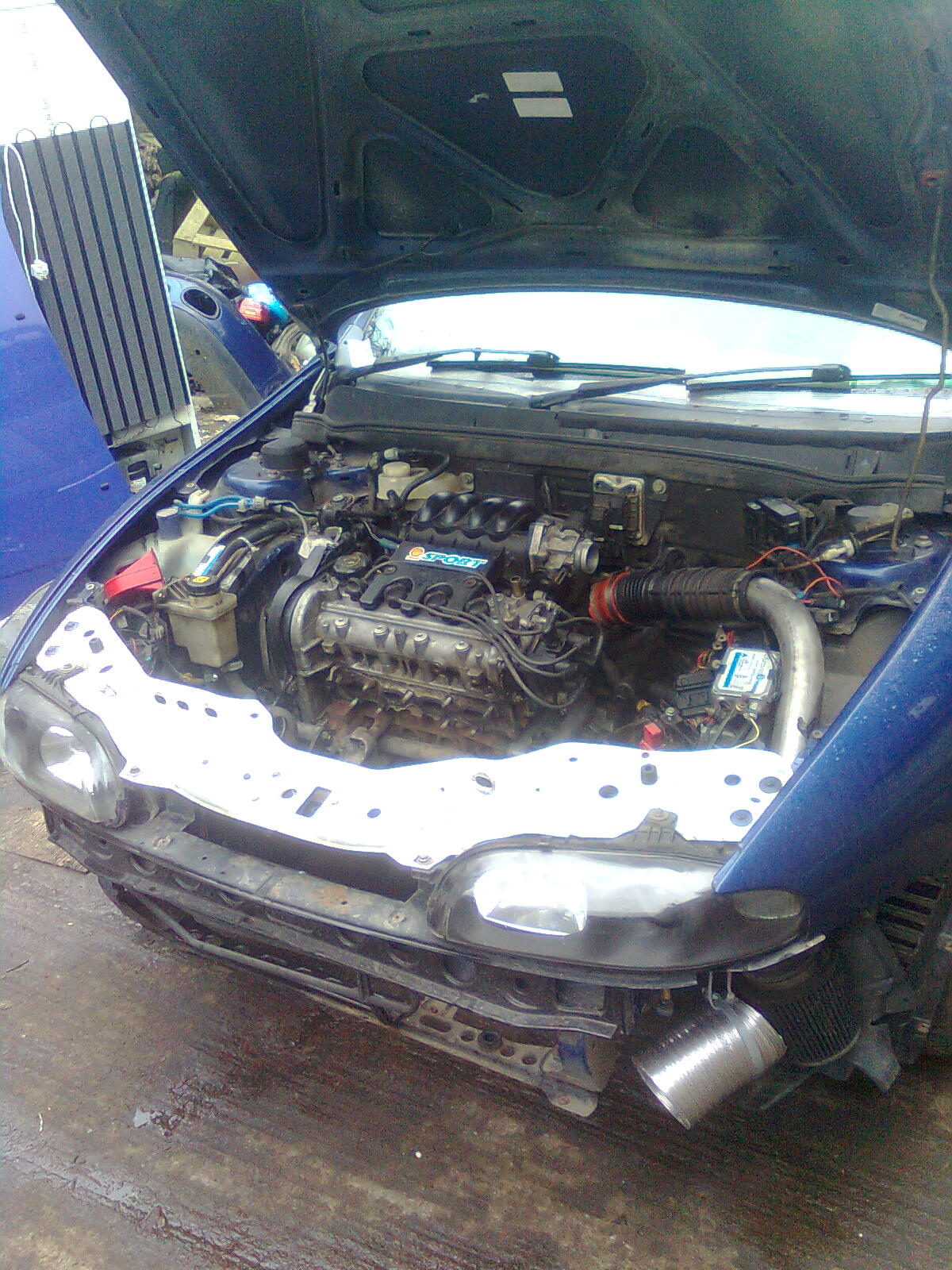

Fun was short lived! A nasty running issue of the past came back and bit me in the ar...m :p
So I decided it was one of 2 things:
First were these relays
Acquired another set courtesy of my old car and cleaned them up well (one done in the pic!)
But it didn't cure it! :bang:
Plan b, disconnected the oxy sensor. Sorted! Long test drive, faultless!

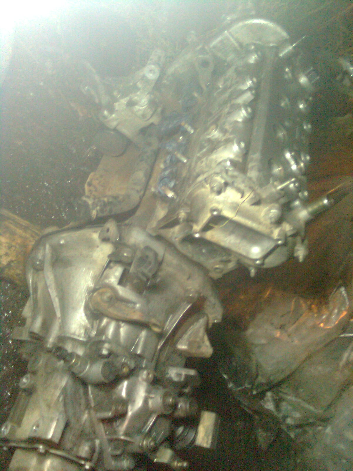

Finally, here's the current setup. Cat + standard camshafts + 5 speed box. Compare it to the other vid in an earlier post, there is a very noticeable difference

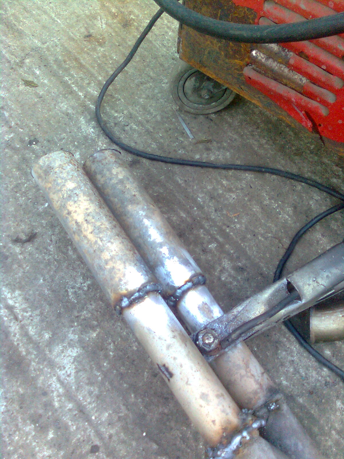

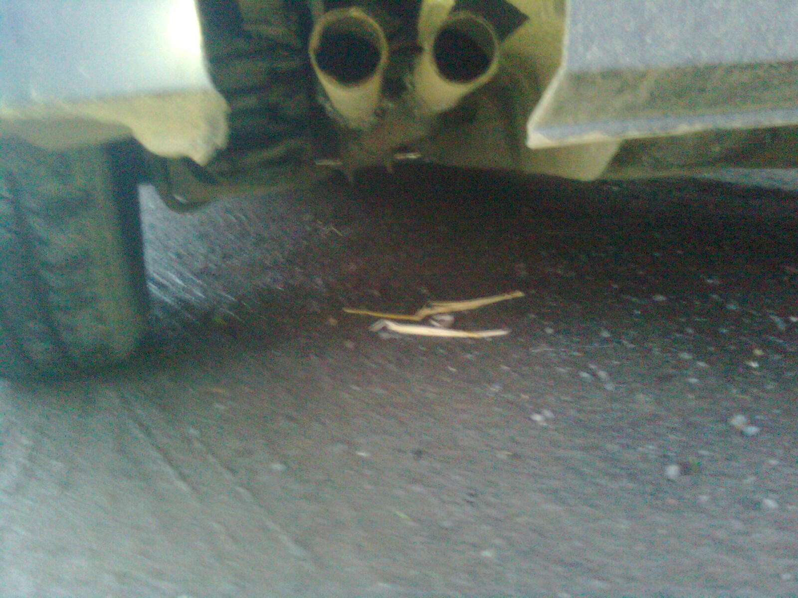

First, here's those twin pipes

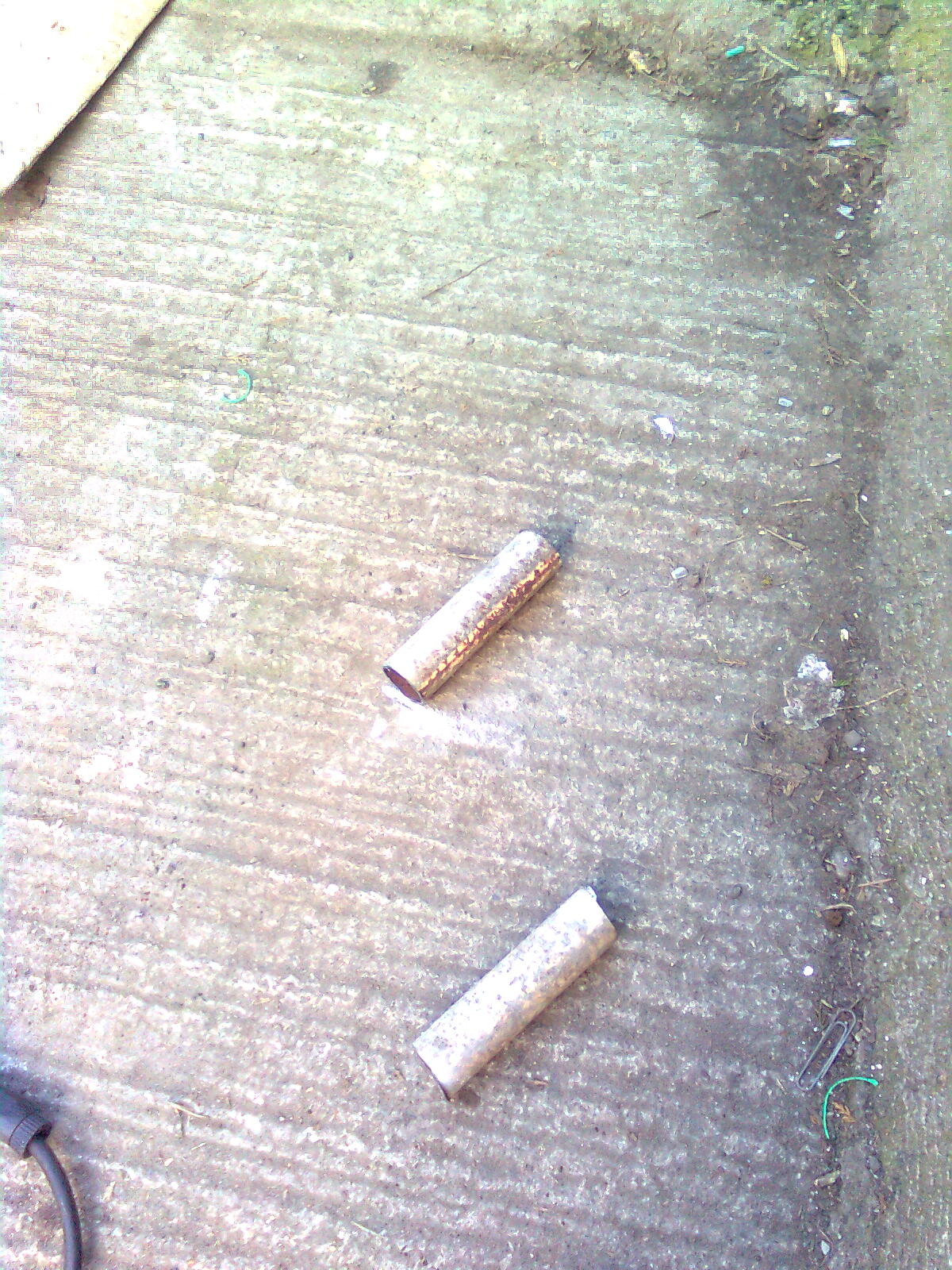

My plan was to extend them using...
Alas, too small of bore! Out with my favourite toy of all time and some pipe :worship:
Perfect (y)
It's fair to say, the welding has improved
I think... ;)

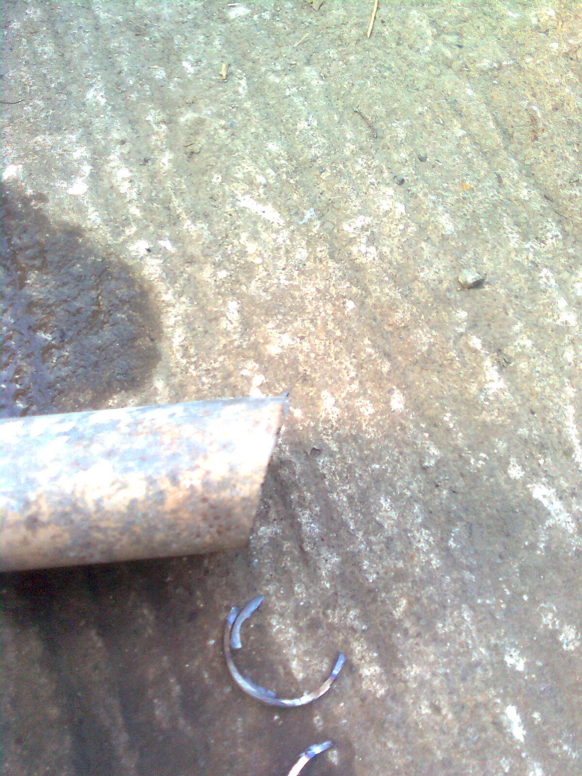

Time to test fit
Next, slash cut
Followed by a good cleaning

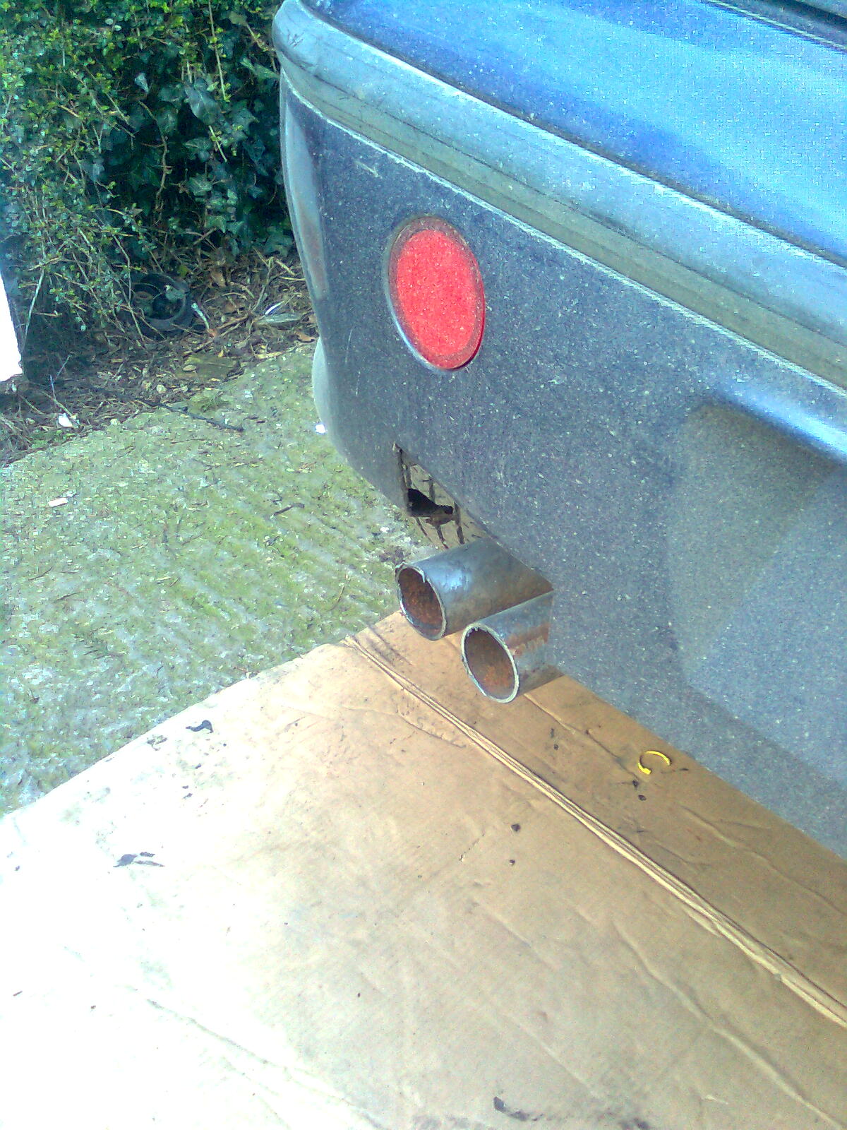

Refitted
Looks much better :cool:

I also suck at welding only ever stick welded .. but I put the angle grinder to work after.. so they look ok; so should you.
I think the amperage was to low on your welds .. that will mean the weld is on top of the pipes rather than between them.
I told you: Do not cut the back bumper (or something like that).That square hole for a round pipe looks awful.
Do some thing about it .. you have a lot of bumpers and I believe you still have a lot of paint, + you have a place to work on it .

Stick welder would just burns through these light pipes. I've tried ;)
Practicing on an amp rating of 2 and a slightly higher wire speed, it burned through the pipe :eek: These aint new pipes, just old stuff lying about. The sleve piece is from bits of a E34 exhaust, 2-1 piece is from the vectra downpipe, 2 pipes mated to it are from the blue fiesta and the extended pipes are more of the vectra ;)
Essentially, what I have is a decent alternative to a new back section. Not spending €205 + vat for a new backbox, that costs more than the car did! :eek:
Bumper was shabby, I hacked it anyway due to the amount of spare bumpers about as a styling excersise... I'll tidy it in due time ;)
So up the wire speed a tad more and move the torch faster :p :p From the pics it does look like Aurick is right. The weld is not molten "into" the metal, it's just lying on top. And that makes it brickwork, not welding. (Don't get me wrong, I am not much of a welder myself but I now a "could be better" weld when I see one. Exhaust pipe is just very hard to weld without melting holes in it)
You could easily stick weld it, you just need very fine electrodes. The normal ones are too big and require too much current.
It survived the drop test (drop from roof of house) and it isn't a load bearing part. It's surviving well so far.
I must get some high resolution pictures of it next time its off but I'm very pleased with it as opposed to by previous shambolic attempts at welding :p
