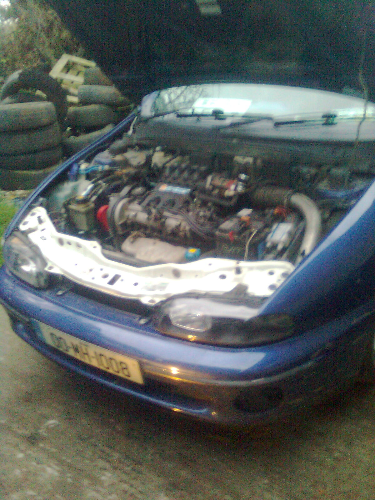

Heres the replacement for my highly abused yet extremely reliable Bravo.... Another Bravo (y) I'm moving up a year here :D Not going to be bitten like the last time, this is going to have a strip down and re-rustproof with a few bits to be thrown in too (copper lines all round are in the plans). Most importantly, this car is going to be converted to a van and painted black with some "toys" installed... More pics soon! :)

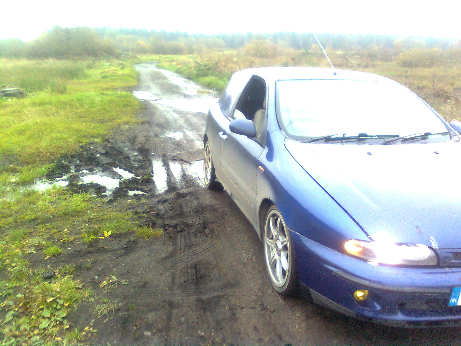

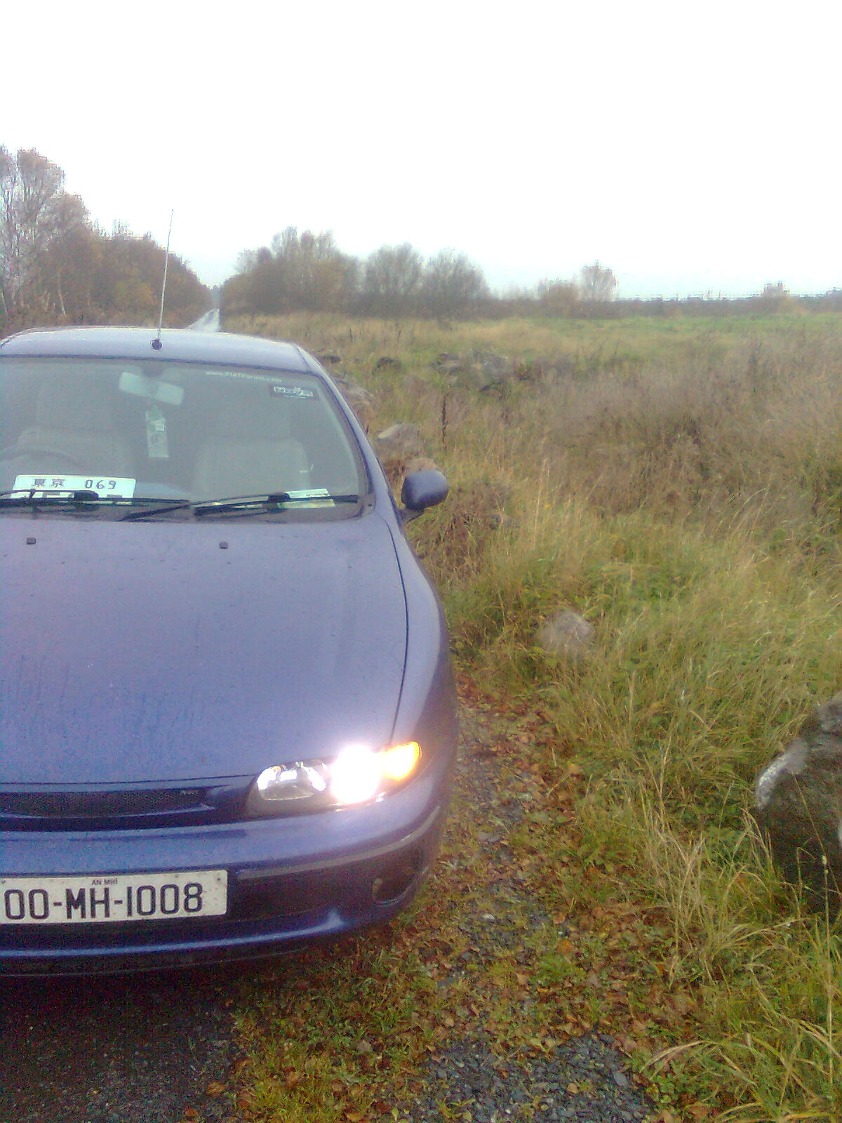

Over here, we have been having quite dreary, miserable, drizzly crap weather. So for no reason I decided to drive through some of Meath's worst roads :eek:
It may be straight, but very, very bumpy. Sudden rises and dips
I'll let the picture speak here...
And a bit further down...
Slight colour conditioning for effect.... ;)
This county is supposed to have some of the best roads in the country :rolleyes:

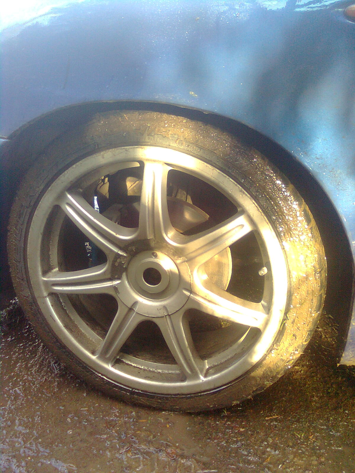

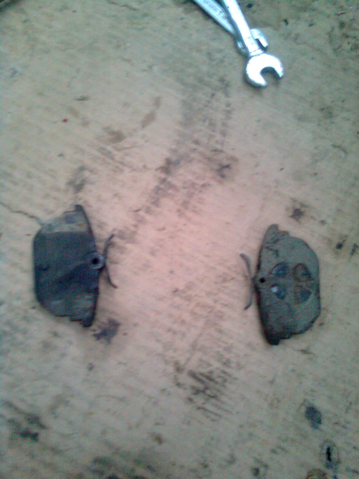

Now to a more sinister problem, sticky caliper...
Stupid lucas crap! :bang:
To take it off, hold the 15mm nut on the slider and loosen the outside wit a 13mm spanner
Out the pads go :)
And muchos cleaned up (y)
