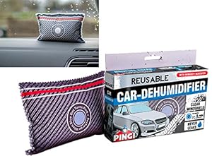

I had the same issue with my bravo, in the end i brought a re-useable dehumidifier which I first placed near the screen i still had the same problem, so I decide the move the dehumidifier near the hand brake , and opened all my windows in my car and drove for around 10mins to allow any wet areas in my car dry up.
After I shut all the windows and put the heating system on full level 4 setting for around 30mins, and carry on using the dehumidifier the problem has gone I don't get streamed up windows.
This is the one I have: Once the spot on the dehumidifier turns dark blue place in the microwave and heat up for 5mins I think and re use.
I brought this from Asda.
