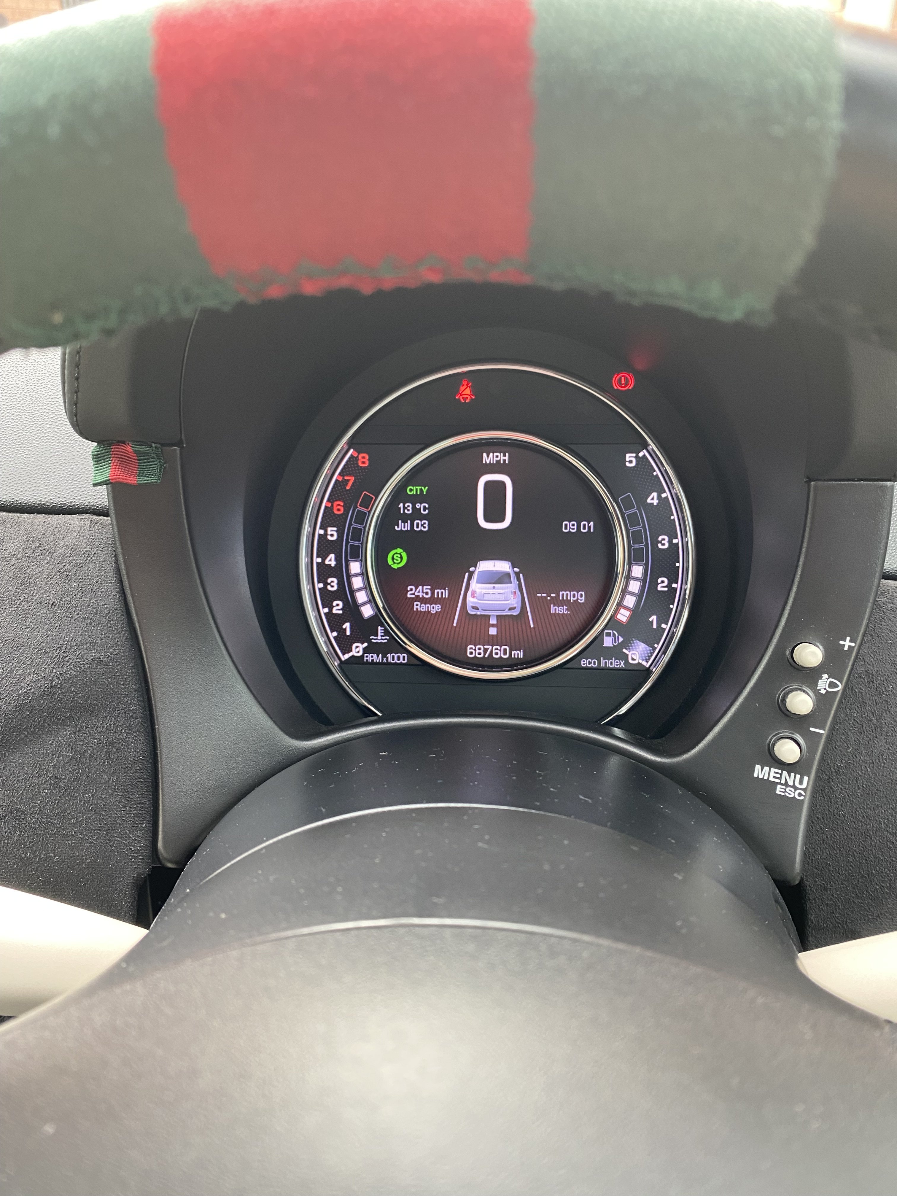

Well all you need to do is find a digital speedo with lower mileage than the car …. And one that is up to 2015!! do not even entertain a 2016 as it is not compatible!
MES will allow you to set the correct mileage and a proxi will write the data to the new digital TFT unit
Just one plug to remove on the rear! I’ve included a pic of mine! Much neater!!
Swapped mine 2/3 years ago no issues at all

Thanks so much for the advice, that's amazing! I've noticed some advertised for the Abarth on e-bay, would I be right in thinking as long as they are 2014/15 then they would be ok too?
They would but you will have the Abarth logo pop up when you get into the car rather than the 500 logo
There will be a few other little things too that are Abarth only but if your not that bothered it’s up to you
Personally id stick to a 500 one
The car decides if the Abarth logo is shown or the regular 500 logo. There are no specific Abarth or regular 500 TFT screens.
When you look at the Hexadecimal string for the Proxi-alignment, you will find that for Abarth models, byte 80=02, byte 81=51, 129 = 80 and 130 = 05.
For the 500, those values will be different. Thats how the TFT knows which logo to show.
Apart from that, value of byte 65 will change the layout of the TFT.
00 = Pop
20 = Lounge
40 = cars with turbo
60 = Abarth

Thanks. Silly question but does anyone know what the values would be for a 500s? I'll have a dig around though.

Yes I’d forgotten about that .. I changed mine to a sport the original had a crappy stretched font
I think "00" for byte 65 is actually Pop/Lounge and "20" is Sport.
I've been scraping Fiat forums for those MES Hex strings. I'm trying to map the bytes to settings, but so far I have only 10.
So to everyone who happens to have a string, let me know :). Please provide as many information as you can. (engine, gearbox, navigation, convertible yes/no, carplay, blue&me...)
I have set it to to "60" (Abarth) although I have a 500 Lounge because it has the Sport mode. (I configured the City button to be a Sport button, making the car more lively)
