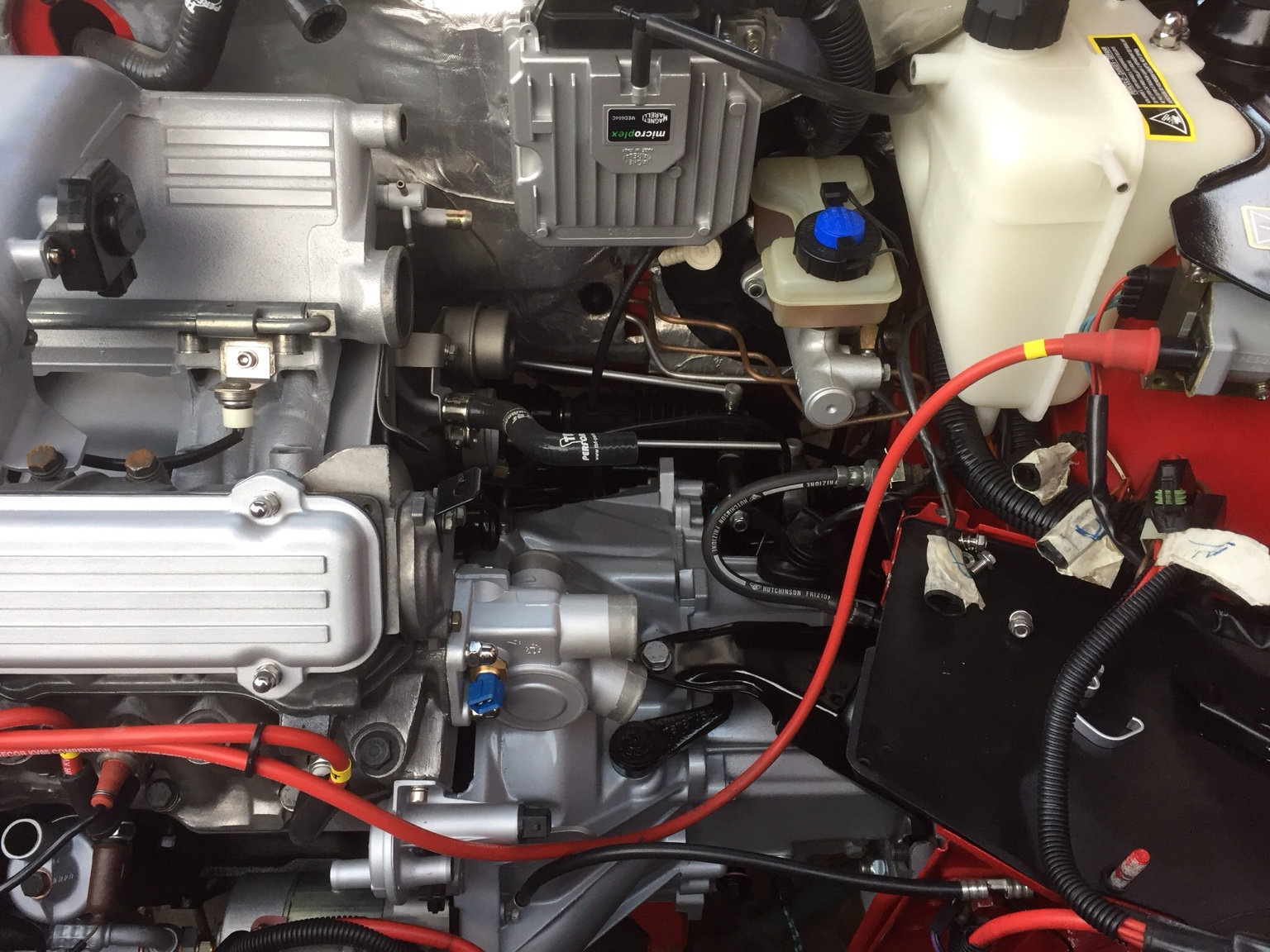

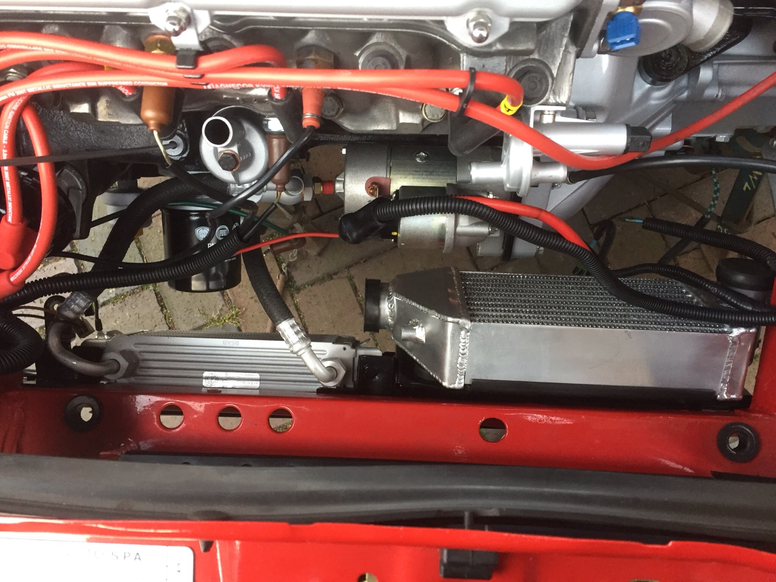

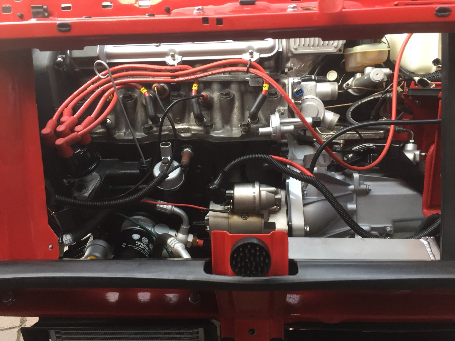

Engine in ! , it was a tight fit , lifted the front of the car with my engine hoist and pushed the engine ( which was on a bread trolley ) underneath then dropped the car over the engine . Then hooked up the engine to the hoist and lifted it into position . There were some bumps and scrapes but nothing too major , I was worrying about refitting it a lot but overall it wasn't too bad at all . Now just got to hook it all up .
You must have a photographic memory to remember where everything goes , any idea how long it will be before the startup ?
Don't know how long to go Steve , I've got to buy and fit a new stainless exhaust which will probably be in the new year now , weather permitting ?, as for knowing where everything goes I've taken loads of pics when I dismantled it , the internet , Haynes manual and good old fashioned luck [emoji4] also I have another grey uno turbo in a lockup I can reference if I need
Absolutely fantastic job, looks just like a brand new car,with so little space to work how do you manage to get your hands in to connect things up ?????
Yes it's a bit tight , I tried to put everything on the engine as I possibly could before I put it in the car , the worst things were the heater pipes that go inside the bulkhead to the heater matrix and the alternator was a pain , I had to take the intermediate shaft off just to get it into place and knackerd my arm up , but it's all in place now

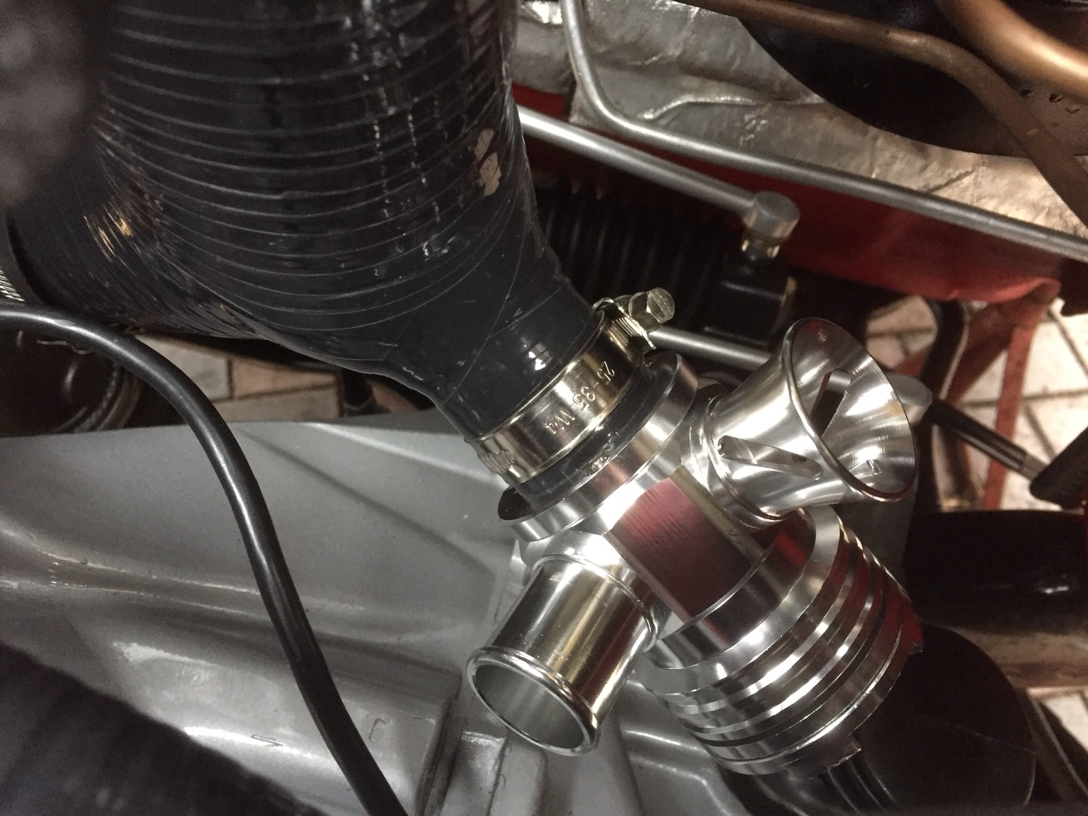

I decided to go with a Forge splitter dump valve which I think is a relatively new style valve and can be set in 3 different modes
1 standard recirculating
2 fully open ( dump valve whooosh )
3 both operating
The one I chose was originally for seat and vw's but has exactly the same size openings as the uno turbo's , luckily
