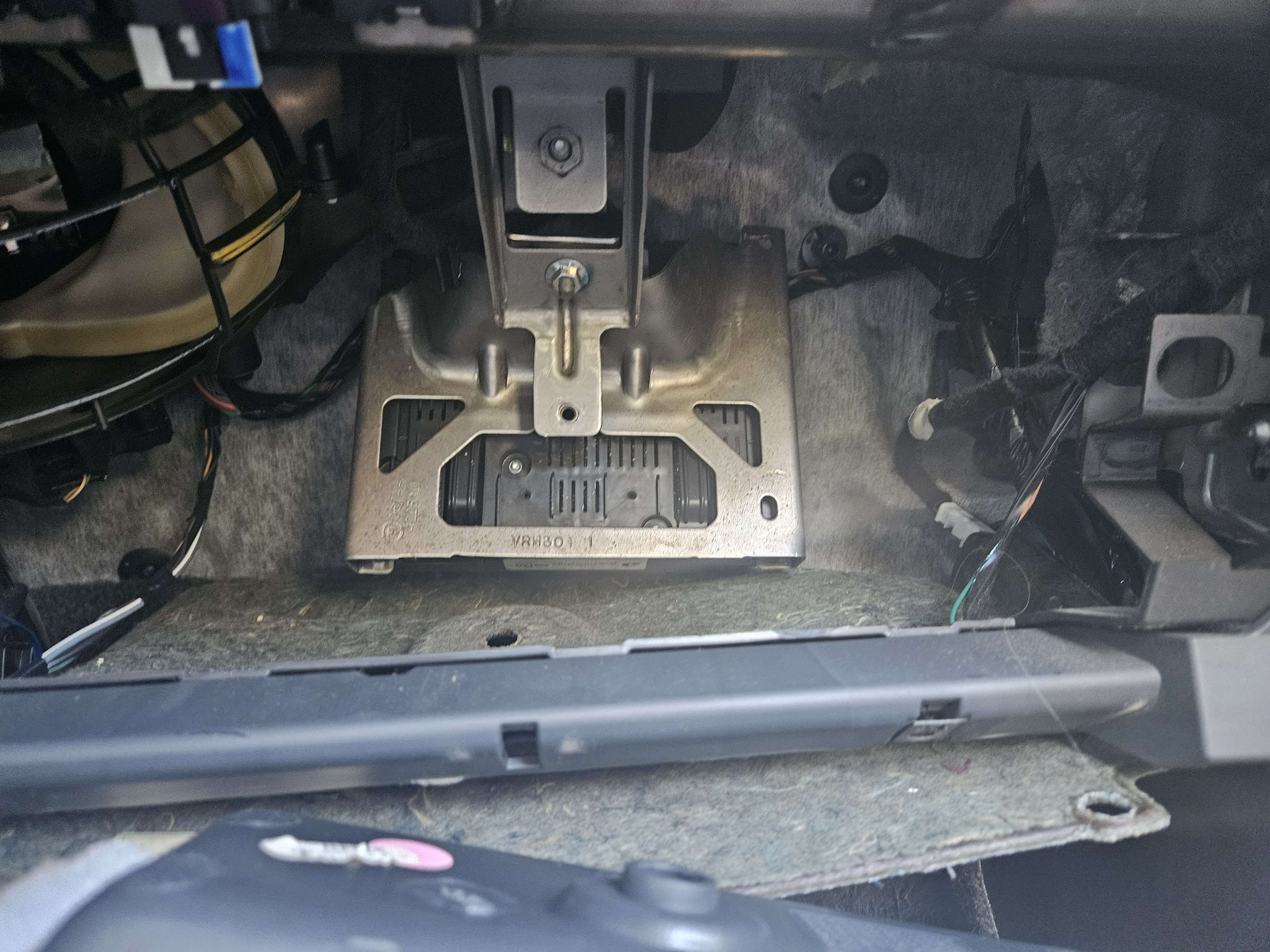

Hey yall, I've had what I believe to be a parasitic drain on my battery from my now defunct blue & me module. Odometer started flashing and since then, my blue and me stopped working and battery died, I even installed a brand new one and the replacement died over night, with the odometer flashing still. Took it to a shop and they couldn't find issues with battery/connection/spark plugs etc.
I am looking to get my blue and repaired or replaced, however we are not able to locate the darn thing. We checked inside the wall by the speakers of both back driver and back passenger side; no cage no box, nothing there.
It's a 2 door, hatchback, 2014 Fiat pop 500
Where else could it be? Tried looking at all my paperwork and booklets and nothing seems to have a diagram of where this would be installed.

The UK model is in the back on the left hand side behind the trim. I seem to recall reading that the US spec is in the front in front of the door, but don't remember which side

I did not think to check for US vs UK etc. Let me see if we can check behind the glovebox shortly. Fingers crossed

HUZZA! Thank you so much, it was behind the glove box!
Now to remove it and decide where to send it to repair it/refurbish.
