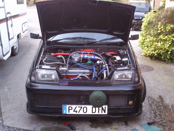

Here is the new engine spec used to achieve this goal -
Punto 75 engine
Garrett GT1752 turbo 0.47 turbine/053 compressor (mated with my GT15 bearing housing using the GT17 shaft etc)
2" turbo back exhaust
Aquamist MF2
75 inlet manifold mated with tricker 40mm TB with standard SPI injecotor controlled by stock ecu for off boost fueling.
4 volvo MPI injecotors controlled by the MF2 for "on boost MPI" fueling.
75 cam and head (ported)
Adjustable cam pulley
Externally mounted HKS mushroom air filter
GT turbo intercooler
Mandral bend boost pipes
Splitfire 8MM h/t leads and EON1 plugs
Greddy boost controller
Turbosmart fuel cut defender
1.5mm Copper decomp plate (exactly 8.5:1 c/r)
Payen head gasket

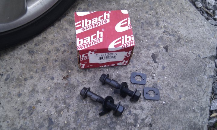

Soooooo, what ive done is invested in some Eibach camber bolts that will give upto 1.5 degrees negative camber to give more traction while cornering and hopefully this will massilvly help the tyre put the torque down better on exit, but then centos lean far to much from the rear loading up the tyre in action and giving guhe understeer etc.So to combat this ive also gone for a Rally Designs rear anti-roll bar kit which includes a roll bar, weldable mounts, polyurathane bushes and knife blade arms with threads on the end for rose jointed drop links.

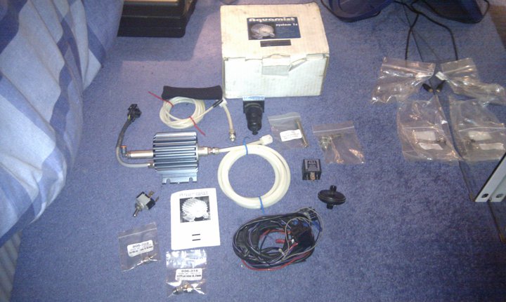

Right.....now onto the engine, 160bhp is a lot from the small bugger so keeping things safe is a new priority so ive bought an Aquamaist Methonal/water injection kit which will be going on soon to combat the inlet and charge temps aswell as exhaust temps reducing the chance of DET massivley along with my J and S ultra safe gaurd ingnition controller which works of off a knock sensor on the rear of the engine retarding timing on knock or at a set point etc.
ill pop some pics up tomorow!

anyway here are the latest pics of the car -
thanks
The head (75 head) has been ported on the inlet side along with the manifold to match, runs the standard valves,springs cam etc.
