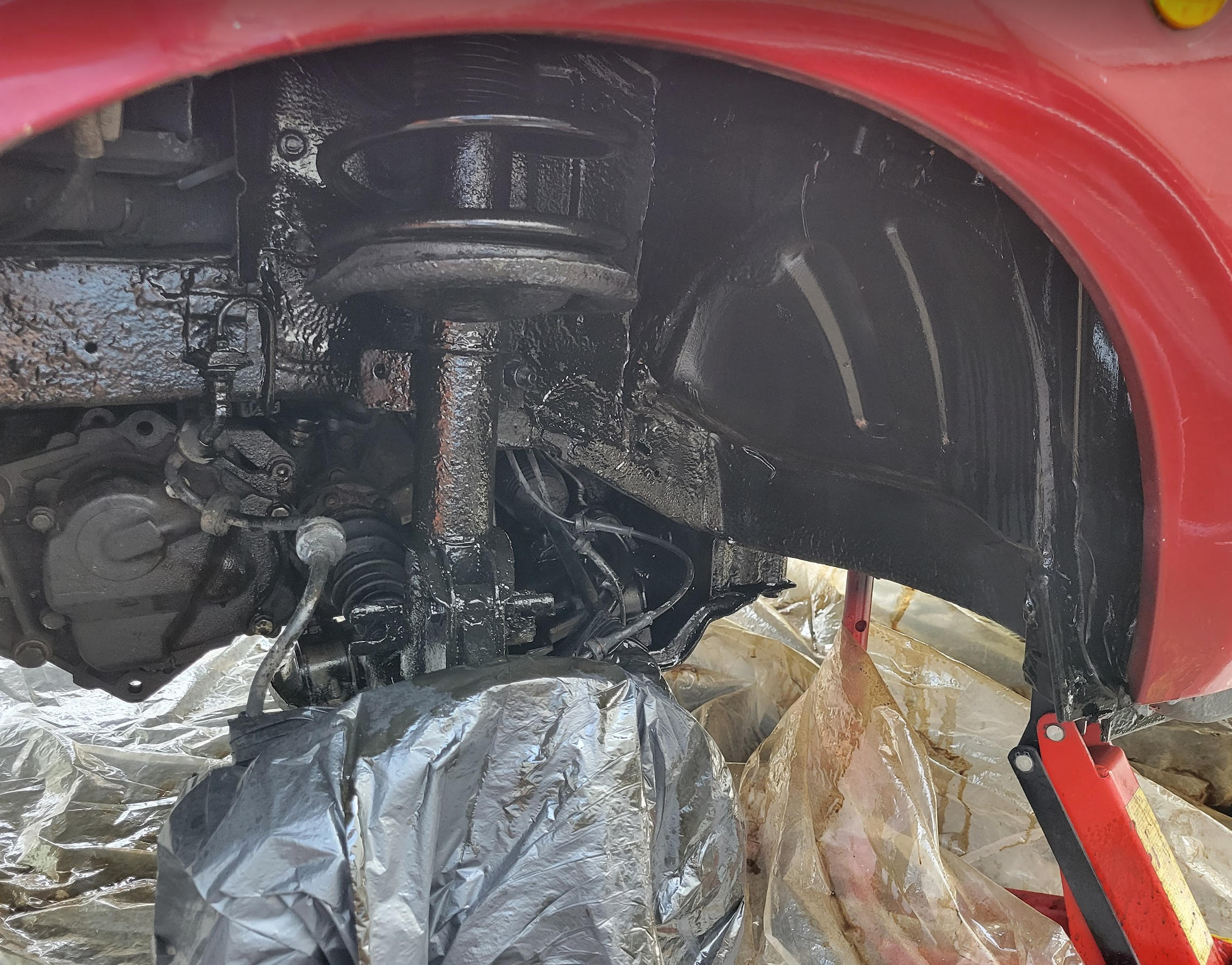

Used dinitrol 3125 ml yesterday. It is messy but i am happy. I really seeps in.
Used air compressor.
Plastic disposable sheets under for the mess.
Bought 3 x1l cans and shultz gun and wand for 68 quid. Used 2.5 litres.
Some brushed on to save masking cills.
Should have covered exhaust in hind sight. You tuber used tin foil.
It was all clean and dry before hand. Took about 4 hours with cleaning up and learning time. Very very hot day. Paper overhalls would have been too hot. Disposed of old t-shirt I was wearing.
Need to tape up or seal somehow holes where tape taken off internal sections. Bitumen flashband I think.
Want to do doors also

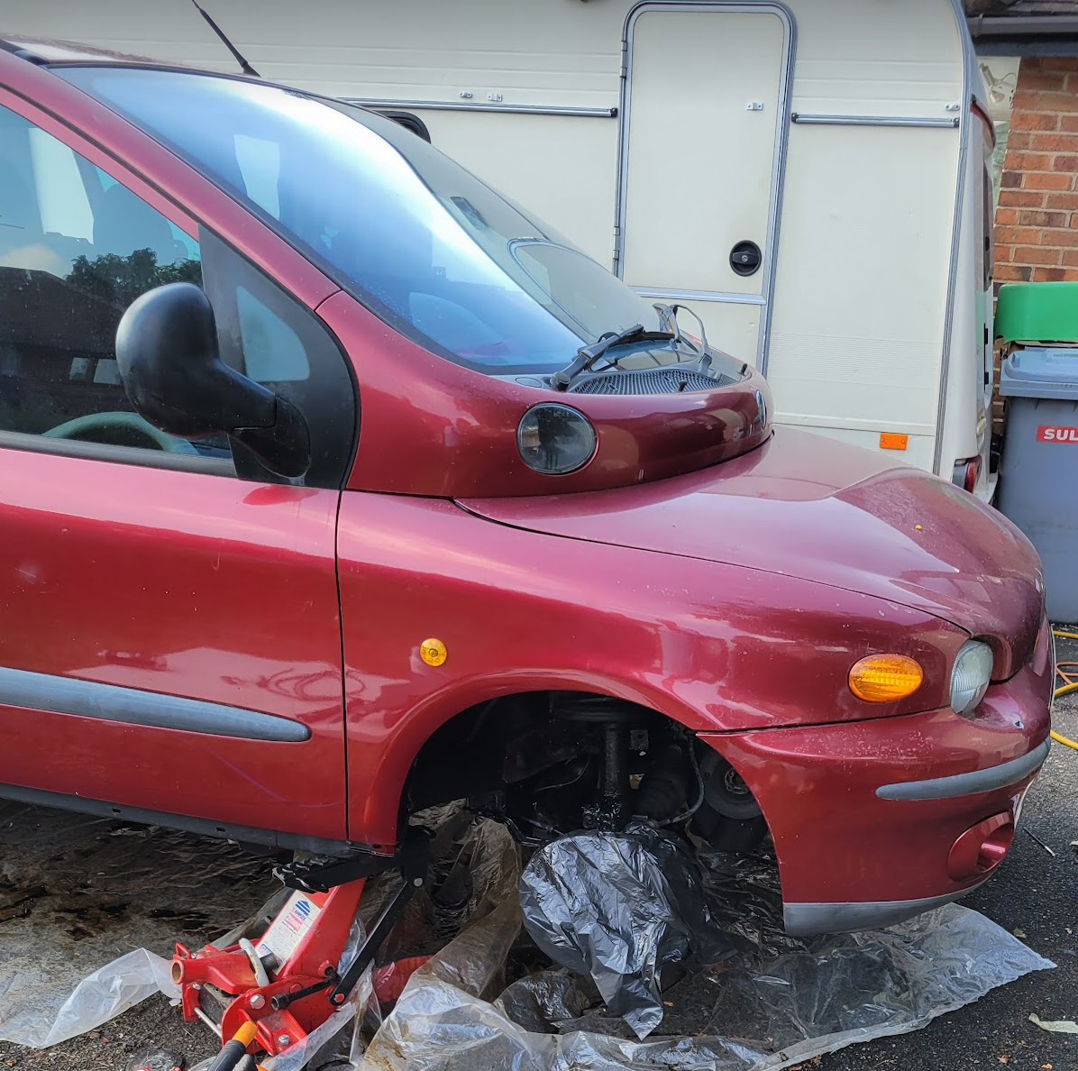

Some pickies. Feel much better now she has been mostly protected.
Need to do inside doors, boot lid and bonnet cavities yet and seal the box sections under the car.
