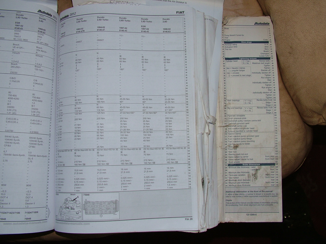

Is this your model?

Where there is a line drawn through then there is no torque figure given.
What age is your Ducato as the 210 figure is only 142 on up to roughly 1996 ish.
Built in 1997.
I can not ready the Legend in the right side. It's top blurry.
Could it be row 125: Brake caliper to Carrier? Then there ist no Torque given in the table?
Built in 1997.
Yes row 125 no torque figure, I checked in an older book also.
