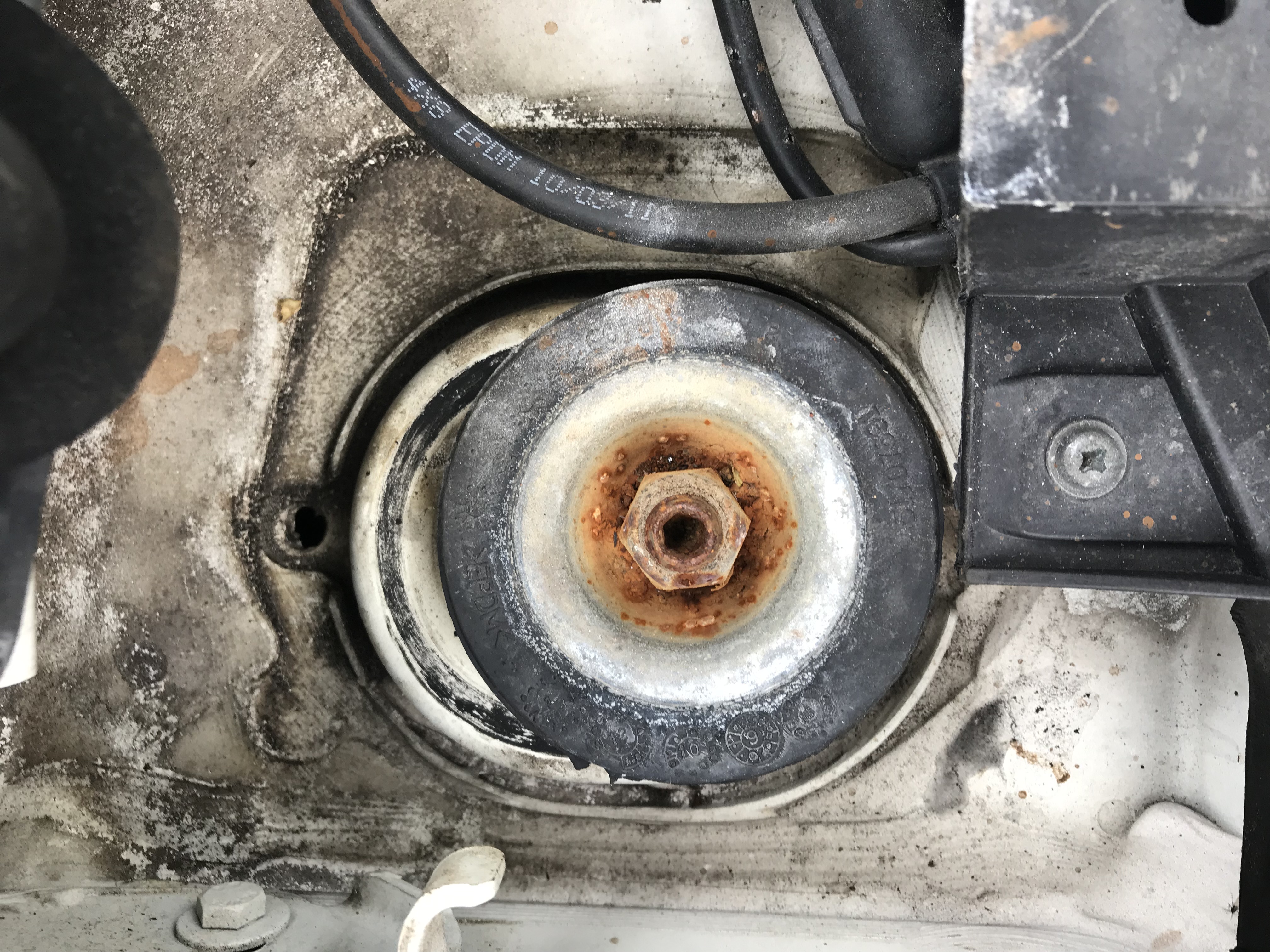

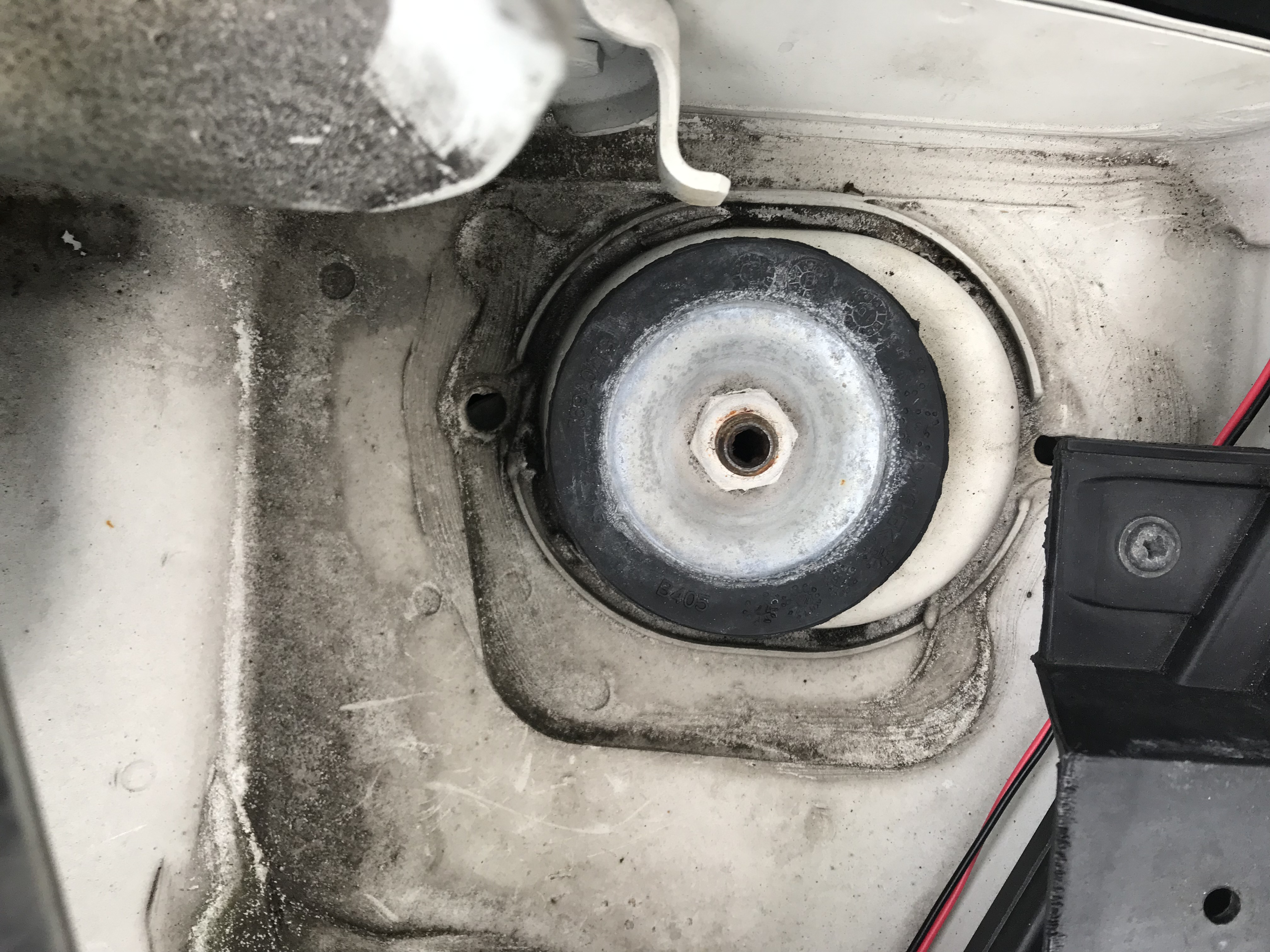

My top mounts are in different positions, is this correct?
Thanks steve
So they should be both leaning the same way? What’s back to front? The lower mount?
If you look at the guide I did on replacing the strut you'll see the metal spring cup tag must face outwards, the bit I think is wrong with yours is the top rubber bush with the arrow on is pointing the wrong way ie forward it needs turning round so the strut will need to be dropped out/down again, the rusty one looks right ie mostly to the rear.
