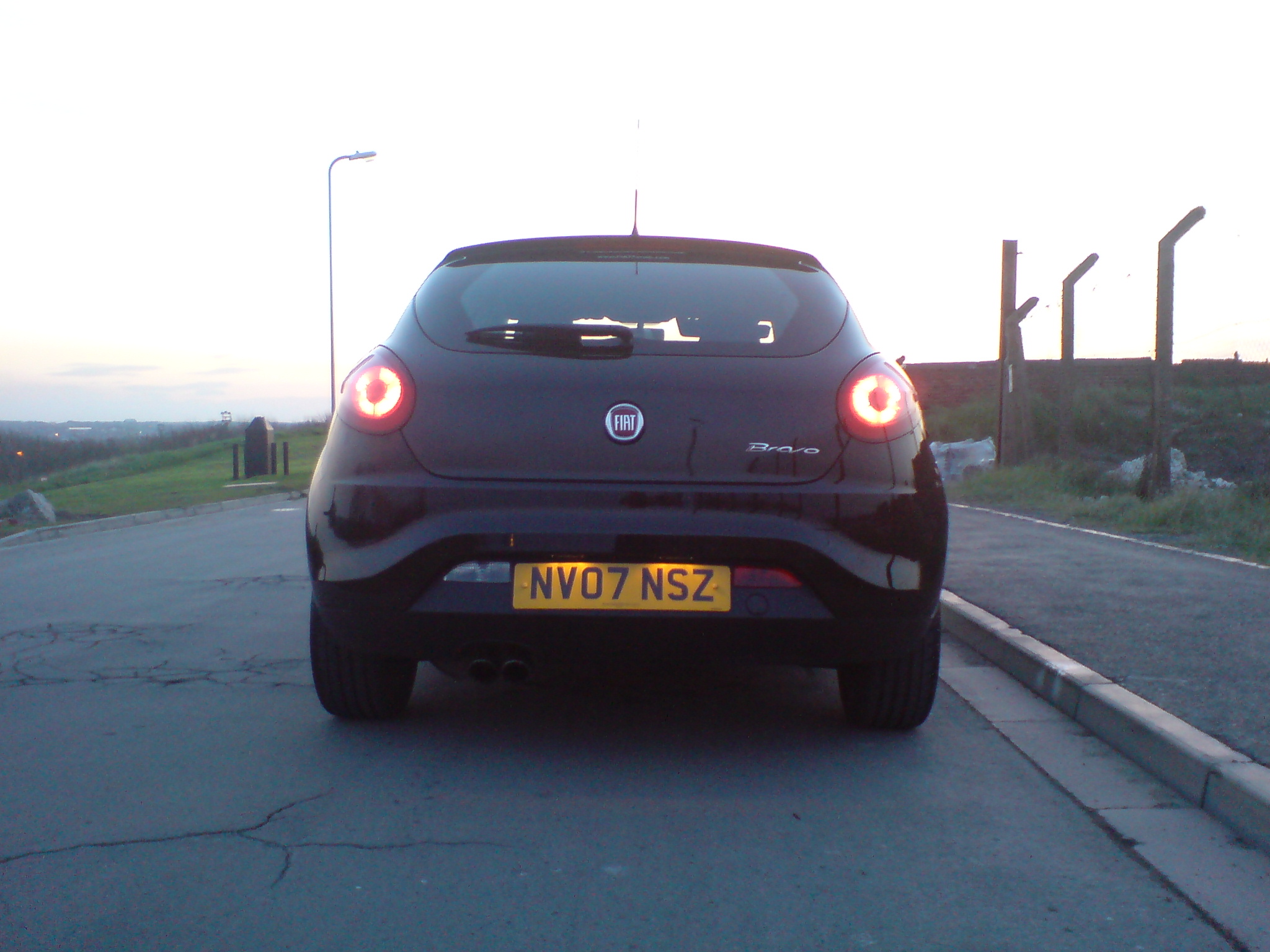

Guys the easiest way to tell if your car has DPF is :
On DPF cars the tailpipe will point straight out and will be clean inside (no black soot) as the job of the DPF is to collect any soot passing through.
On Non DPF cars the tailpipe will point down to the ground to direct any smoke to the ground.
If you have a DPF car with a tuning box or re-map and you're getting smoke from the exhaust you are in for problems guaranteed.
Cheers (y)
Cheers (y)
I missed this when it was posted...
Not perfectly clear, but that(them) exhaust(s) I'm sure points straight out the back.
