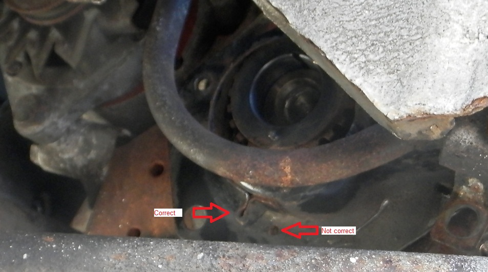

But like you I cannot get Cam, Pump and Crank aligned to the marks, Cam and Pump are fine, but crank seems to be advanced slightly (my crank fan pulley has a hole drilled, with a matching hole in the metal cover... and a matching lug about 5 degrees or so clockwise from the hole. The lug (also with a hole) is (I think) where the timing should align.
This puts the engine too far advanced - that "Transit" sound, and underpowered when the wind is against you and revs are low.

Got there in the end!
First to answer - nope both belts were 153, and same length within the bounds of possibility to measure.
However when I used mark A, it now lines up, and the engine is back to her good old self.
So when you set you may find it challenging to line up until the belt has done a few miles (perhaps a tiny stretch / bedding in?)

Check your alignment, pump 6pm drill bit aligns, cam 12 o'clock and crank pulley mark at about 26/ 27 minutes to the hour - between 6 and 7 o'clock (mark A above).

New Gates belts are tough enough to make it look more correct to align the markings with Cam 12 O'Clock, Pump 6 O'Clock and Crank 6 O'clock - its that crank mark that is all critical, just past 6 pm.

Crank, with fan pulley in place, there should be a 5 - 6 mm hole when a drill is inserted, with luck it should fit into the hole in the bent piece of metal. Mine is too bent to allow a drill bit, so a sensible guess was necessary.

And for you guys, I have much to thank for. I have been searching so much for this information, although I have a Renault Master T35 -98 with a S9w-702 2.8 engine that is probably the same as yours. Provided is the missing crank shaft photo... Hope this helps someone in future.
