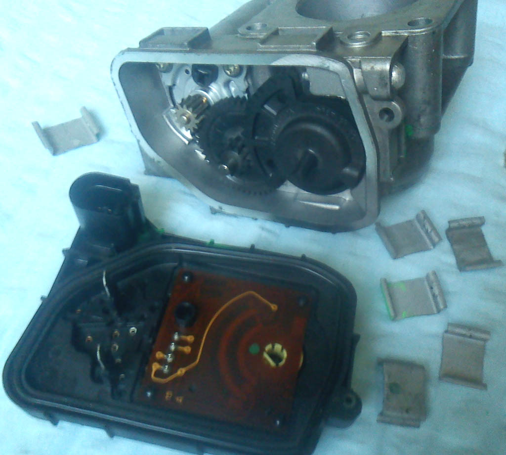

1. ThrottlePositionSensor is located in the plastic cover. Remove 6 metal clips and you're in.

10. TPS is a simple thing. Just 2 "pots" in parallel connection. They work in opposite directions, that means one is increasing other decreasing in resistance when flap is moving. That's it.
Throttle pinout is stamped (molded) inside the connector.
