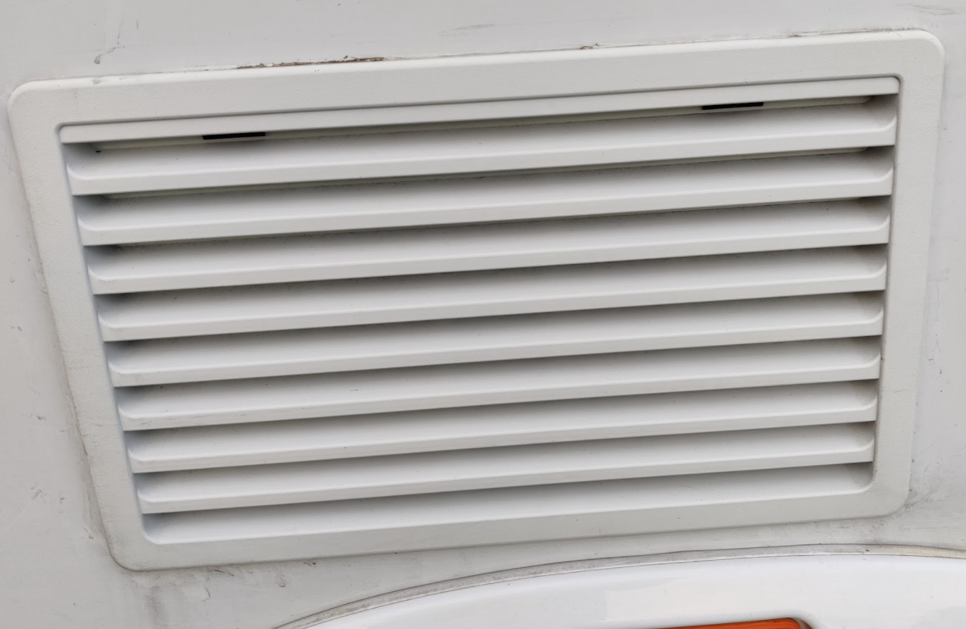

This is the bottom outside access panel for the fridge: any thoughts on how to remove it, it seems to be clipped on an inner piece which is screwed and siliconed to the van, but no slots to insert a screwdriver or similar.
Any thoughts?

Apart from making sure that vent is not blocked and you can feel warm air coming out of it when fridge working I don't think prising the cover off outside will do much good,

100% re the risks etc so just want to look, there is no viewing from the front i.e. from inside the van so need to look at it from outside.
I have a borescope which may fit through the slots in the grill.

I may be behind mistaken, but I thought that most fridge grilles were removeable.

On some installations there are two of these vents one top and one bottom. I f I remember right they are fixed from inside making the wall a sandwich and held by 4 or 6 self tappers.

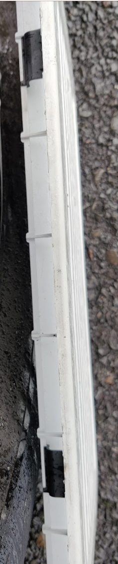

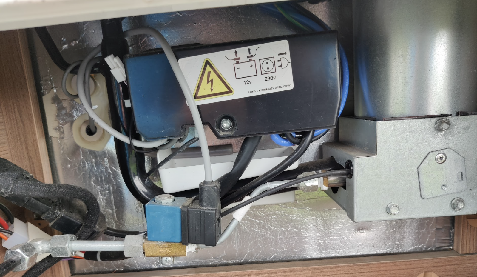

No access from the front of the fridge, succeeded in getting off the bottom vent cover, the two black clips shown below, which are on top, slide sideways and it is suppose to hinge down but all 4 hinges have been broken, hence the silicone. The second picture show all I need to see, so will explore this once the rain stops
So took out the three hex head screws visible in the bottom right, exposing the burner and the ignition system, all looked shiny and clean so turned on the gas and it worked, so am none the wiser.
Want to correct the post above about the grill, on closer examination and hashing cleaned off the silicone, the bottom has 4 protrusions that slip up underneath similar on the frame on the van and hold it in place so very easy to remove it, as long as its not siliconed up, will take off the top one tomorrow

How to remove the outside grill, If you look at the top of the grill you will see two BLACK sliders, just move them to one side and this will release the grill cover.
