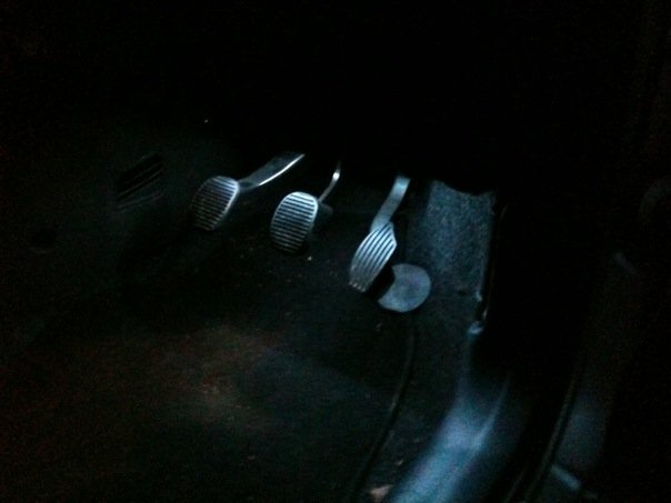

basically its a very simple thing to do. the lights will have to be stuck on as there is nothing to cable tie them to just plastic covers, so you will need some strong sticky stuff lol, unless you want to drill a couple of holes to hold them on. My lights came with a full backing of sticky to attach them with. Get the lights and 2 lengths of twin core wire. Run the wire from the interior light along the headling to the A pillar, pull the door seal off and tuck the wire down the inside of it,and into the footwell. The passenger side light can be connected up now and the wire tucked just behind the carpet.
The drivers side wire now has to be run under the carpet round the back of the footwell through the centre console just infront of the gearstick (only place i could see through that fits a wire). Connect the drivers side lights up, theres a little piece of trim just above the pedals that the wires can be tucked up into neatly.
now you can connect the wires to the interior light, (may be different on yours as i have factory fit alarm) pull the grey cover of (requires abit of force) there is now 2 torx screws to undo to get the actual light out. you can now connect the wires to the bulb holder (the middle one that comes on when you open the door) making sure you get negative and positive correct (depending on what lights you got LED's neg and pos have to be correct)
test put it back together and your done. hope all that made sense :D

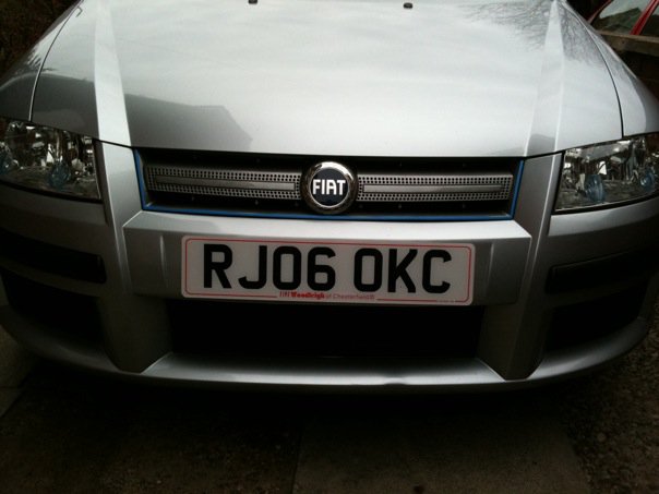

had a little idea of something that will tie in with my blue and silver theme (thats not quite got going yet :eek:)
if i do it, it will be matched to fiat badge but not got any blue tape that colour lol
what you think?
