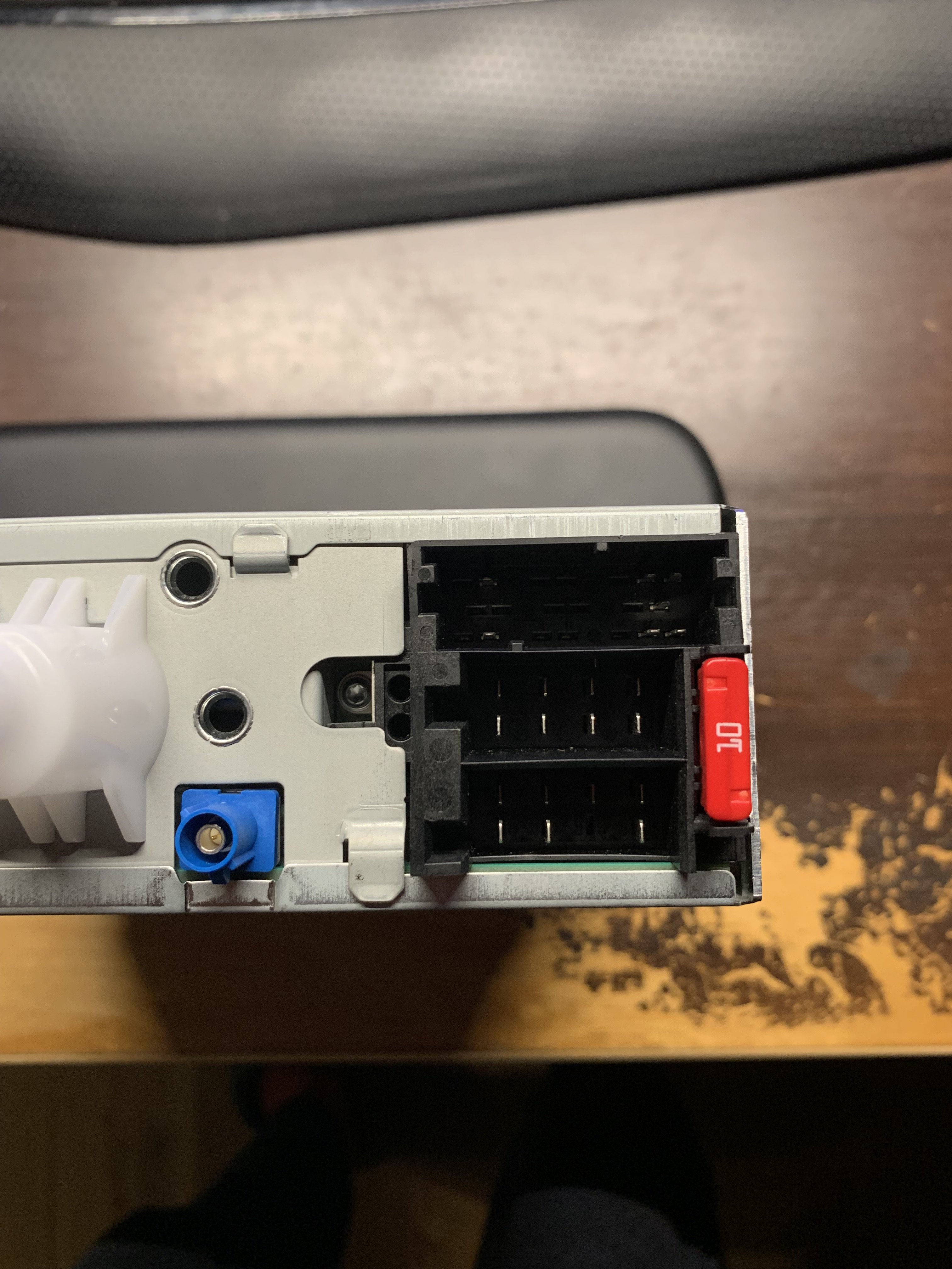

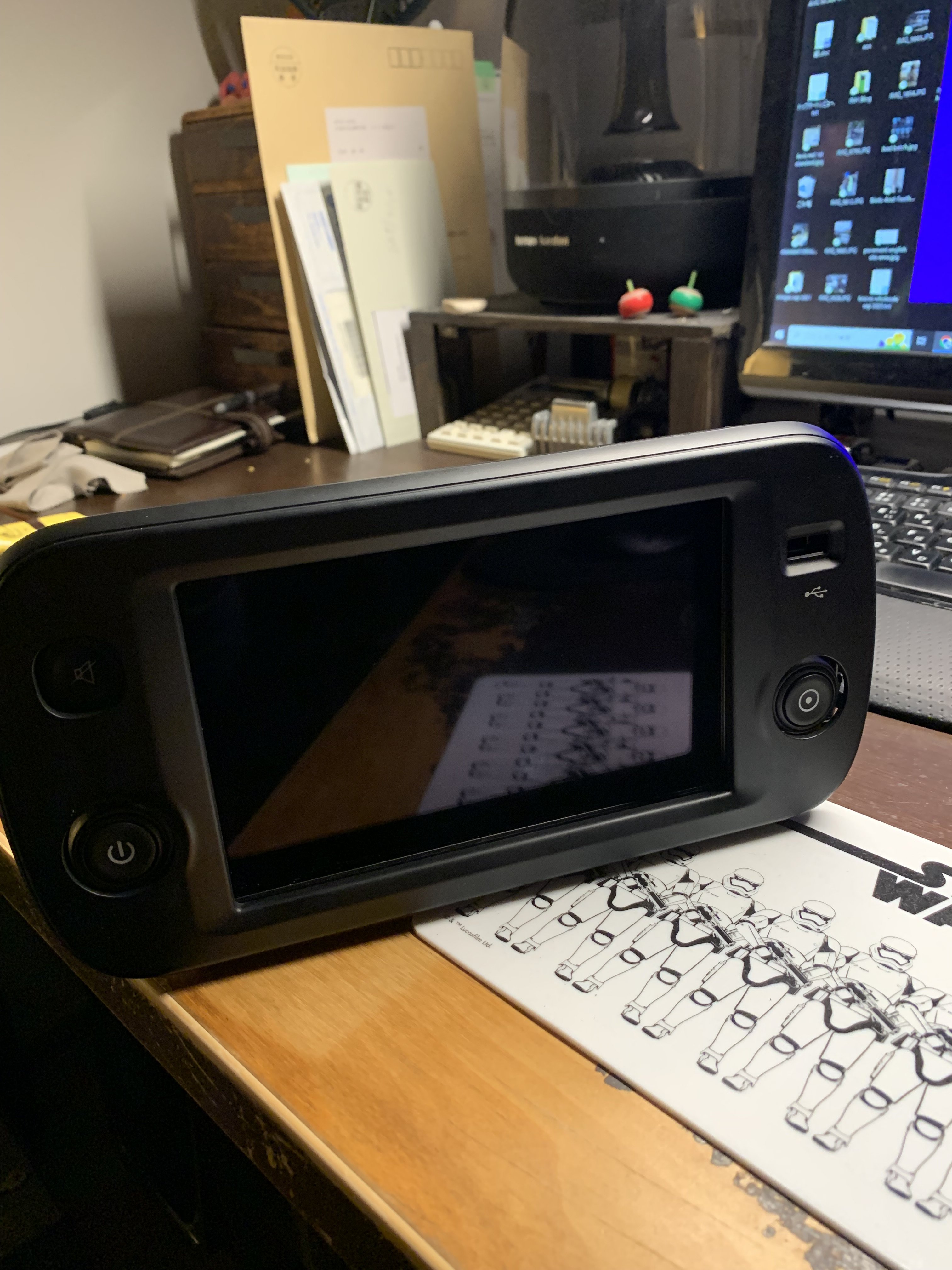

I have a panda manufactured in 2023 with a uconnect 5” non touchscreen radio shown in 1st and 2nd image and want to change it to a uconnect 7” touchscreen one (3,4,5th image).
They both look very similar at first glance and in fact the base unit is the same 1 din style so it can physically be straight swapped but the connectors are completely different. The 5” non touchscreen one has green and blue square shaped connectors and the 7” touchscreen one has totally different ones.
I would greatly appreciate if anyone who has done this could share some info on this.

Beware, as covered in other posts, a factory radio removed from one Panda will not work in another, as they are tied to the specific security information stored in the original car’s body control computer. So, unless you pay a Fiat dealer a handsome sum to reconfigure the security coding, it’s unlike to work. (The security gateway cannot be reset by third party software)

Ah. I was planning same as you. I thought that connector of 5 and 7 are the same. I was shocked a little about this information.

I was the same on the connectors till I saw it! I don’t know when Fiat changes the wiring or it’s been always like that. It’s very frustrating as there is little information about it.
Removing the connect5 is pretty simple. The front cover is fitted with four brackets on each conner and there are four little rectangle holes on both the top and the bottom part of the head unit and you take the covert off by putting a flat head screw driver or similar kind in them. Once you remove the cover there are four screws that attach the main unit to the base unit and that is it. The front cover might be a bit stiff but it will come off.

It’s odd that the 5’ has different wiring because the 7’ has the same wiring as the original stereo since 2012. You can buy them direct from Italy and they are plug and play. I can’t see why the 5’ would have different wiring. If you can manage Google translate or you are lucky enough to speak Italian then there is a chap called Fred Napel on Facebook that deals in panda stereos and knows everything there is to know. He also sells all the right cables etc.
