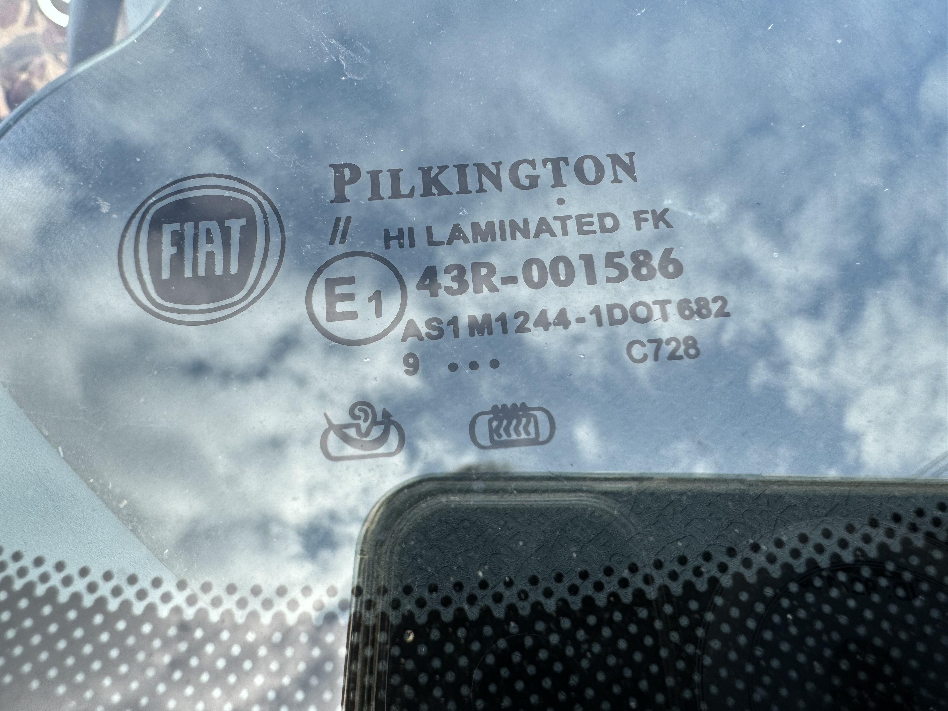

I've got a heated windscreen in my 2016 Panda Cross. You would know very quickly if it was working when steamed or frozen - easily within a minute. Plus if you were driving into bright sunshine then I think you would easily see the elements in the screen. So my question is - do you have a heated screen that doesn't work or has the windscreen been changed for a non-heated one...?
My thoughts exactly. Heated screens are expensive to replace and given the age of the car it’s quite possible the original has been replaced with a standard screen. Get up close to the screen and see if you can see vertical rows of fine filaments. If not, then you no longer have the full winter pack…

As to whether it’s the right or original glass… mine was replaced under Fiat’s three year warranty as it was faulty, so any date codes will be different. In fact mines been replaced a second time as it cracked during the summer. You can see the heating elements more clearly if you put a sheet of white paper behind the glass :) - very fine, wiggly wires thinner than a hair. Also, if heated it has this symbol on it… the bottom right one of a screen with wiggly arrows (photo of my screen)

That's really helpful. Here's a snap of mine confirming that I do have the right screen. (It's a two owner car with a decent history, so I would have been surprised if it hadn't.) So now I need to do a bit more experimenting based on the advice from you and others. Thanks very much!
