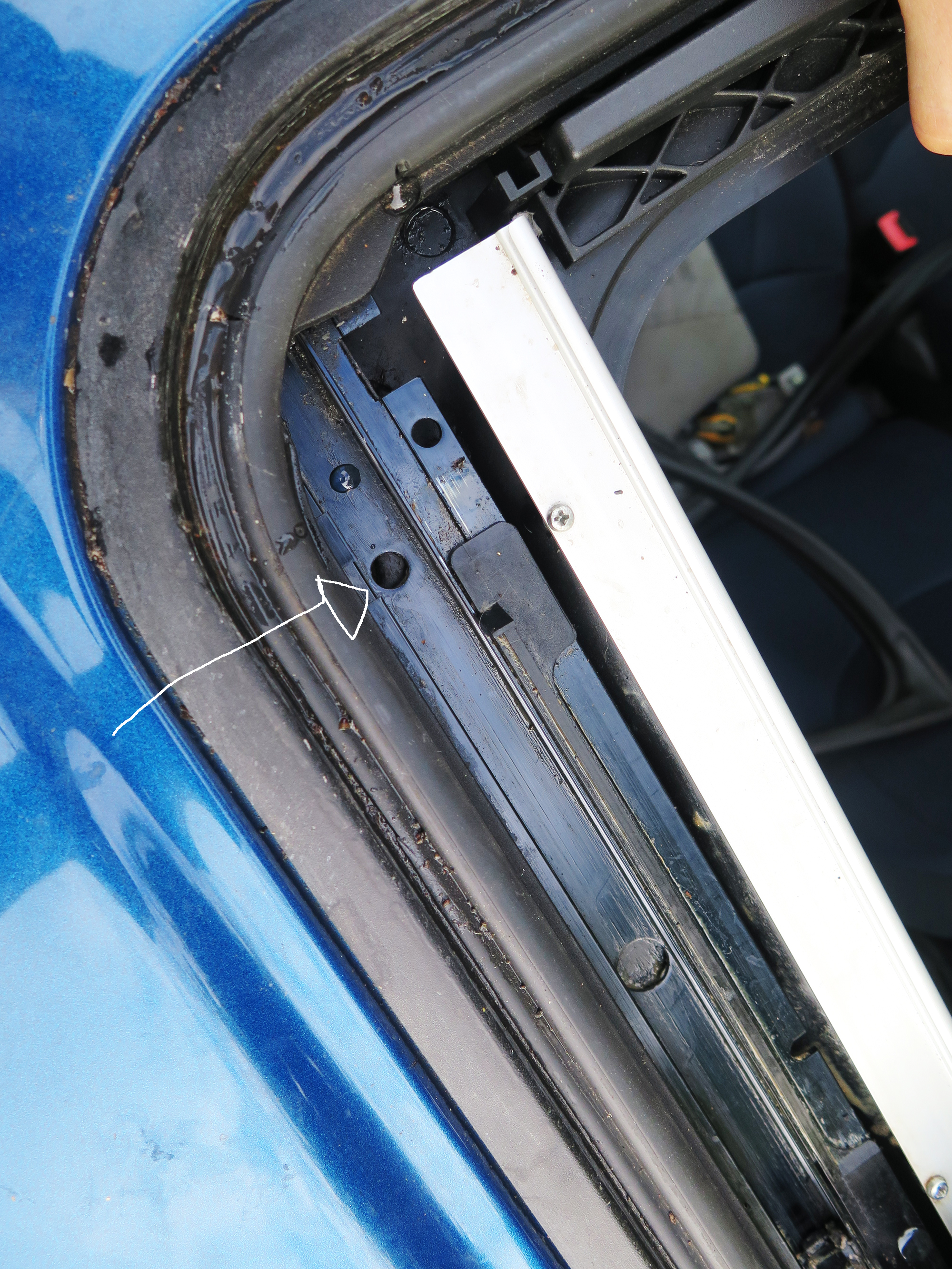

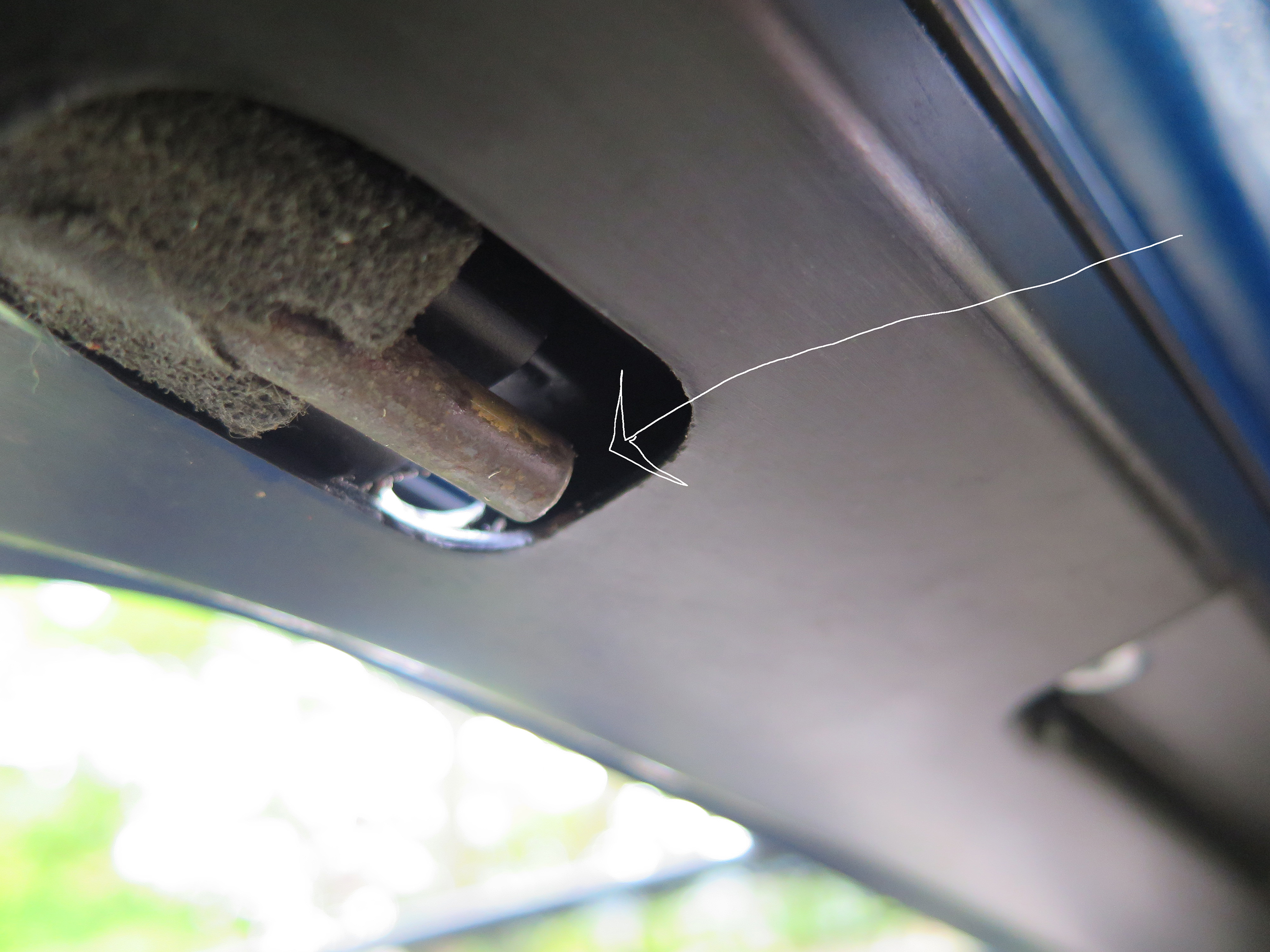

I've added two photo's to illustrate where we are at with it.
Essentially, there appears to be a metal pipe leading to what might be a water-exit point from the sunroof, but it looks as though it needs some kind of rubber grommet with a 90 degree angle to join the pipe to the hole in the sunroof.
Can anyone confirm this? Are we barking up the wrong tree, or peering down the wrong hole??

I think you are barking up the wrong tree. The Multipla sunroof installation is unusual in that it doesn't have any drainage gulleys or pipes. That is both a weakness and a strength:
A weakness in the sense that it relies entirely on the integrity of the seal between the soft rubber and the roof glass to keep water out of the car.
A strength in that there is no substantial 'tray' that most other sunroof assemblies would sit in on other cars, and no drainage pipes coming from it either. As they aren't there, they can't get blocked or rust out, which is the failing that befalls most other cars with sunroofs. It also gives a remarkably slim sunroof installation, which maximises headroom. Take a look at how little depth the sunroof takes up compared to other cars and you'll see what I mean.
I don't think the metal tube that's shown in your second photo is a drainage pipe. It's hard to tell the location of that picture within the car. Where is it? It could be one of the tubes through which run the cables that pull the sunroof open/closed. If that's so, someone insensitive has been there before you and the cable is no more. That's a bit of a problem! Does the sunroof open/close OK?

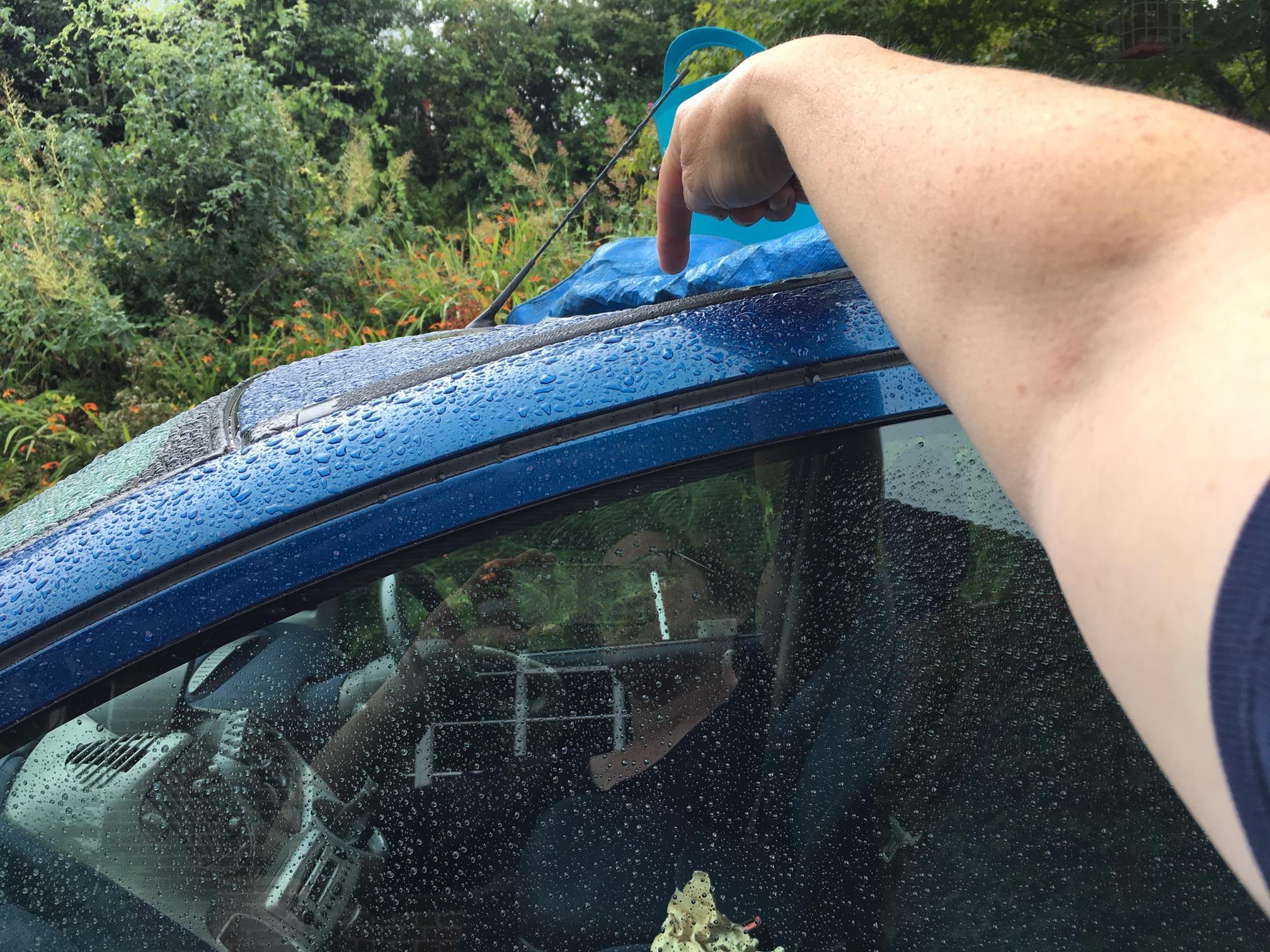

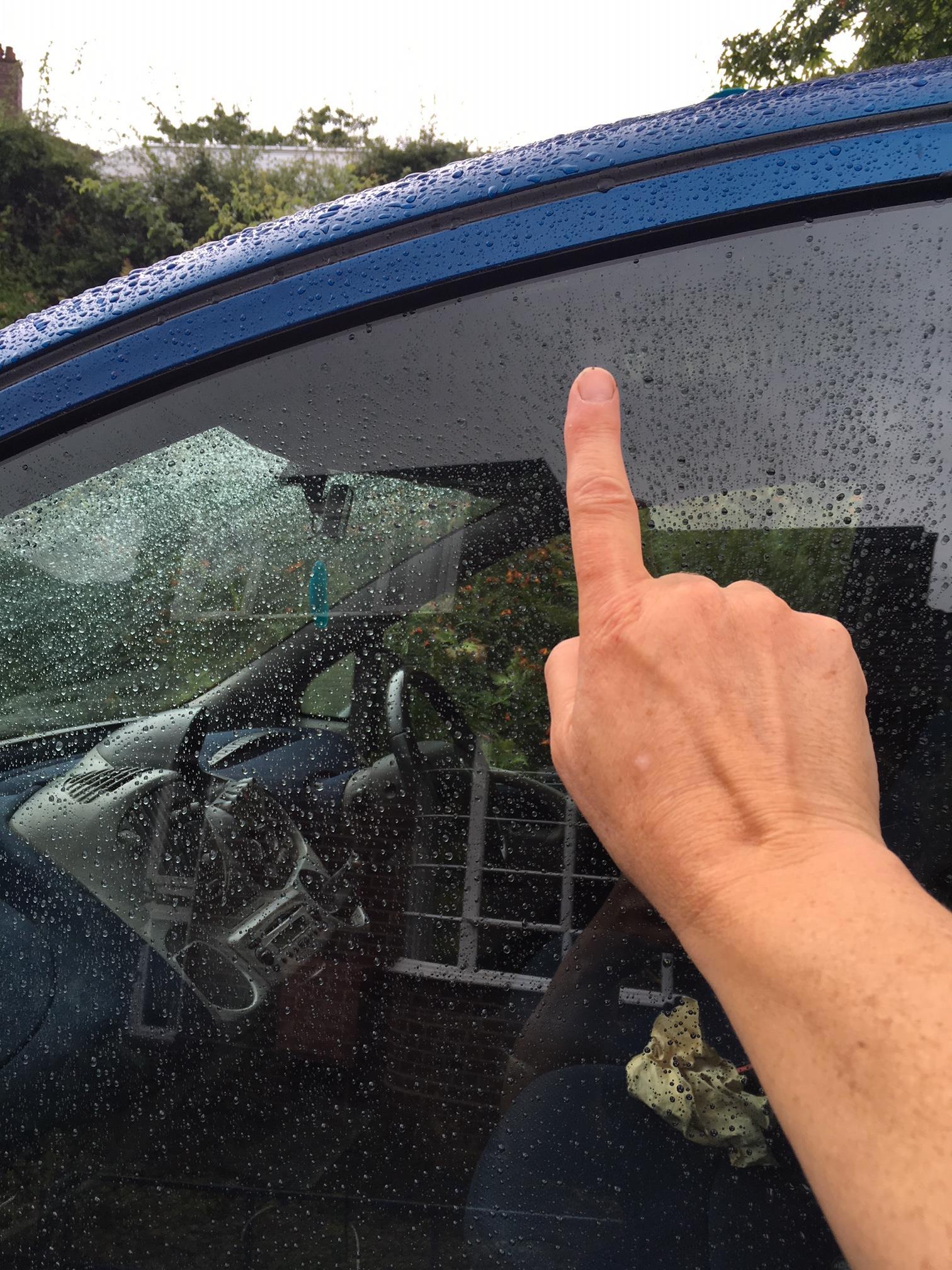

Regarding the position of the mystery pipe, I'll add two photo's showing me pointing to where it is - in the original post showing the photo of the pipe - the open end of the pipe is pointing towards the rear of the car, and it's directly below the circled hole in the sunroof which is why we thought it was the drainage… but I have to say, if it's not the drainage we are not sure what it is!!) Anyway, the photo's added today show where the pipe is from the exterior of the car. You have to pull the roof lining away a bit to see it.

The forum ePER is playing up atm, so I saved the attached from my laptop version, which shows what I think is the tube assembly in question (Item 14). I'm pretty sure it's the guide tube setup for the sunroof cables, so I'm not sure how/why yours is still working!

Hi Widemouthfrog, yes, I'd say it is item 14 on the diagram - I can't see what item 14 is supposed to be though, but yes that's the pipe we have!
