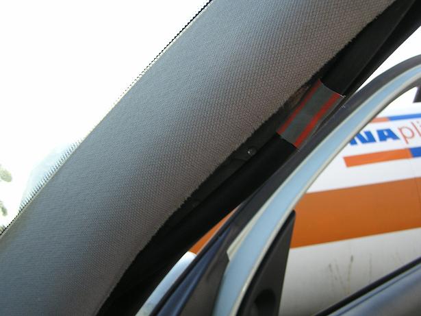

Normally, everything is very simply: The drain pipes pass through front studs on the front side, and through side trunk covers at the back side. That is black plastic pipe, around 15 mm, you must notice it. :eek:
On the front side, remove stud cover, very easy with fingers, it's on plastic holders (click). You don't need to remove it, just get enough space to pull plastic drain pipe from inside. Cut it, but not on the pipe holder place :nono:. Now you can clean pipes on booth sides with any tool, and strongly bleed with mouth. Finally it must be very easy blowing. Take a 5 cm (2 inches) peace of pipe for garden (1/2 inch), grease drain pipe and connect it. Put pipe back in plastic holders and put cover back by click.
On the back side, just open side covers in trunk, you will see black plastic pipe. Cut it, clean, bleed (use a peace of the same garden pipe to elongate), and connect back. :cool:
Simple? Very! 15 minutes maximum, less time then I spent cursing my greasing ideas. :doh:
Now I go finally to wash my car! :yum:
I made few pictures, if Argonought wants to add this guide on his, be my guest! (y)

It's front pillar trim left and right. I was looking in e-learn. Sorry about my English, it's difficult with this technical language. :D
Argo, I think you are right about scuttle area, it seems that the front drain pipes ends there, but I was not very interesting about that when I found middle of pipe.
Here are some pictures about that, it says more than words.
Yesterday I washed my car, finally! :cool:

Hi Muki, can you clarify what your last pic shows? I have a Multiwagon. Is this your boot area, or rear side trim panel? Thanks for the helpful posts :)
