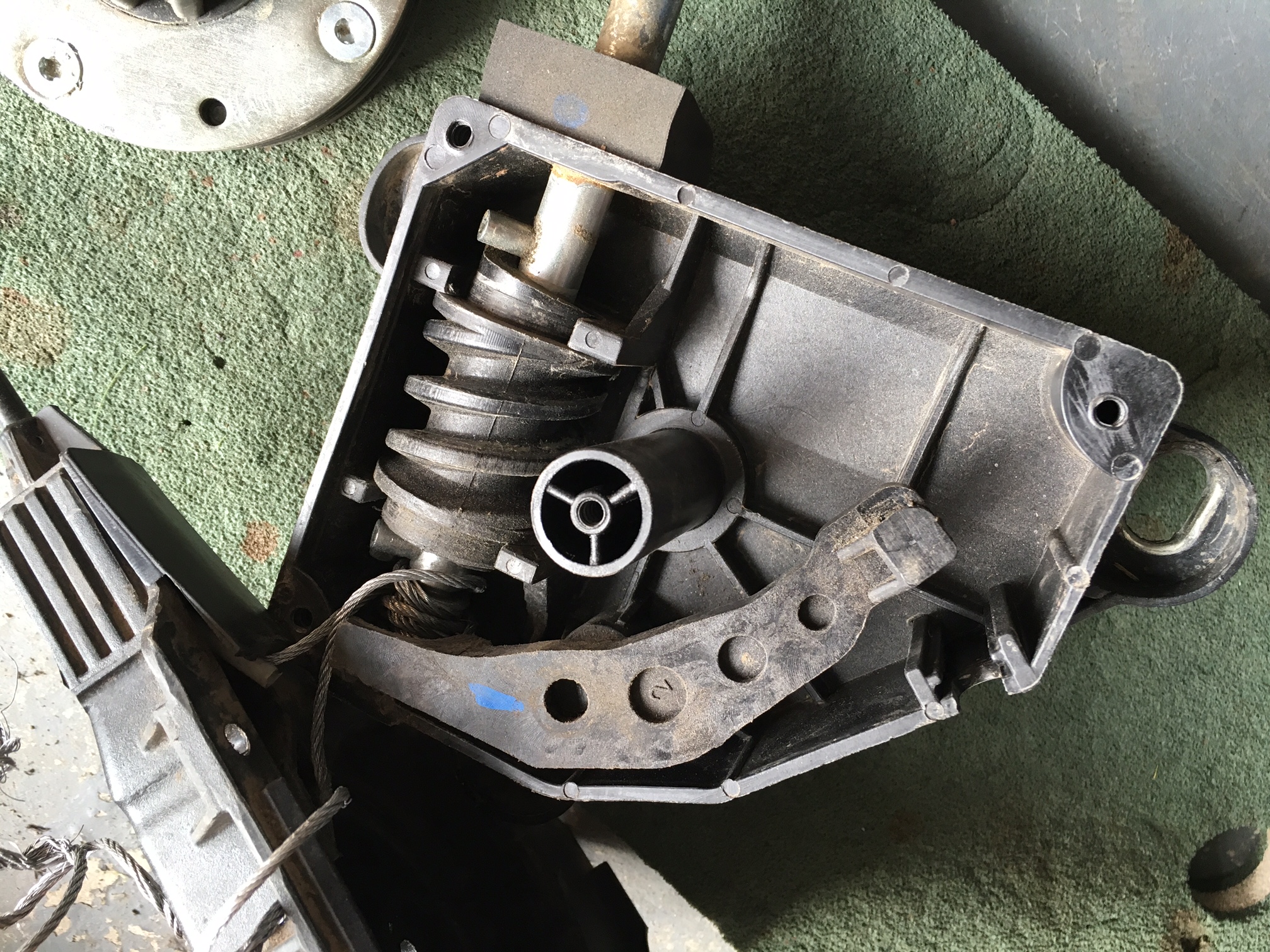

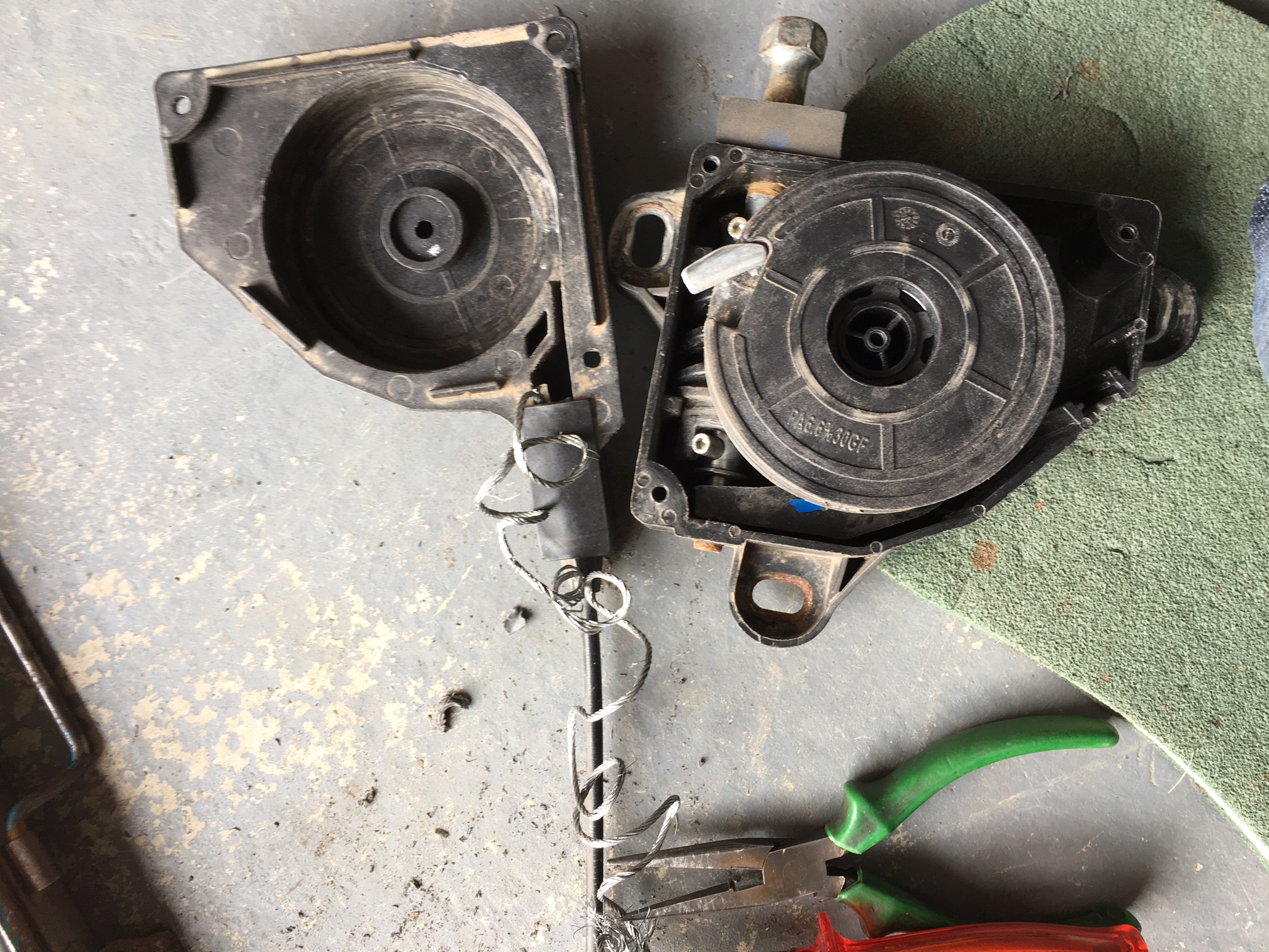

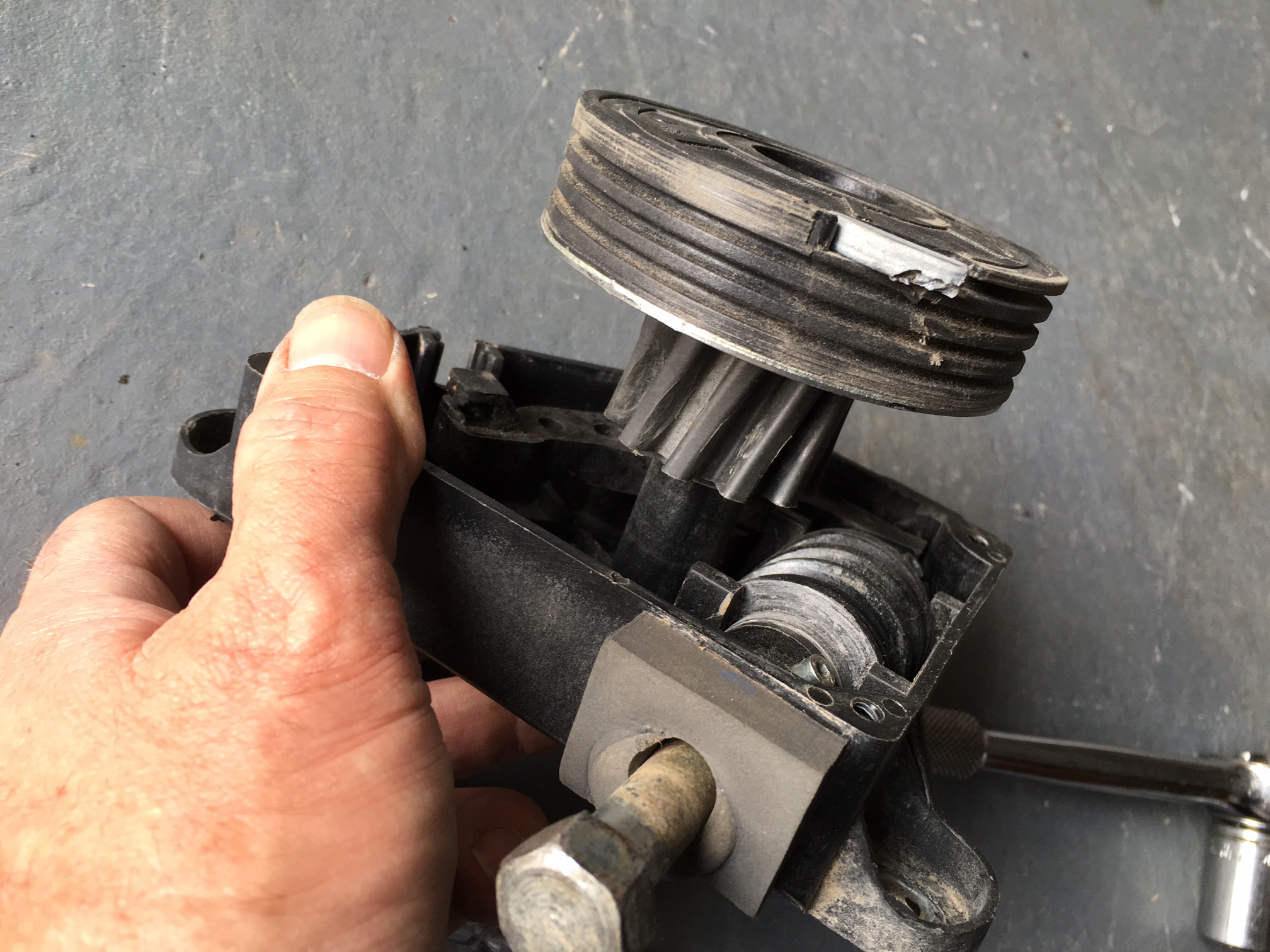

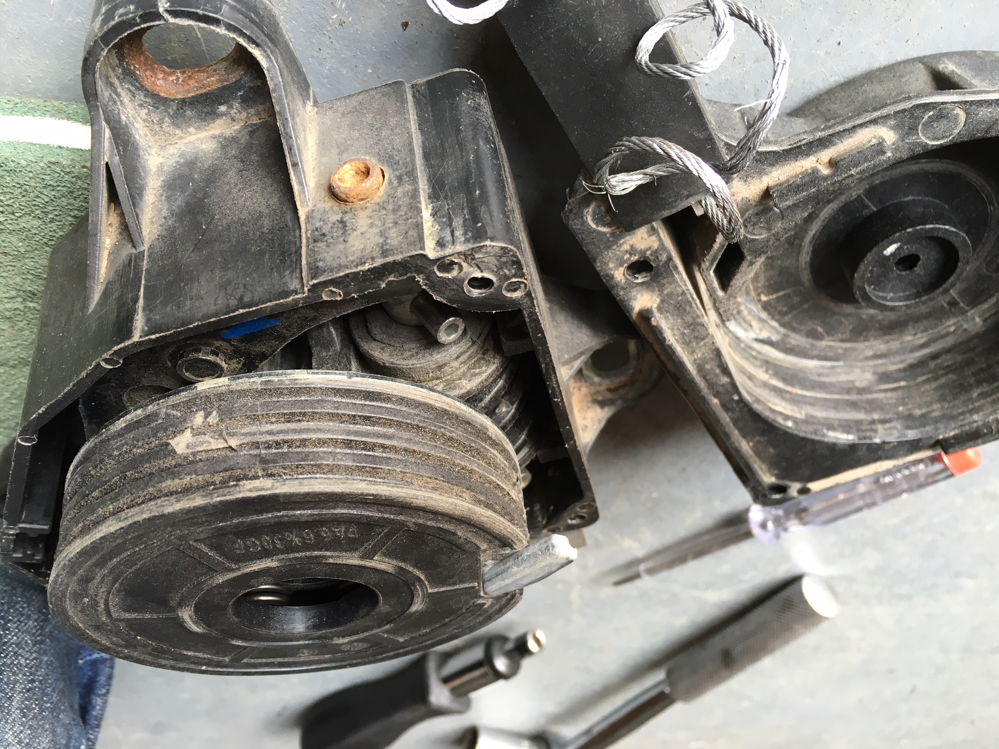

Pics attached just showing what's inside the winder mech in case you were interested!
Also shows the mess when it's been wound light (I imagine that's why it got tangled as you need resistance for the cable to stay entertained, going the right way - maybe you can hold tight to the
cable as you wind it in if you just want to park the wheel in the boot for getting a repair.)
It's fiendish stuff to unwind as the frays are very sharp..
