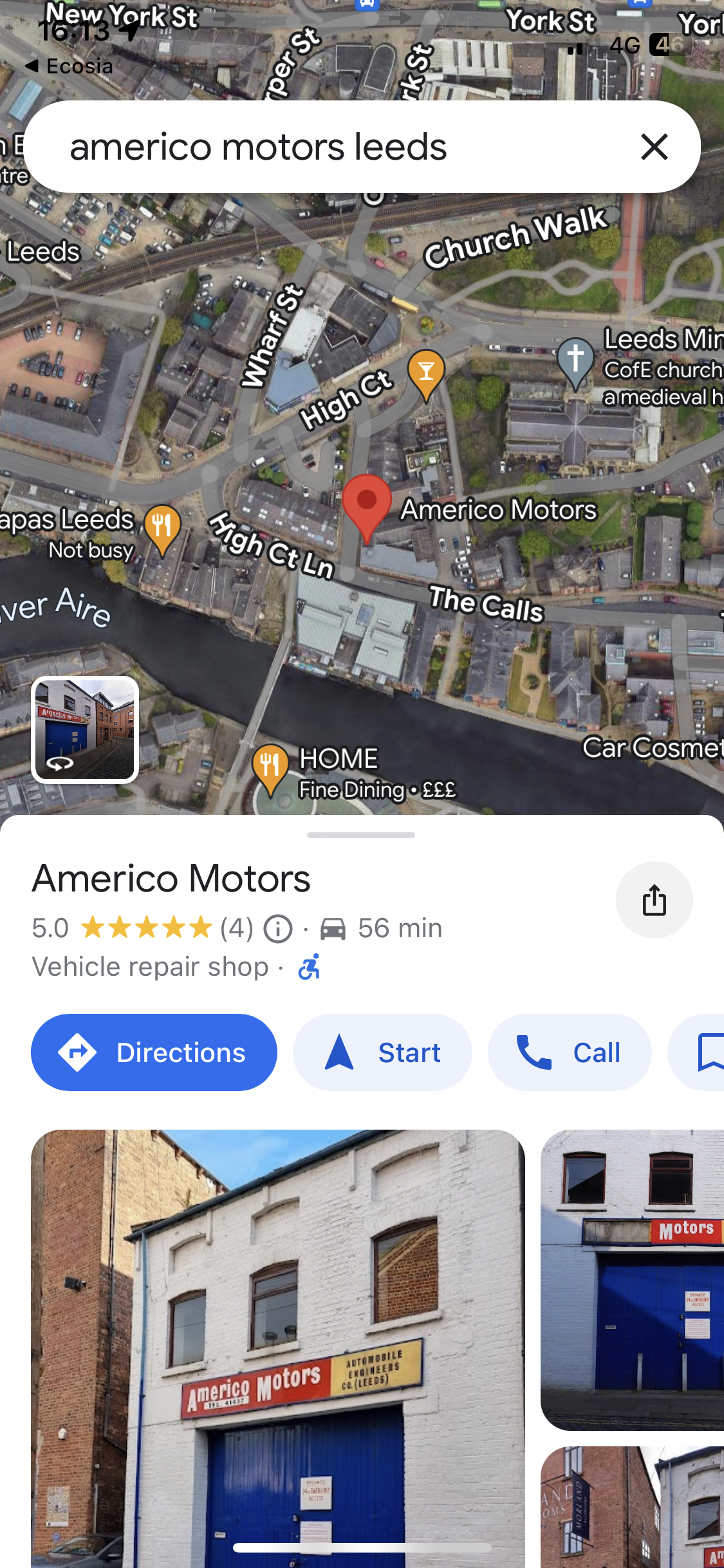

Leeds you say, so was it Fletchers as that’s a weird family (I worked their for a while). Or was it the independent one between Armley/Wortley, that was an even weirder family affair (they were actually quite knowledgeable and would also fit second hand/scrapper sourced parts)
She says they were Italian, in the centre but in a back street. Does that help?
Any interesting stories from your time?
Americo Motors, Italian ‘specialists’ that were also ‘infamous’ for sticking Porsche engines in beetles
I believe they’re still there
Many fine tales that I wouldn’t put into print!
