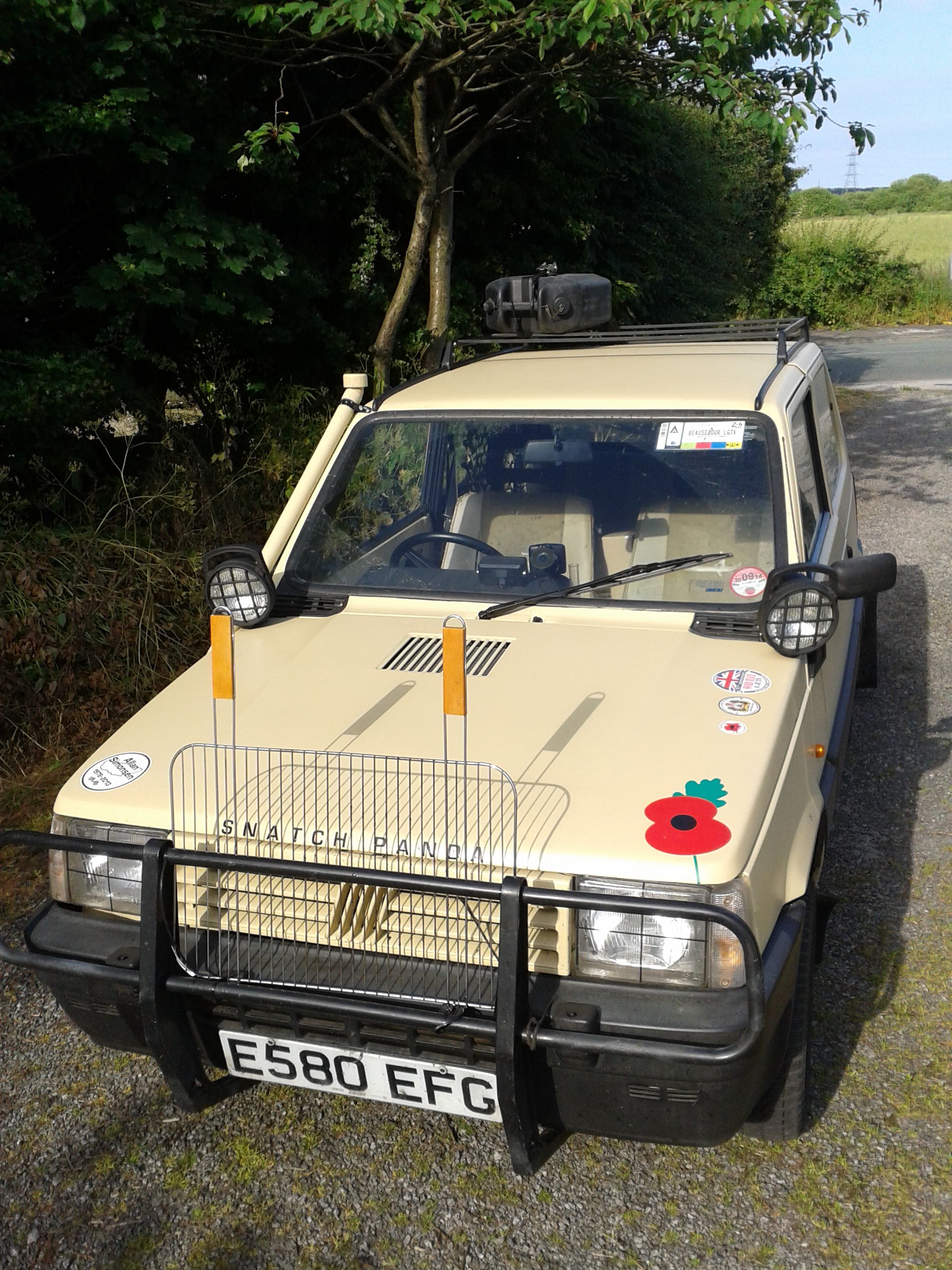

Inspired by Snatch Land Rovers deployed to Gulf War I, Afghanistan and previously in Northern Ireland, I wondered how the Panda version might have turned out..
Dragonman gave me a useful kick early on and David, Aquamarine has been wonderfully helpful throughout -thank you both.
Things got a bit loose with the interpretation as I got carried away - so the mudflaps aren't necessary (but I like how rally cars look) and the bonnet lamps are because of a soft spot for the Matra Rancho. - Please be reassured that only a rusty bonnet was harmed in the making of this modification.
Similarly - all the changes can be undone fairly easily if Sisley prices continue to head for the stratosphere.. So I didn't paint the grill and I have kept a good unmodified bullbar to one side.
Hope you like it. Let me know what you think.

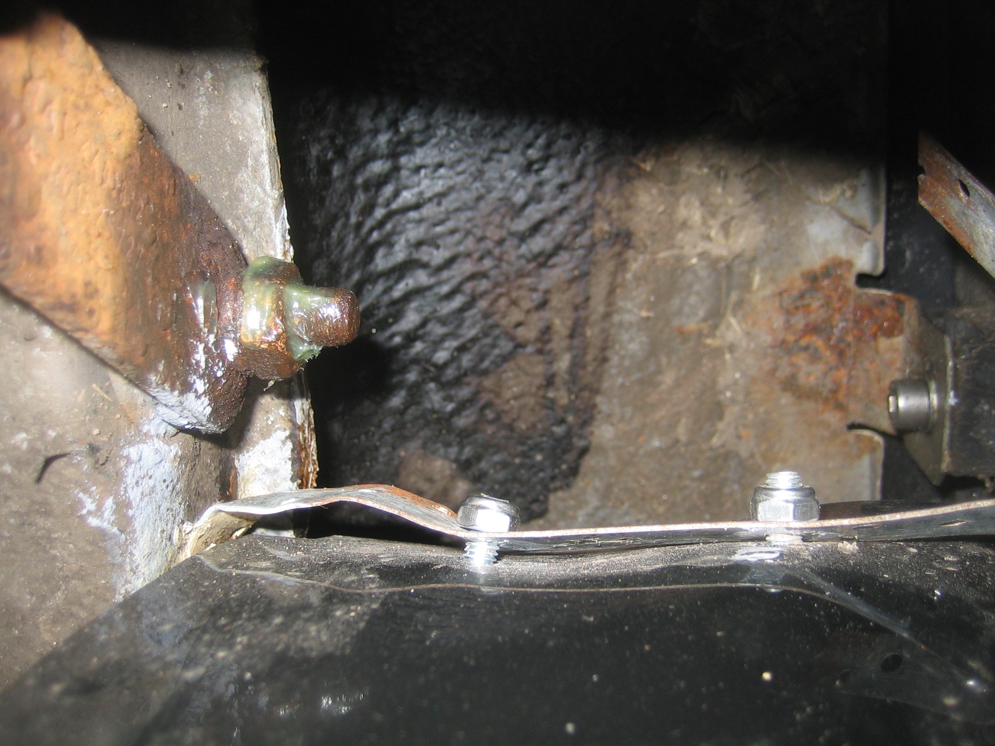

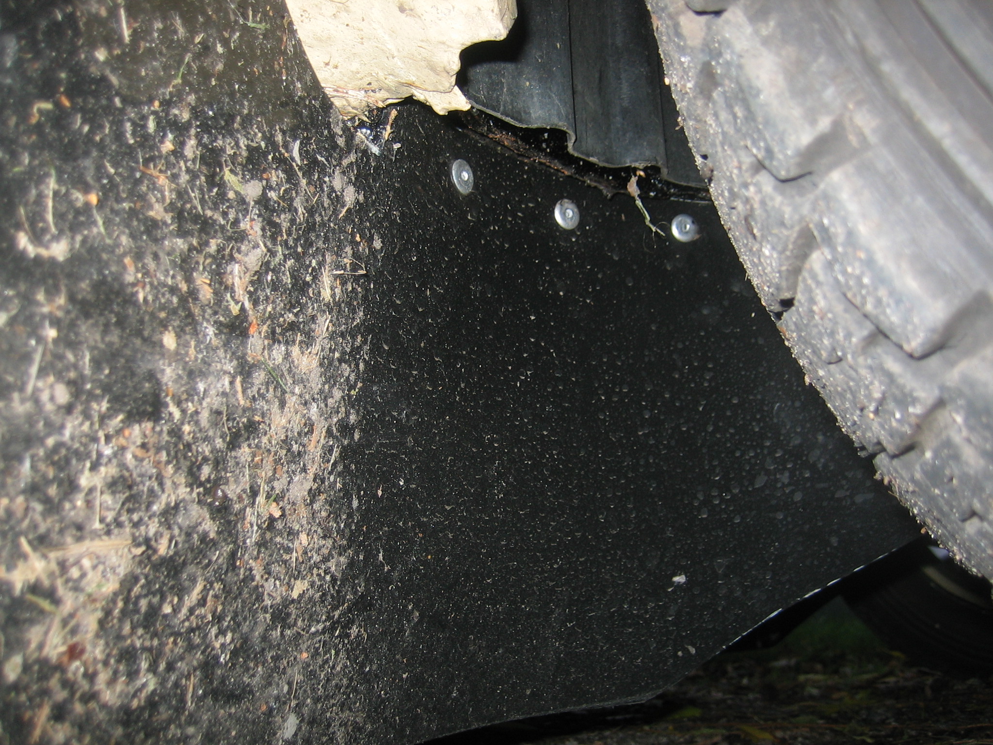

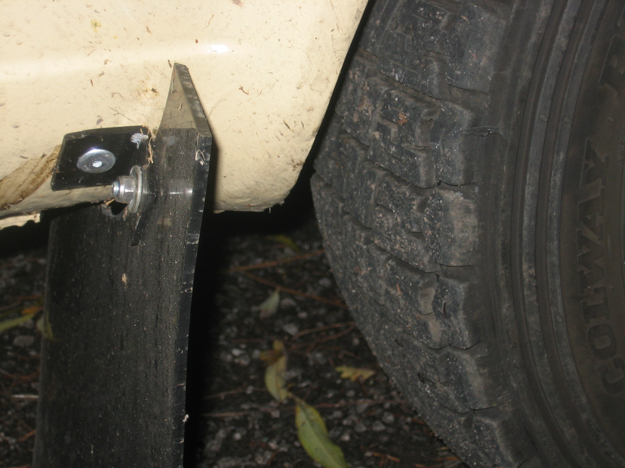

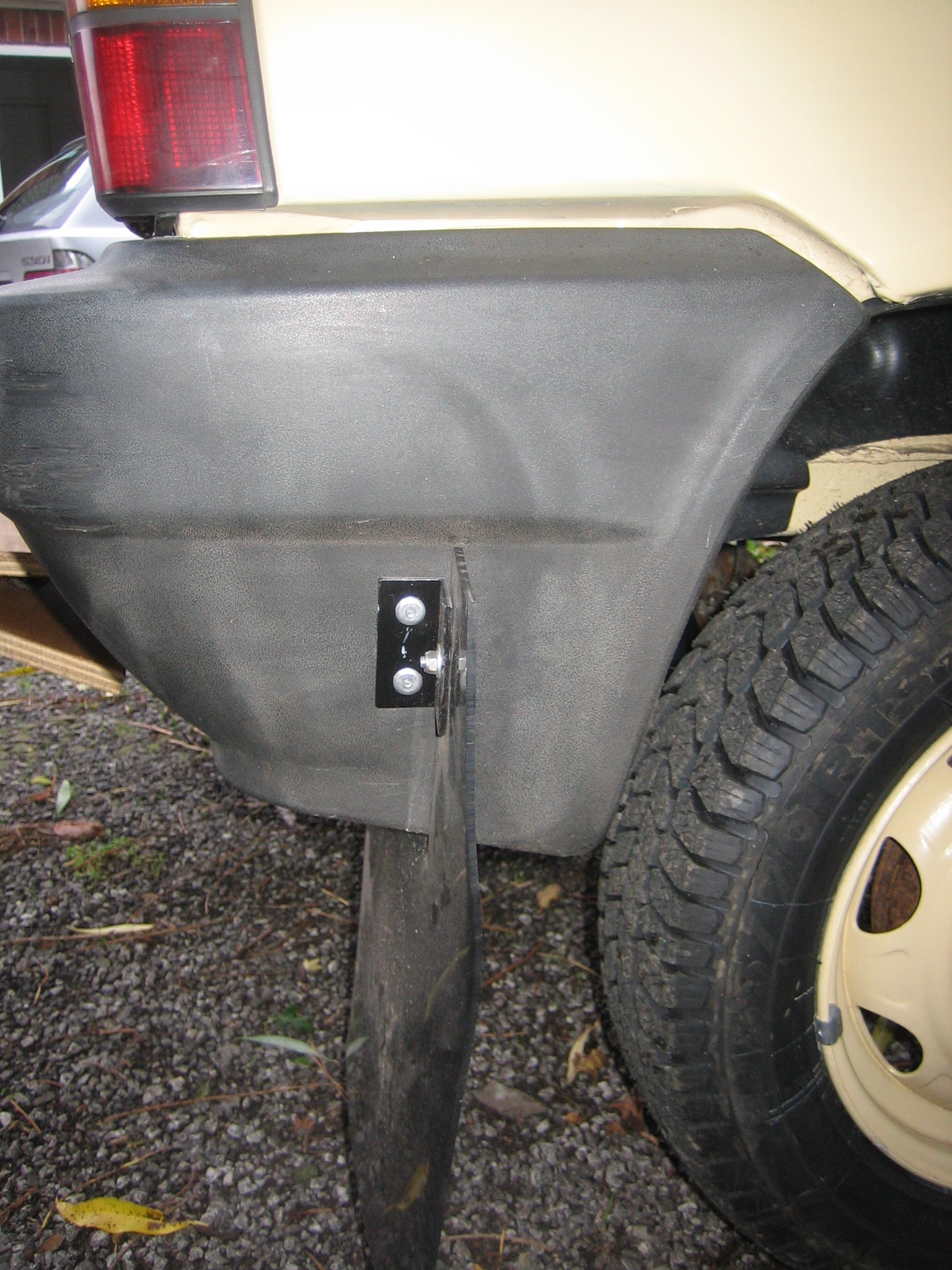

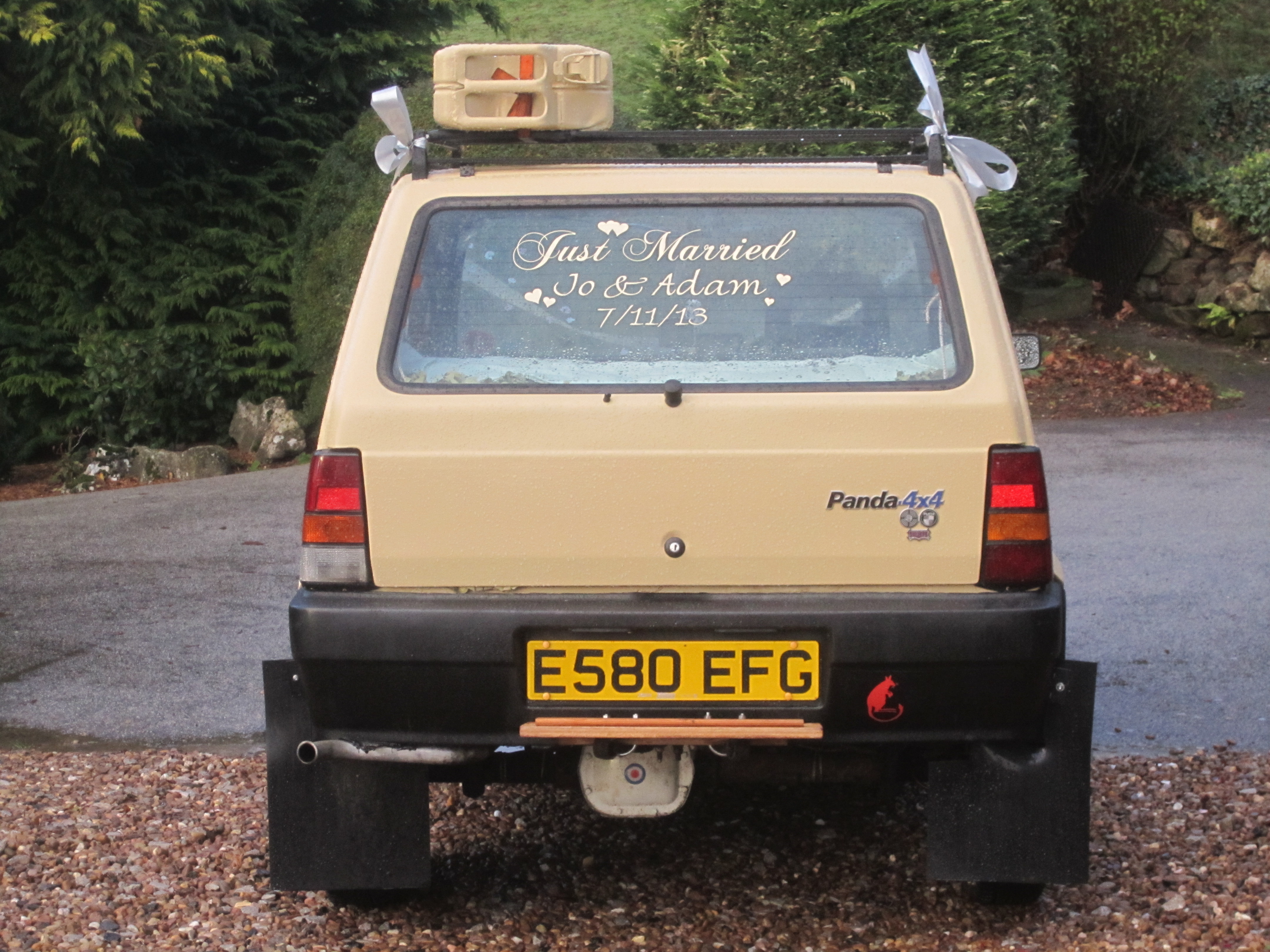

Mud flap fixing pics as AndyPanda4x4 asked for.
The outside bumber and cill brackets are obviously just aluminium angle.
The second pic is looking up into the void behind the rear bumber. - Thin strip of galvanised steel bent to bridge between the rivet on the bumber and the box section on the chassis.
You can see it's already bent from me trapping the flap between tyre and a kerb, giving it a tweak. - It's worth building in a weakest point I'd say, to stop the flap being destroyed or doing bumper damage when incidents like that inevitably happen. Maybe thin cable ties instead of bolts for me in future.
Front was another nail chewer - I don't like putting holes into car's where there weren't any originaly but.. the mudflap now sits up nicely behind the arch liner and the rivets go into the front jacking point box which is holed already so..:eek: It isn't perpendicular to the car but sweeps in a nice forward curve following the turned wheel's arc. Ahem. ;)
Hope this helps.

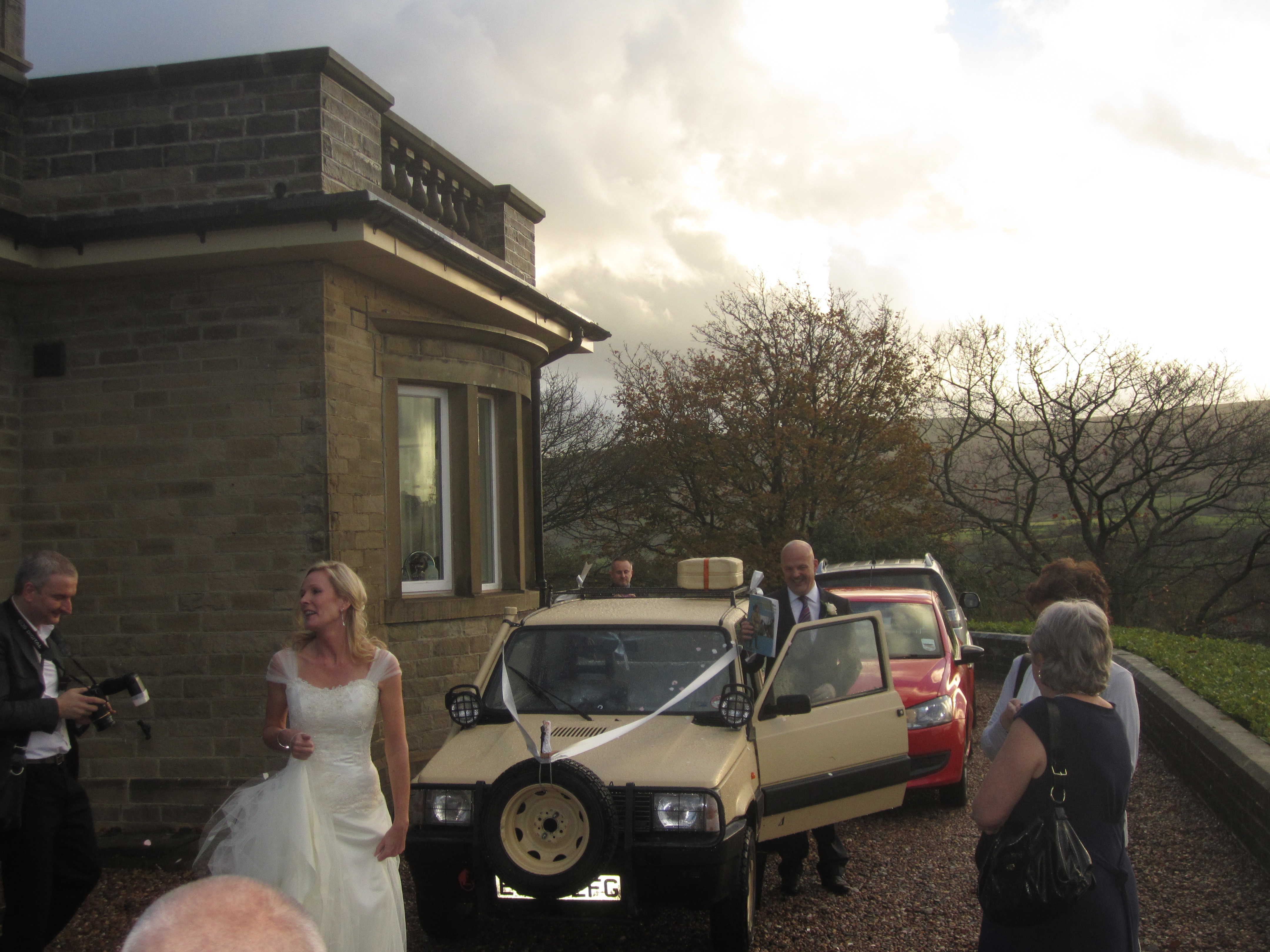

The bride smiled, thank goodness, and most of the guests laughed and looked a little confused. - So a perfect result I'd say.
A navigational error en route to the ceremony meant a three point turn in a minor Yorkshire lane. A second driver error put the two front wheels onto wet grass that was too slippery to reverse off leaving us staring into a ditch.. with 10 minutes to go before the ceremony was due to begin.
Engaging 4 wheel drive popped us cleanly back up onto the road, fortunately. But made me very thankful for what we were driving. If I never need that prop shaft and axle again, I will gladly drag them around for years, knowing the disaster they averted yesterday.
Phew.
Apart from that it was drama free.
Oh, and the windscreen wiper fell off. And we broke down on the way to the reception. And the exhaust's melted the bumper. And I can smell coolant with the heater on. And the headlamp switch is only working intermitantly..

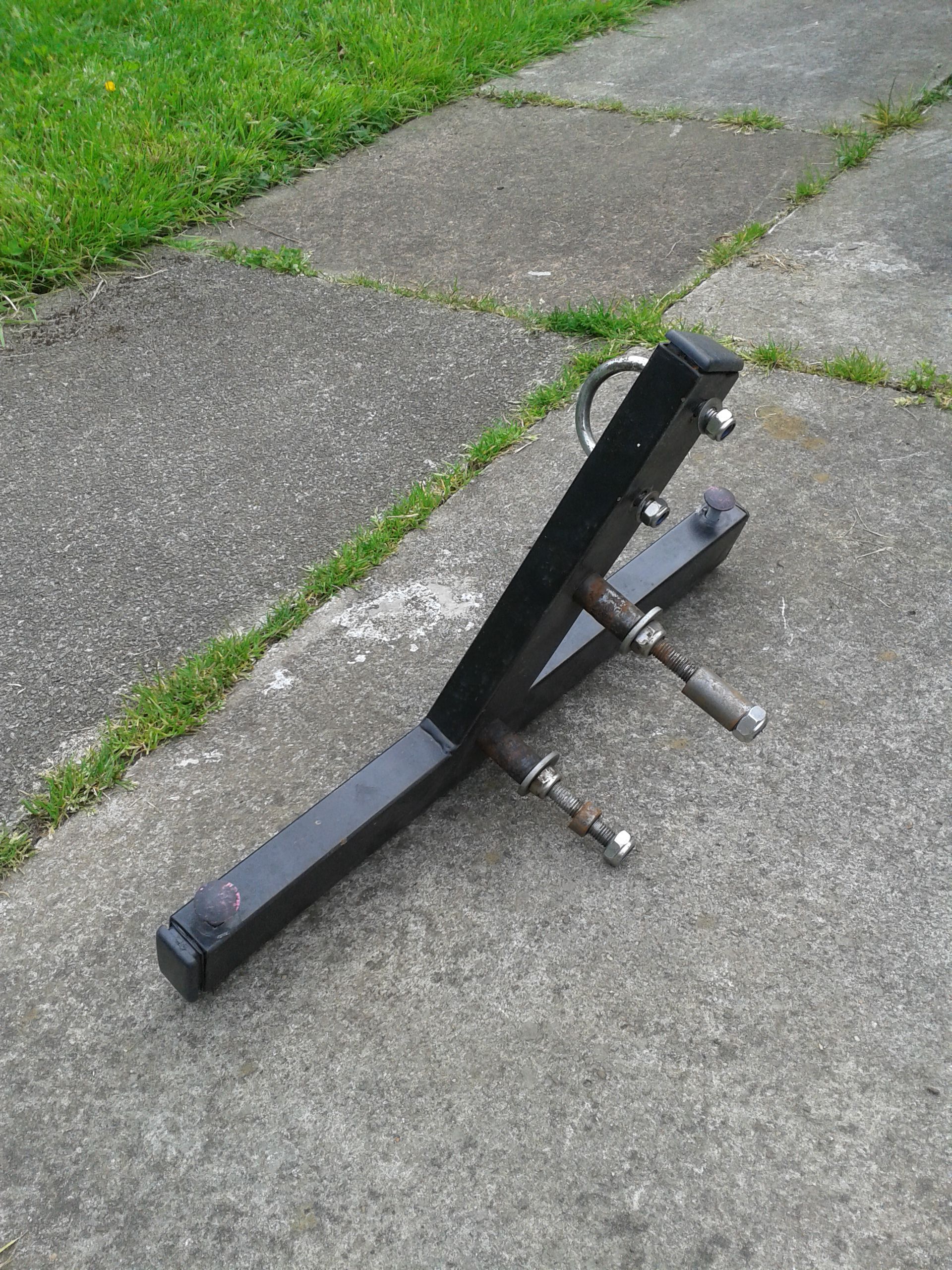

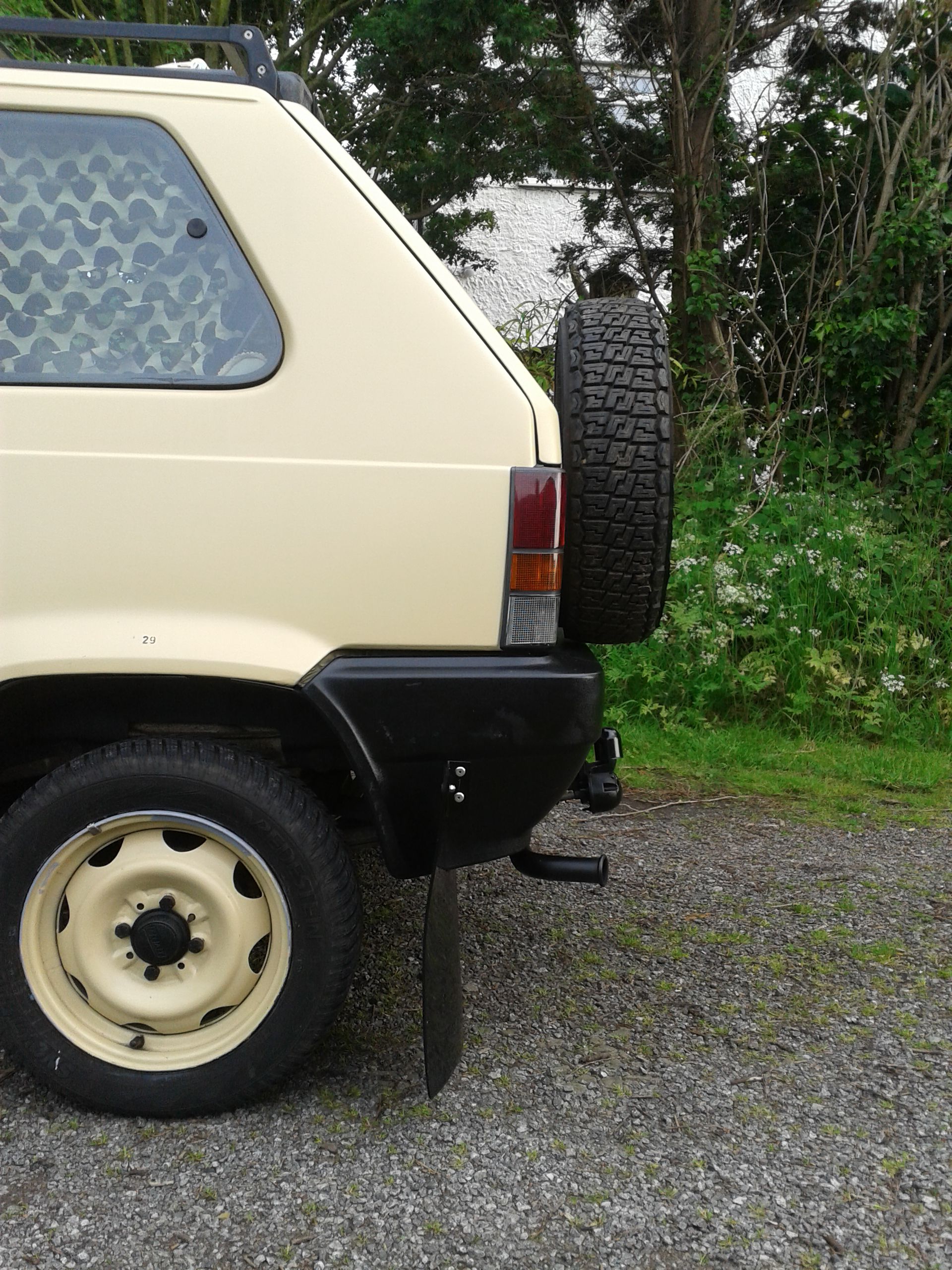

AndyPanda4x4 was right.
Mounting the spare wheel on the front made seeing track details more difficult and the cooling fan work harder at low speeds. So I did this:
(Please excuse the random orientation, I can't get my gallery edits to stick.)
Which means that the original front mount bracket is up for grabs.. This bolts to the spot lamp brackets on the standard roobar with no modifications necessary.
If anyone can use this, let me know.
Panda Express, collection from Liverpool or for postage at cost please.
