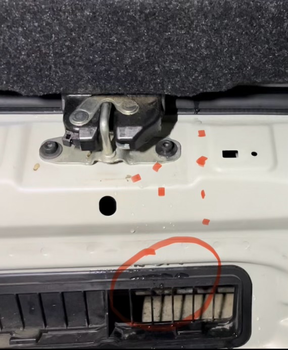

The next step was to remove the boot lining and keep pouring buckets of water over the car. Collect the water in a tank and recycle. After a while (I mean 5 to 10 buckets) drops appeared around the lock area and back right side. See red circles and dots representing the drops on photos.

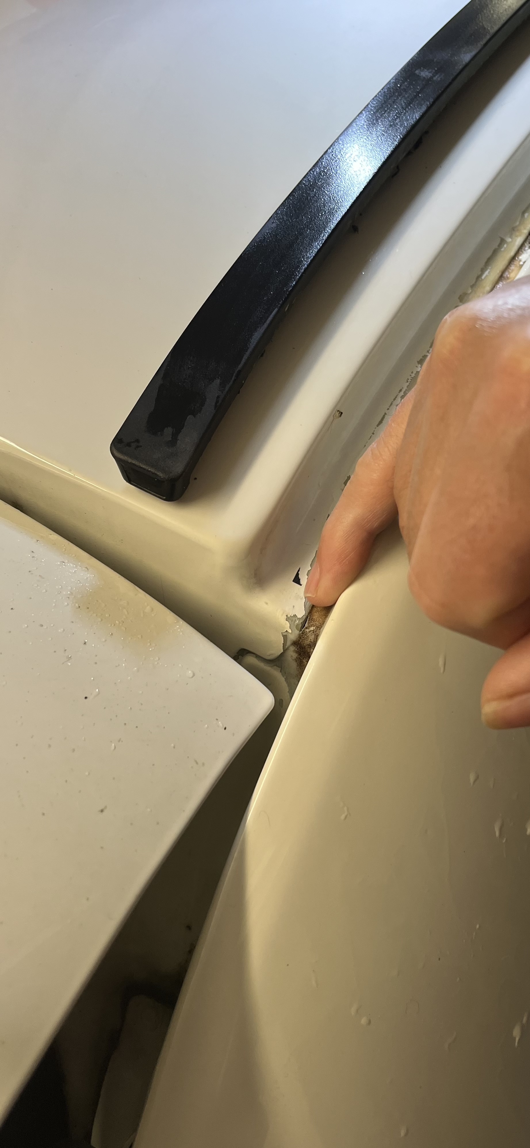

For the right side leak, where to start ? Lights, window, roof .... Just pour buckets of water and hope to see a drop (see video). Eventually you will find the suspect area, in my case the seal under the roof trim (see photo, I used flowable silicon to seal it up).
