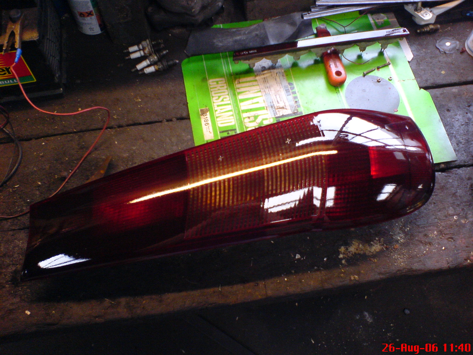

PuntoKing said:
yeh mine were all white so i used paint thinners and took it all off... now im trying to do it again and that happened... they used to look like this
[img=http://img89.imageshack.us/img89/2103/dsc00356pa1.th.jpg]
another question... I lost the screw thing that is used to hold the lights on any ideas what I can do untill I find one to buy?
Yeh bang a big enuf washer over it and wang a nut over the end
Jordan
and yes i took the lights off to spray them... its wierd isnt it.. it only came up after the second coat.. i did a light coat 1st and they were fine and then after my 2nd coat that happened
