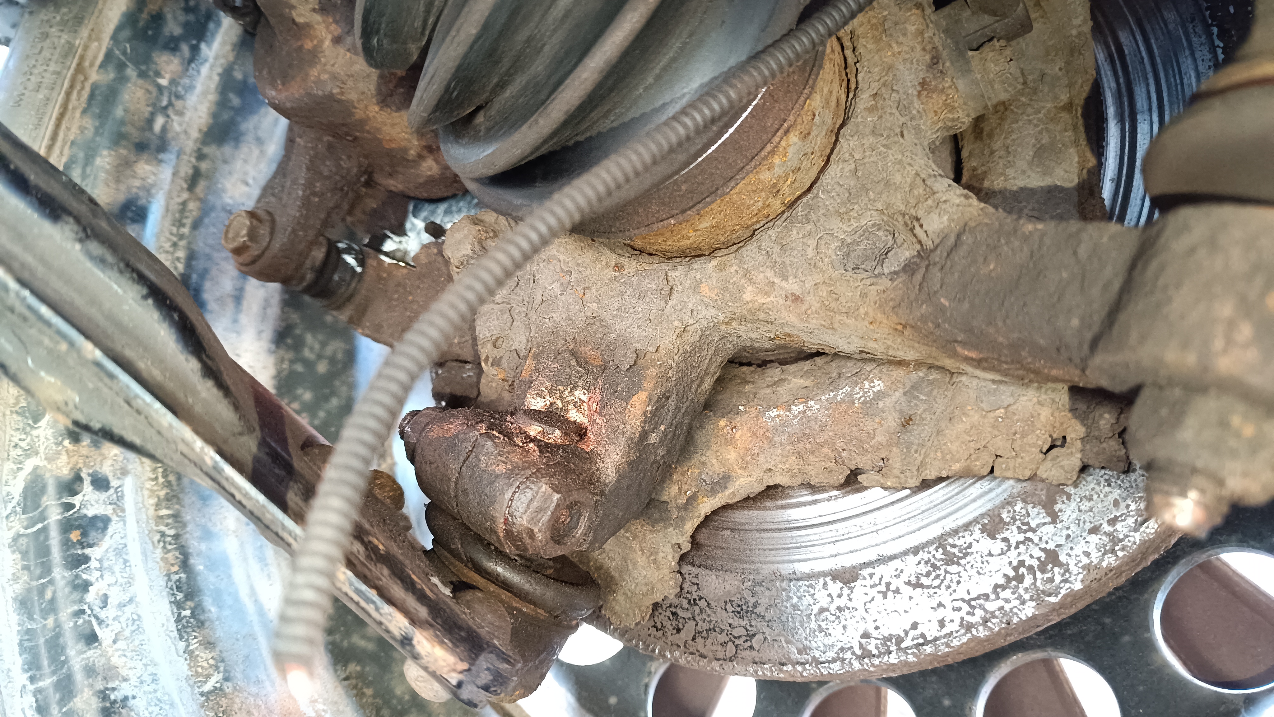

I cleaned the clips and bracket, I had a lot of trouble getting the pads back in, previously they might not have been flush to the disc. I then drove the car and the discs seem to have been scratched flatter. These are some before and after pictures of the disc.

Looking at the second photo I'd say some serious derusting is required. I'd sand blast it...
And for the disc, it needs at least some work on a lathe, or any other improvised treatment to make the surface totally rust free, clean and FLAT!
I might take it off and sand it. I realise its not optimal...at least i've found the problem and don't need to buy new calipers.
